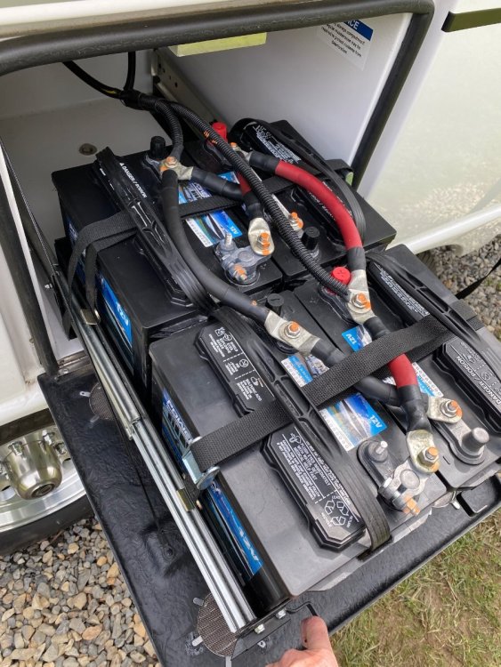

Sure enough - I got 4 of them similar to Frank C.
Mine are the original Trojan T-105's that Oliver was offering 7 years ago.  I purchased the optional "watering system" that makes getting water into these very easy.  I've been fairly religious in checking these and giving them water at least every 60 days.  I know that I'm living on borrowed time with these but as long as they continue to function properly I'll hang with them.
