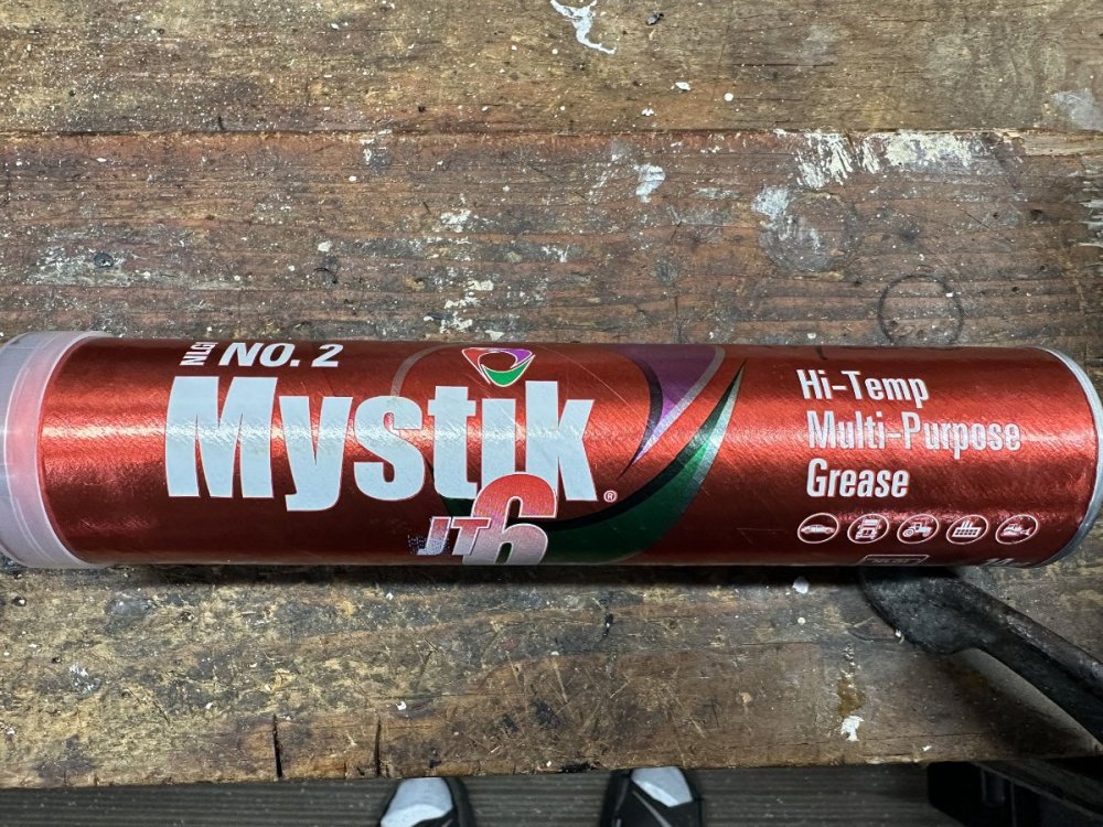

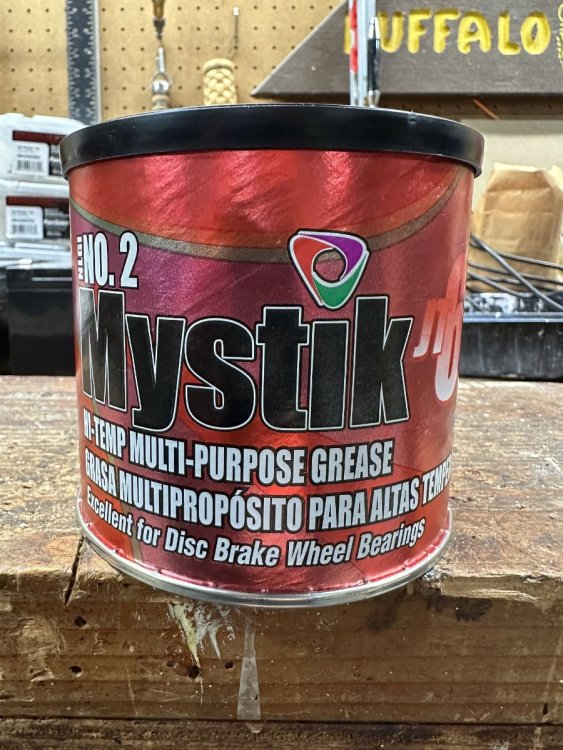

Lucas Red & Tacky is a good choice. I've been using the similar Mystik JT6 NGLI #2 Hi-Temp grease for trailer wheel bearings (Lithium Complex, non-Moly), spring shackles and tow vehicle lube points for quite some time now. Works well, is affordable and easy to find.
