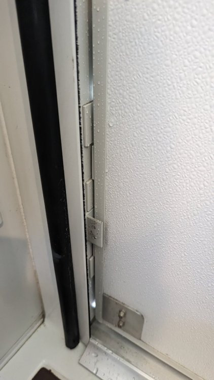

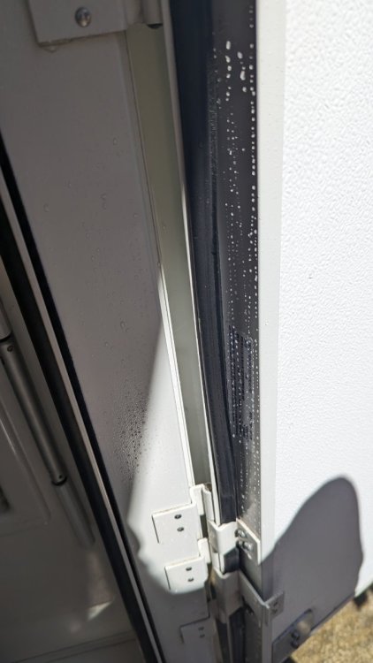

The main walk-in door is, and likely has been, my big leaky issue this hold time, not the window on the door.  The window is good now for sure since I re-sealed it.  Now to tackle the real issue.  Here's some picks of the leaks.  I had someone spray water outside while I looked inside, without the screen door attached (pain to remove).
Screen Door Removal
The screen door was kind of a pain to get off.  Those Roberson square head screws were in TIGHT and with a tough angle at which to get to them, with the main door in the way a bit.  I need to get new screws now since two of the heads were a bit damaged getting them out of the screen door mount. Not sure if Phillips screws would do any better and not sure I could find machine torque screws in that form-factor & length.

The way the current strip is placed on the door, at least as it sits on the side of the hinges, it's a horrible placement, I think. It gets "pushed" out of the way unlike all other sides of the door. Maybe I can simply augment that seal with one that's on the core of the door itself and not just on the outer overlap of the door.  Not sure that's too clear.  Maybe these picks will help?  But, that will certainly affect how the door closest.  It would have to be a very thin seal for sure.
Basically from top to bottom on the hinge side the door leaks.  I've head to keep the canopy extended more than I'd like to so I'm not cleaning up puddles of water after rainstorms.  I'm trying to get & keep #110 in perfect order, especially before the rally in May.  🙂

I found out tonight that the door is leaking between the door frame and the hull. The entire door and frame needs to be pulled and resealed. Not looking forward to it.

I just called Oliver. They just use the grey Butyl Tape on the walk-in doors, so I'm good.  They did say I'll need to go thru Lippart for a new door seal.  I think that's another spot that can be a problem, although for now I have augmented it with another small, "double-tubed", seal on the hinge side of the inner frame.  It works so well I don't see any more light shining through now.  It's only a temporary stop-gap to get me through to the Rally in May, unless I get the seal before then.
