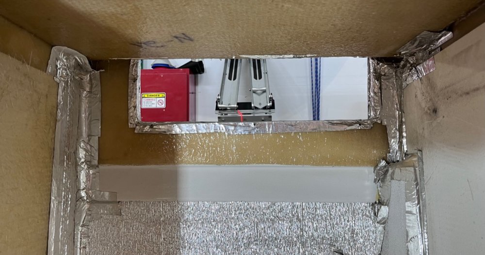

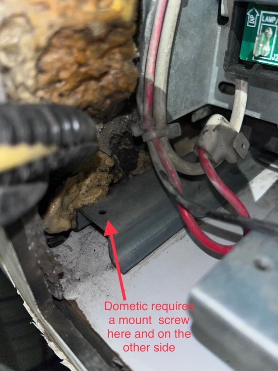

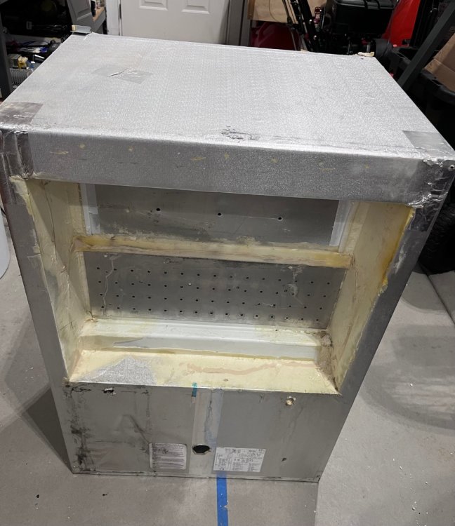

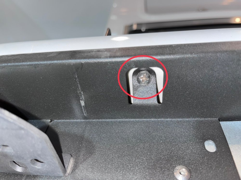

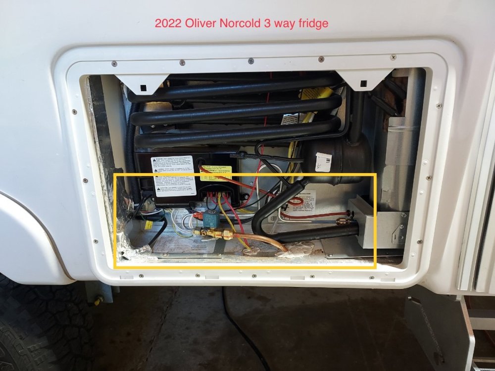

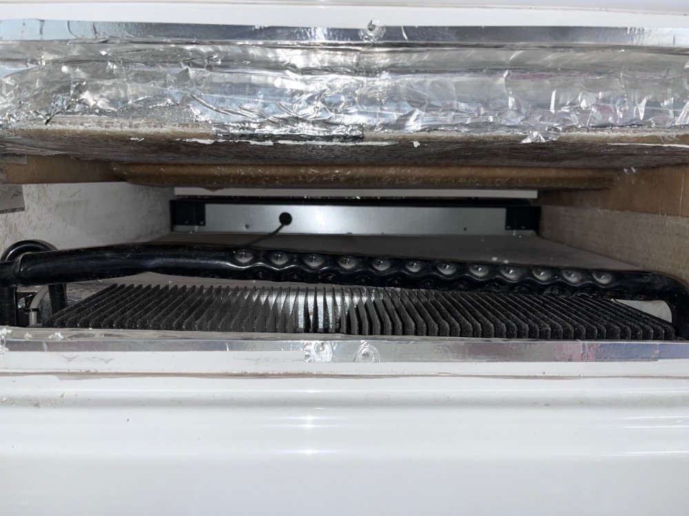

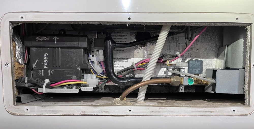

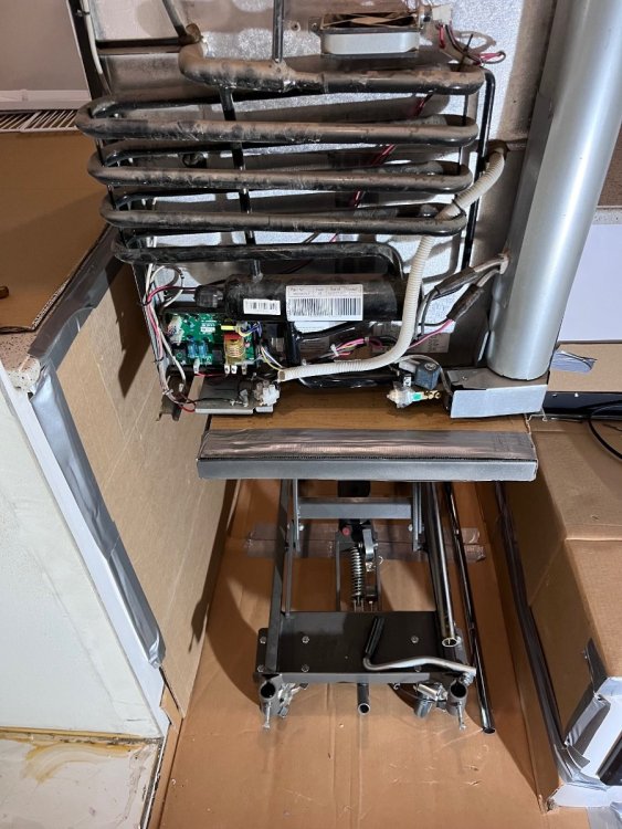

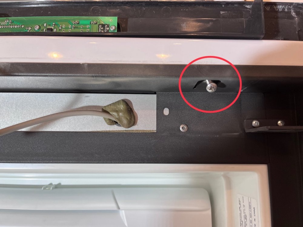

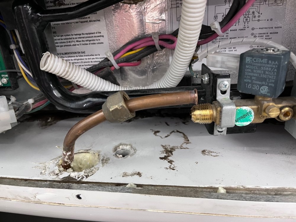

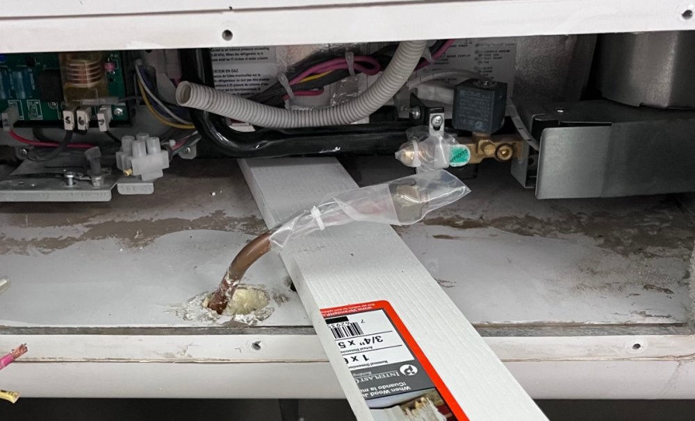

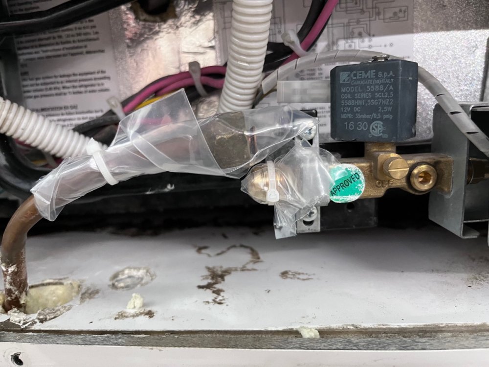

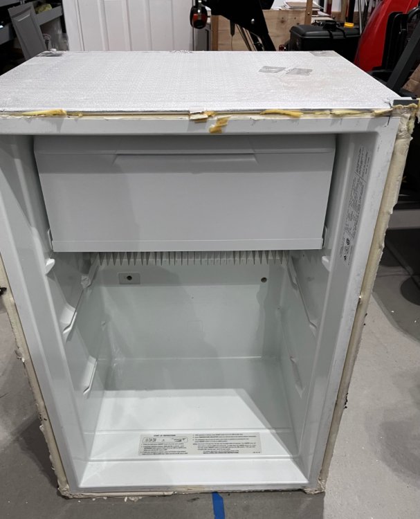

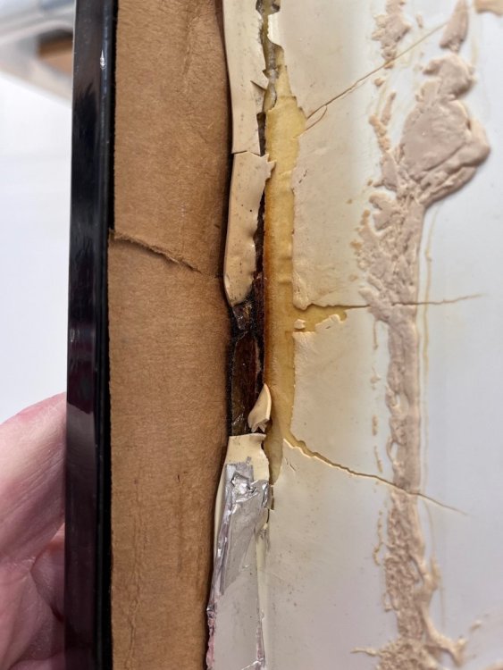

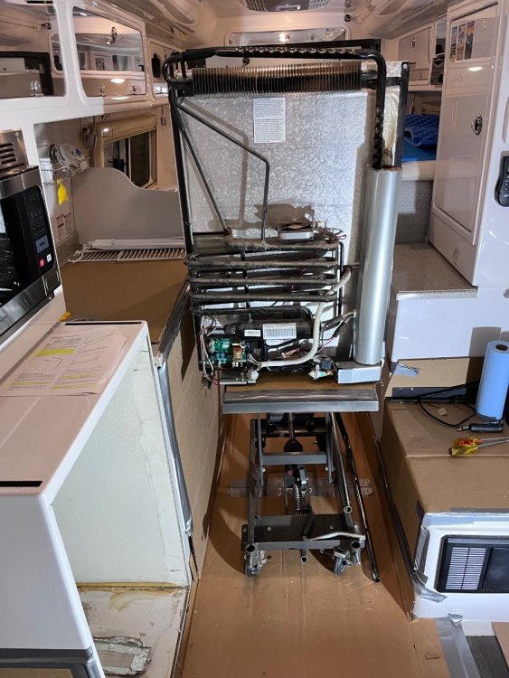

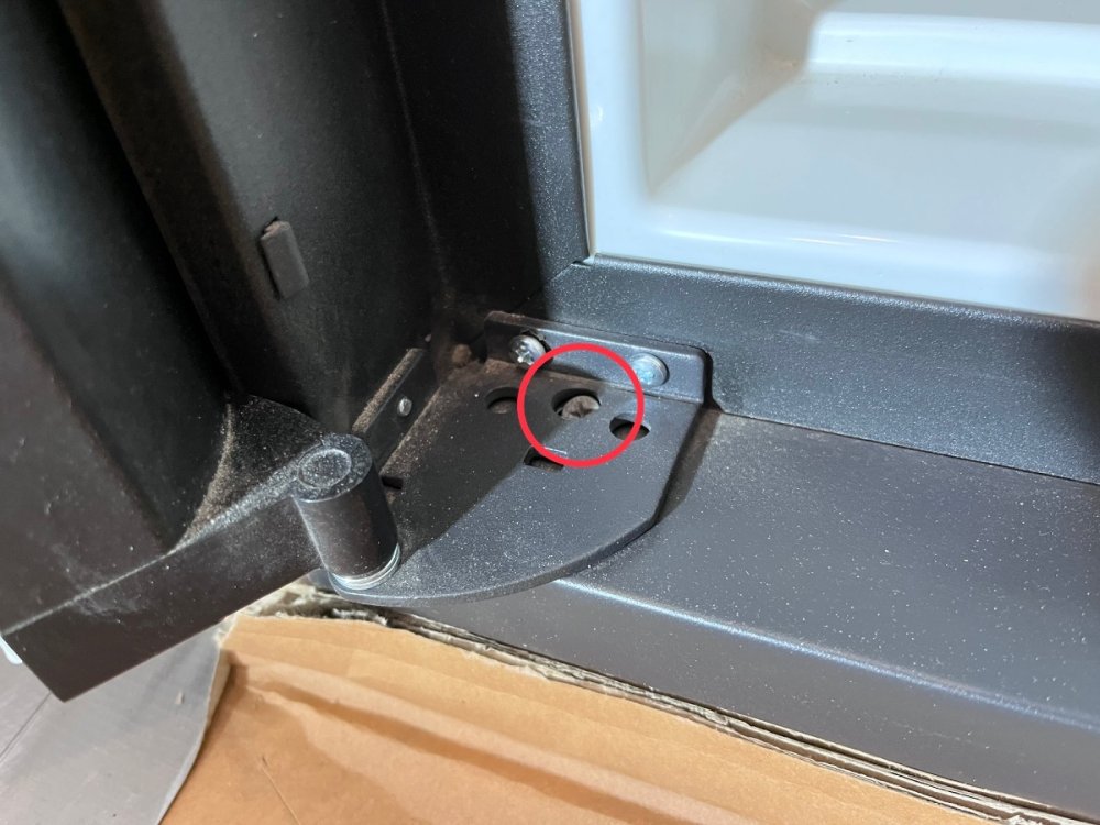

John E Davies Posted April 9, 2023 Posted April 9, 2023 No commentary, pics for your enjoyment. Please look as these related threads: https://olivertraveltrailers.com/forums/topic/8865-fridge-fires-if-you-have-an-older-hull-you-really-need-to-pull-out-that-fridge-now/ https://olivertraveltrailers.com/forums/topic/8832-removed-my-dometic-3-way-fridge-without-removing-the-cabin-door-assembly/ https://olivertraveltrailers.com/forums/topic/8827-thread-for-isotherm-cruise-130-elegance-2-way-compressor-fridge-the-unit-used-in-2023-models/ John Davies Spokane WA 2 SOLD 07/23 "Mouse": 2017 Legacy Elite II Two Beds, Hull Number 218, See my HOW TO threads: Tow Vehicle: 2013 Land Cruiser 200, 32” LT tires, airbags, Safari snorkel, Maggiolina Grand Tour 360 Carbon RTT.
John E Davies Posted April 9, 2023 Author Posted April 9, 2023 Pics ... John Davies Spokane WA 1 1 SOLD 07/23 "Mouse": 2017 Legacy Elite II Two Beds, Hull Number 218, See my HOW TO threads: Tow Vehicle: 2013 Land Cruiser 200, 32” LT tires, airbags, Safari snorkel, Maggiolina Grand Tour 360 Carbon RTT.
Geronimo John Posted April 9, 2023 Posted April 9, 2023 JD: Did you remove the Mechanical/Electrical/Gas section from the box inside or outside of your Ollie Cabin? Great pictures. Thank you. GJ 1 TV: 2019 F-150 SuperCrew Lariat, 3.5L EcoBoost, 10 Speed Trans, Max Tow, FX-4, Rear Locker OLLIE: 2018 OE2 Hull 342, Twin Bed. OLLIE DIY’s: Timken Bearings, BB LiFePO4's, Victron 712 Smart, 350 Amp Master Switch, Houghton 3400, Victron Orion DC - DC, 3000-Watt Renogy Inverter, P.D. 60-amp Converter, Frig Dual Exhaust Fans, Kitchen Drawer Straps. Front Wardrobe Shelves, Snuggle Shelf. TV DIY’s: 2 5/16" Anderson System, Nitto recon’s, Firestone Rear Air Bags, Bilstein 5100’s, Mud Flaps & Weather Tech all, installed Ham Radio (WH6JPR).

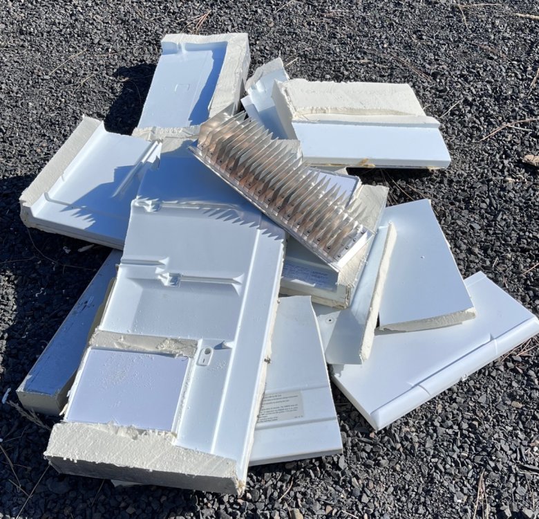

John E Davies Posted April 9, 2023 Author Posted April 9, 2023 I dissected the coil section out in my back yard using my Dewalt saw. All the pieces except that section have gone into the trash or recycle bin. I need to find a place that will accept it. The county Hazardous Waste site won’t. If I lived in a remote area I would use it for target practice… John Davies Spokane WA 2 SOLD 07/23 "Mouse": 2017 Legacy Elite II Two Beds, Hull Number 218, See my HOW TO threads: Tow Vehicle: 2013 Land Cruiser 200, 32” LT tires, airbags, Safari snorkel, Maggiolina Grand Tour 360 Carbon RTT.
