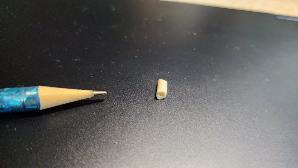

johnwen Posted May 7, 2023 Posted May 7, 2023 We had the Truma retrofit done this January. Of course it was too cold to properly test it out. We tested long enough to make sure the unit went through all its cycles. All looked ok but I had a leak around the curbside bed coming through around a screw holding the window interior trim. Service said it was probably from condensation between the hulls and finding its way around the screw. They removed the screw, put some sealant around it, and reinstalled it. All was ok. The weather was cold and low humidity so I don't think much condensation was generated around the A/C coils. High humidity and a warm night had us using the Truma for the first time last night. The A/C worked fine but no condensation came from the drain tubes and water was dripping from around the foam on the bottom of the Truma. No leaking around the windows inside, no water coming from the numerous weep holes on the bottom of the trailer. The basement was moisture-free as far as I could tell. The trailer is level. I ran some wire up the drain tubes to rule out critter nests. I could only get 2 feet up the street side tube...no foreign objects. The curb side was a little different, the wire stopped after about 5 inches. So I pulled back the fiberglass sheet from the exterior basement access and found the train tube makes a sharp turn before going up to the A/C so I could not pass the wire past that point. The hose was pretty kinked at the bend and I straightened it out as best I could...condensation would have passed through anyway, I just improved the pathway. Since the tubes are clear I saw there was nothing in the tubes except for this little piece of wire insulation trapped inside the bend on the curb side. Since there is no evidence of any moisture in both tubes, I figure that both cups that collect the runoff underneath the A/C pan could be full of something (wire insulation?) or the tubes are not connected to the cups or maybe the tubes vibrated off their fitting. After this lengthy prelude my question is this... is there a way to inspect the moisture collection cups and the associated plumbing going to the drain tubes? Everything is pretty well covered up top of the unit and all screw holes are well sealed. John 2022 Oliver II #996 "Bessie", 2019 Silverado LTZ 5.3, Veterans https://wenandjohnsadventure.com/
