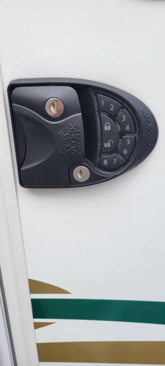

StillGame Posted August 12, 2023 Posted August 12, 2023 For those with the electronic door lock that was supplied in 2021( RVLock brand) that may have peeling numbers, here's the fix. The lock has a decal that was peeling on the numbers used for my entry code. I just installed a replacement one piece membrane that solved the problem, took 15 minutes to remove the lock and install the membrane. https://www.rvlock.com/products/upgraded-silicone-rvlock-v4-rh-keypad-membrane?_pos=1&_psq=V4+Durō+Keypad+Premium+Membrane+-+Right+Hand&_ss=e&_v=1.0&variant=42649755713730 V4 Durō Keypad Premium Membrane - Right Hand 1 2 Jeff Simone and Katie Thibodeau 2021 Oliver Elite II Hull # 802 Tow Vehicle; 2018 Silverado 2500HD LTZ Crew Cab 6.0 Liter Vortec
MAX Burner Posted August 18, 2023 Posted August 18, 2023 Our's is doing the same thing - just ordered the new part. Thanks for the great post! Art, Diane, Magnus & Oscar (double-Aaarrf!) (SOLD) 2022 TUNDRA (SOLD) 2017 LE II; Hull #226 "Casablanca" HAM call-sign: W0ABX
SNY SD UP Posted August 18, 2023 Posted August 18, 2023 Same thing happened on our lock keypad, and we did the upgrade as you did. 1 Maggie & Bryan | Arnegard, ND | 2020 LE II "Twins" Hull #665 | 2021 RAM 2500 6.4L HEMI Gasser 4dr 6.5' bed

MAX Burner Posted May 6, 2024 Posted May 6, 2024 It's really a piece of cake to replace - just can't figure why RVLock doesn't use the heavy-duty replacement as OEM for the lock set to begin with??? 1 Art, Diane, Magnus & Oscar (double-Aaarrf!) (SOLD) 2022 TUNDRA (SOLD) 2017 LE II; Hull #226 "Casablanca" HAM call-sign: W0ABX
