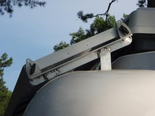

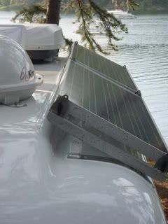

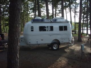

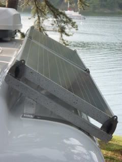

Here are a few taken shortly after we had the panels installed:
In this one, if you look closely, you'll see the awesome saddle bracket Oliver made to match the curve of the hull.
We took all these at beautiful Lake Ouichita campground on our way to the River RV Rally.

How are the panels attached to the roof? Screws, bolts, etc. I am wary of putting any holes into my Ollie.
