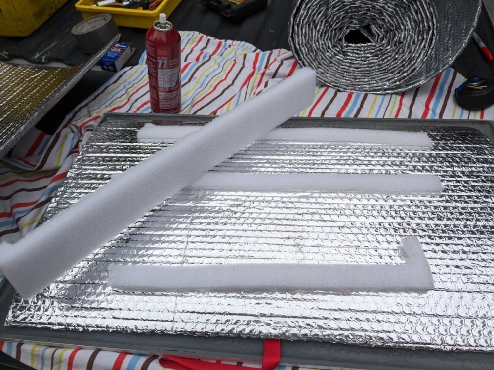

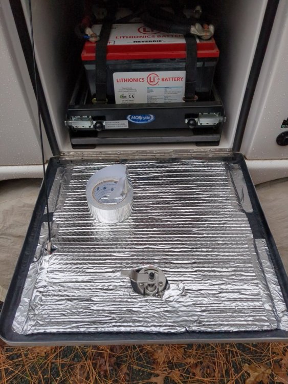

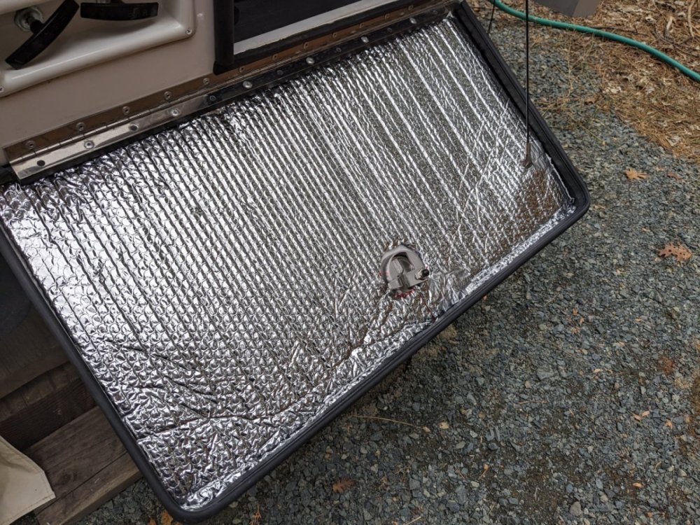

My adventures in reflectix have begun. The first photo shows one single layer cut to fit the basement door. No glue or tape, just cut to fit and pressed in. We'll see if it stays in place when on the road, otherwise I'll use some double sided tape. The second photo shows the two hatch lids under the street side bed. The fourth shows how I used some foam strips to keep about 3/4 of an inch space between the two layers for increased R value. Per advice above, I used the spray adhesive only to stick the foam pieces on the reflectix, then used aluminum tape around the edges. Next week I'll continue working on the basement area.
