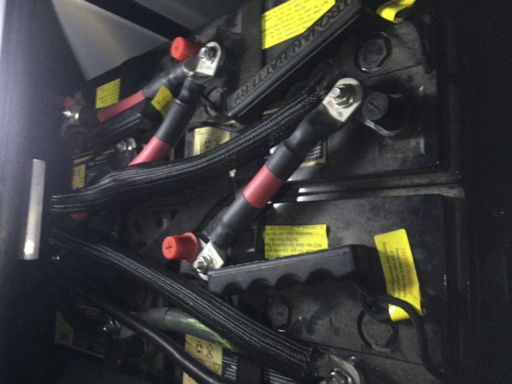

  21. Here are the answers to your questions bhncb: 1. I flipped that jumper when I was attempting to attach the the inverter cable on the same post with the solar charge cable and 12v main, thinking that it might give me more room. It didn't. I gave up trying to get it on that post, came in the house, and saw the diagram that mossemi had sent. I'm thinking that, now that it works as is, I'll let it be. (Sharp eye for noticing though.) 2. Yes, the cable had no problem reaching that middle battery terminal, and the tray slides open all the way. I earlier mentioned that I could not pull it out to reach one of the OUTSIDE battery terminals, which someone earlier seemed to suggest I do. The mystery remains about why that cable was not attached with the inverter working for two years previous to it malfunctioning. It sure was a hassle diagnosing and solving the problem, but I'm glad that the inverter is intact, and I agree with Mike: "Issues like this result in better knowledge and greater confidence. It also helps to have so many smart folks willing to jump in and help." Thanks!

  23. Here you go. I think that I failed to understand that you were talking about the same screw post that mossemi revealed in the diagram he shared. Please critique. Thanks for your help and patience. All seems to be working. So glad I didn't have to deal with a fried inverter. Still puzzled by the loose cable.
  24. THANKS! I just about ready to correct my post of "SUCCESS!" because I could not get the inverter lug on that post with the other two lugs attached. Thanks to you, I will now try putting it on the post indicated by the Oliver diagram. I AM a bit concerned, nonetheless, because a yellow sticker on the battery informs me that the screw posts are NOT to be used except for low-current applications. I supposed that powering an inverter might not be a low-current application, but was then puzzled why the lug was obviously set up to be attached in that manner. I will now suppose that powering the inverter via the screw post is OK. I am going back outside now to attach it to the post indicated by the diagram. Thanks again.
  25. SUCCESS! I took the chance and leaned the cable lug up against that positive post of the inner rear battery (no explosion or fire!) and then tried turning on the inverter from the remote switch--and VOILA! I sure am glad that the problem was not due to a fried inverter. I will now work to firmly attach that previously mystery cable to the post. The mystery remains, however. How did it come loose? As you pointed out, there are indications it was once attached to something, but as I mentioned, I have had no work done in there, and I certainly did not mess with it. Perhaps it had been attached and detached at the factory for some reason. Perhaps it had been touching the post somehow for two years, allowing the connection to be made, and then flopped off during travel. I can see some silver lining in two days of hassle over this issue: 1. I learned more about the functioning of my Ollie, as I have every time I have had to deal with some issue. 2. I, once more, gained appreciation of the help Oliver owners are willing to offer their fellow owners. Thanks, bhncb, and everyone else who offered their insights and suggestions!
