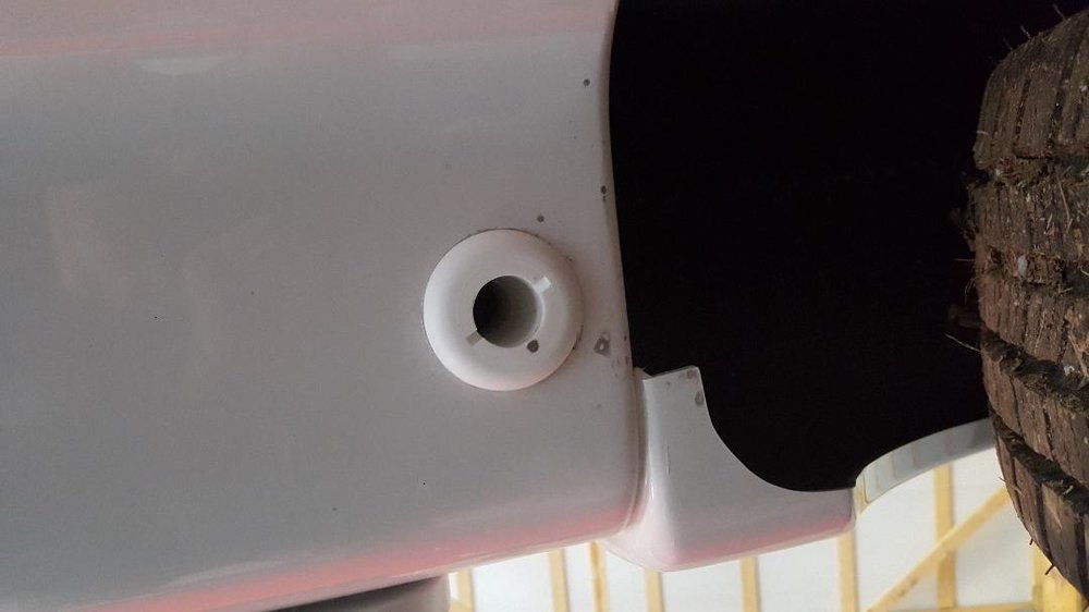

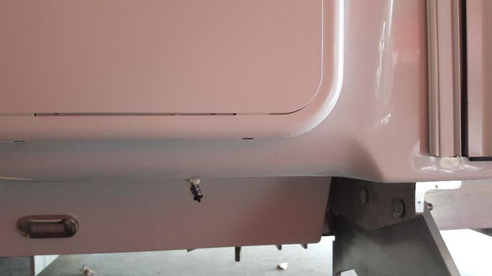

Water comes out of the 2 weeps on street side near where the outside shower is located and basement is located. It happens almost immediately when turning city water connection on. I own a LE II.

Day 10 of 35 day shakedown camping trip. I have been running water from my fresh water tank. Today, I moved to a different campground and decided to hook to city water. I hooked to city water with psi of 20 according to my gauge. Water pump is turned off. I turn on outside water source and turn on water in bathroom and kitchen. Water flows through the faucets but I get lots of water coming out of the 2 overflow ports near the city water hookup port. What have I not done correctly? Any ideas?
Thanks so much to everybody's help. I am in business. I appreciate the quick assistance via your input. As a first time RV owner, it is very reassuring to know that there are people on this Forum that can help immediately! Darryl
