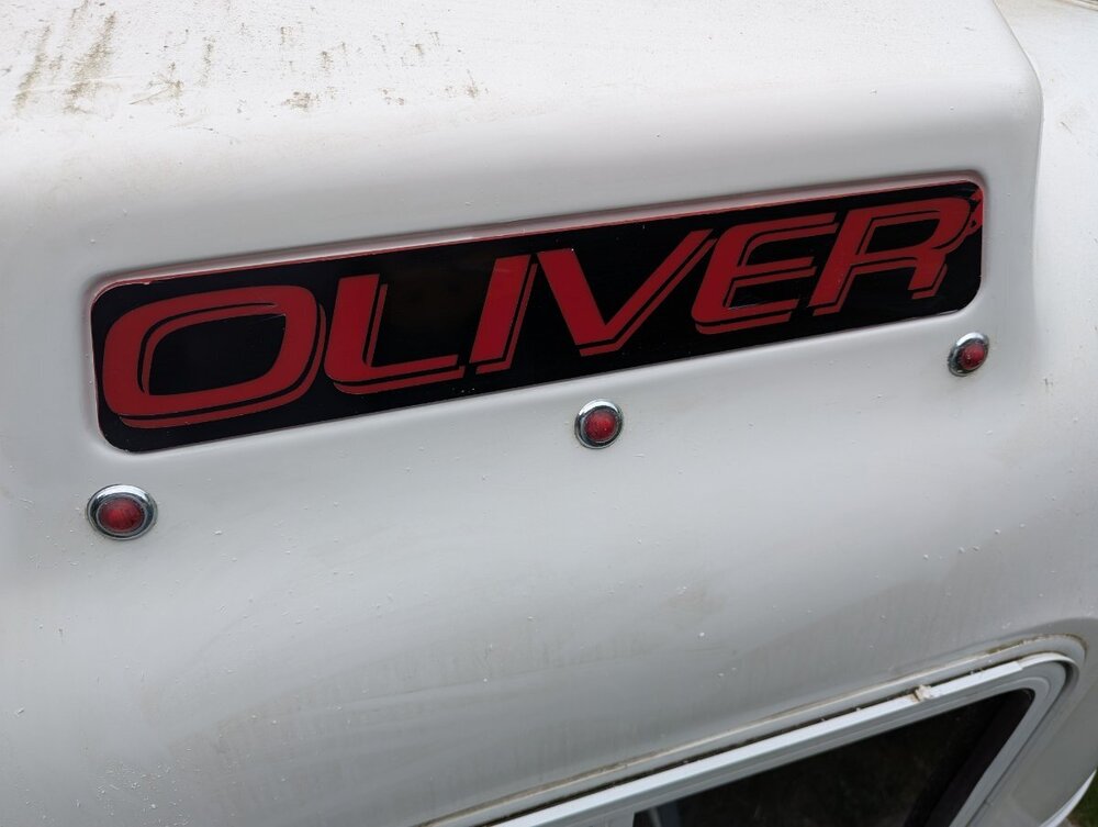

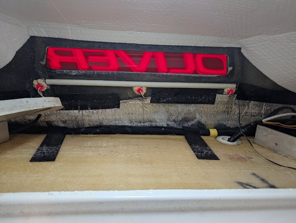

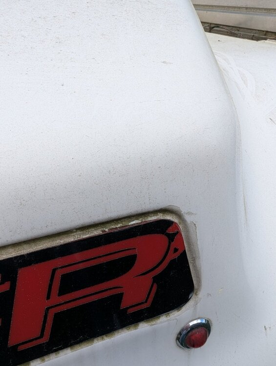

After returning home I was able to better investigate the water issue. Turns out the attic was not dry. It was wet underneath the white insulation layer. I was able to easily peal the the insulation up. The leak was coming from the Oliver Sign. The caulk had dried and cracked. It is actually amazing how much water could get in from that source. All things considered this was the best scenario for the source of the leak. I was able to remove all the old caulk and re-caulk the sign.
I took the sides off in the attic. It is completely dry, even dusty. The only place that is even damp is right around the hole. I also took the inside cover off the AC. The inner seal is completely dry. I'm on the road and it's still raining, so I'll have to investigate on the roof more at home.
After a heavy rain we have water leaking out of the port the TV wires come through? Has anyone had this problem? The attic is dry?? It seems to be coming from between the fiberglass layers. My initial guess was either the AC or the Oliver Sign. There is no leak around the AC unit directly in. The seal is completely dry and the Ollie sign seems fine. I have not had a chance to go onto the roof to investigate.

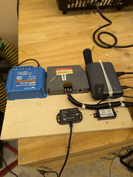

I just received my new Starlink Gen 3. I mostly boondocks and thought it would be a waste of power to convert DC to AC to DC to power the Starlink. I found a device that will convert DC 9-36V 15A to DC 46V 3A through POE. It also has a built in switch to deliver the internet signal to the router of your choice. (XLTTYWL Starlink V3 Poe Injector, 150W 2 in 1 GigE Passive & ESD Protection Starlink 12v Conversion Kit with Starlink DC Step UP Converter DC 9-36V/150W for Starlink Gen 3 Dishy) I am using a mini travel router (GL.iNet GL-AXT1800 (Slate AX) Pocket-Sized Wi-Fi 6 Gigabit Travel Router, Extender/Repeater for Hotel&Public Network Storage, VPN Client&Server, OpenWrt, Adguard Home, USB 3.0, TF Card Slot) uses a USB C power source DC 5V 3A. I wired a PlusRoc Waterproof 12V/24V to 5V Converter DC-DC Step Down Module Power Adapter Compatible with Raspberry Pi 4, Cellphone, Car (USB Type-C Connector) to power the router. I mounted everything on a board and powered it from the DC fuse box under the dinette. I will add a waterproof Ethernet port as shown in many other Starlink threads. It powered up and so far is working great. Even the Starlink mobile app recognizes the signal from the mini router and allows all the Starlink utilities to be used. I had a Victron Solar Panel Charge controller for a suitcase panel in the spot where I mounted the board so I just moved that to the board as well. I love not having to turn on my inverter to run the Starlink dishy.

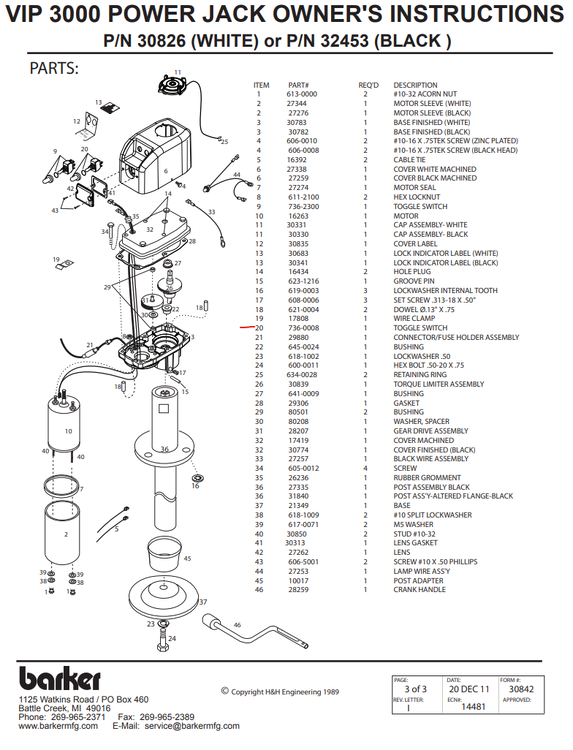

I was able to find the part with Mike Sharpe's help. I am attaching the Barker parts list he sent me as a reference. He marked part #20 but that is the light switch. Part #9 is the up/down switch. Here is a link to the place I bought it from: https://pdxrvwholesale.com/products/barker-jack-up-down-switch-736-2300

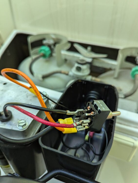

My tongue jack toggle switch stopped working in the up position this weekend. So I was not able to raise my camper. Luckily the bottom half of the switch stilled worked, so I could lower it. As an FYI: If you switch the red and black wires around it reverses the action of the switch so the down position becomes the upward movement. I was able to rewire it back and forth to get my camper hooked up using the motor. Having the inline fuse right there to cut the power off/on while switching back and forth was convenient. (obviously it could be done manually with the crank as well but then I would not have had anything to post). 🙂

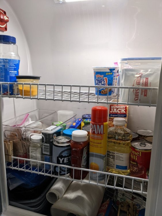

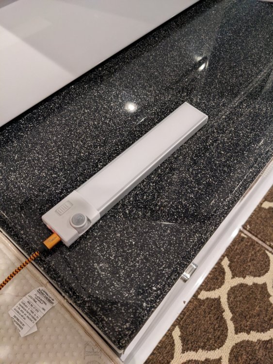

Not sure if this has changed since my 2018 LEII but we do not have a light in our pantry. I have been through a couple of stick on lights and finally found one I like. Sunbeam+ Under Cabinet Light. It comes with adhesive metal tabs the light is magnetic and sticks to the tabs. It needs to be easily removed because it recharges with a USB type C plug. It is motion activated and turns off automatically after 20 second. It has three color options, light blue, amber and white./ $22.00. I will update this post after traveling to update how long it lasts on a charge and if it falls off the magnets during traveling. https://www.acehardware.com/departments/home-and-decor/novelty-items/miscellaneous-novelty-items/6012170 lightvideo.mp4

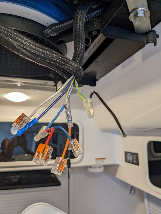

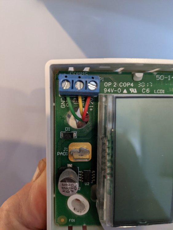

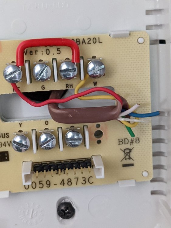

Here are the photos of the final wiring. I used the Red (spliced on AC side to white) and Yellow (spliced on AC side to orange) thermostat wires. As you can see in the photo the blue/white was the 12 v and the solid blue was the wire to the heater as @Minnesota Oliconfirmed. I checked with a volt meter and connected them at the AC side to confirm the heater would turn on. On the Tstat side the wiring is self explanatory from the picture. The only casualty in the install was blowing the 7.5 A fuse which is located under the dinette. After closing everything up and THEN putting in the new fuse so I would not blow it again everything is working great. What an excellent upgrade the low profile inside portion along with the reduction in operating noise was well worth it. BTW: if you are in the metrowest Boston, MA area and need any RV repairs; I used TRIC Mobile RV to do the heavy lifting to remove and replace the actual AC unit. https://tricmobilervrepair.com/ They did a fantastic job so I would definitely recommend them. -

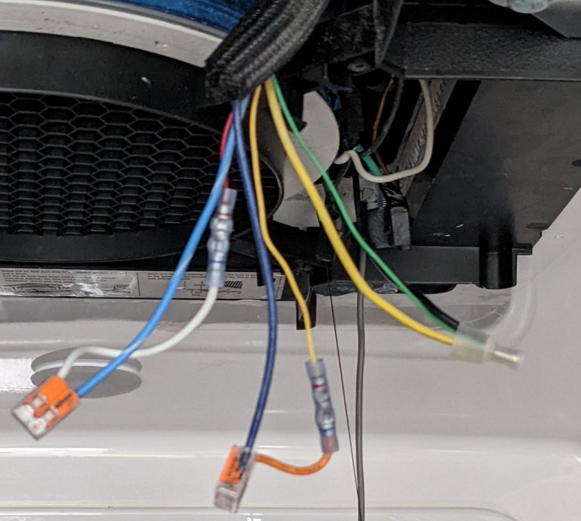

@Jps190 My trailer is a 2018. I could not find the spliced wires under the heater that you show in your picture. I am going to post a picture of the wires that were cut from the AC and the current thermostat wiring. @Minnesota Oli or anyone else can you confirm which wires to splice together to eliminate the LCD control and wire the simple Emerson Thermostat. Thanks. The wires shown here pretty much the picture from Minnesota Oli with the exception the red connected to the white/red. Also he describes doubling up the wires from the thermostat but my thermostat only has three wires (yellow, red, green). It looks like only the green and yellow Tstat wires are in the wiring harness that is at my AC end. -

@Spike do you know any of the specifics regarding wiring the Emerson non-programmable thermostats? I have just replaced my Dometic AC with the low profile Houghton. The AC is running great using the remote but I now need to rewire/install the Emerson Tstat. Anyone that can provide wiring information would be greatly appreciated. Thanks! -
