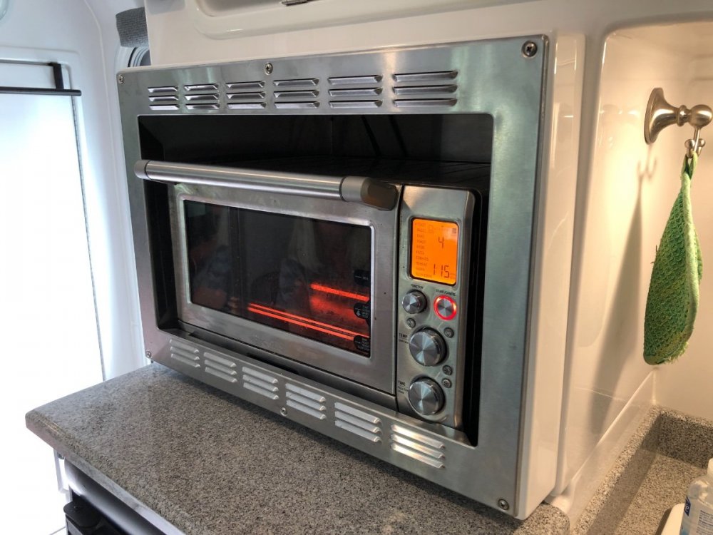

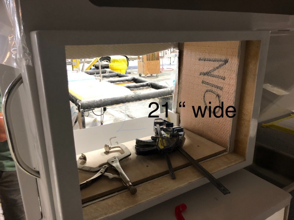

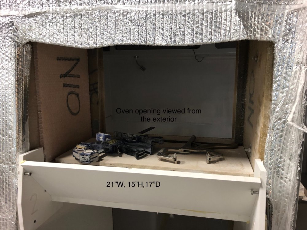

  13. Had a stainless steel box insert made for the oven and used the supplied frame from the original equipment.
  14. Below is the finished project. GREAT oven and very versatile, if you done need a microwave!
