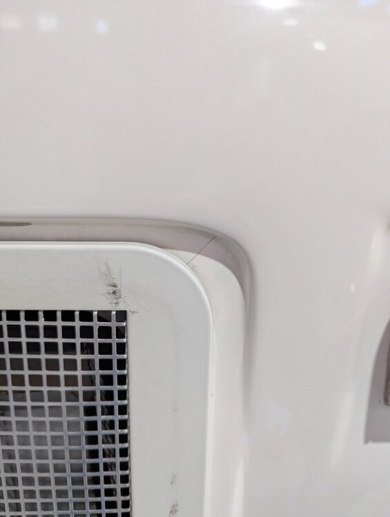

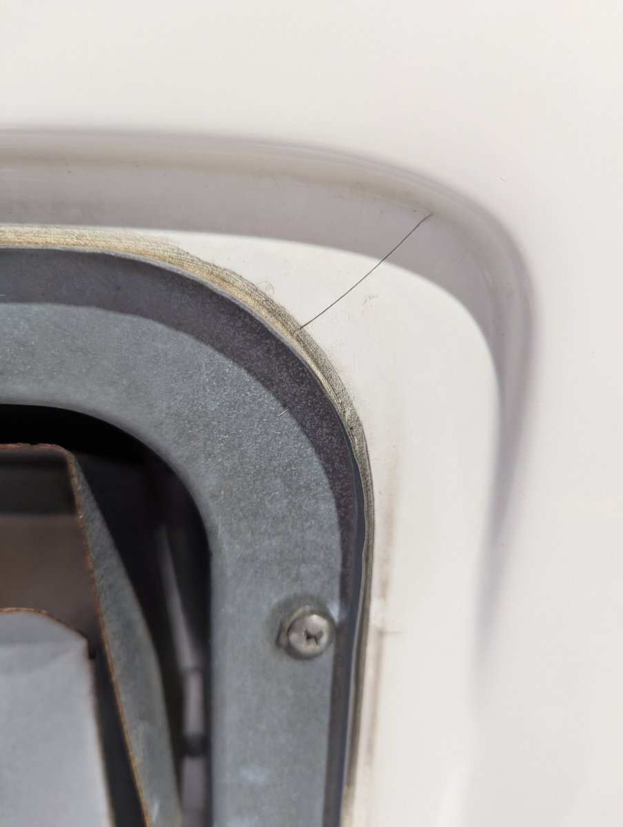

  9. Update to our situation: I found a good fiberglass tech here, someone who's worked on Corvettes for many years. He wants to determine whether this is just a gelcoat crack or if the underlying fiberglass is damaged as well. To that end, he wants to grind off the gelcoat and inspect the fiberglass beneath. If the underlying fiberglass is damaged he thinks we should take it back to Oliver to have the water heater removed and the fiberglass repaired. I did get a better picture of the back side of the cracked area.
