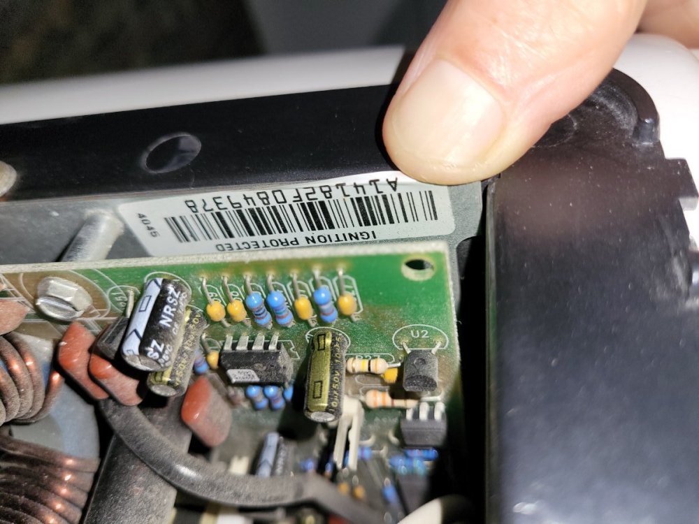

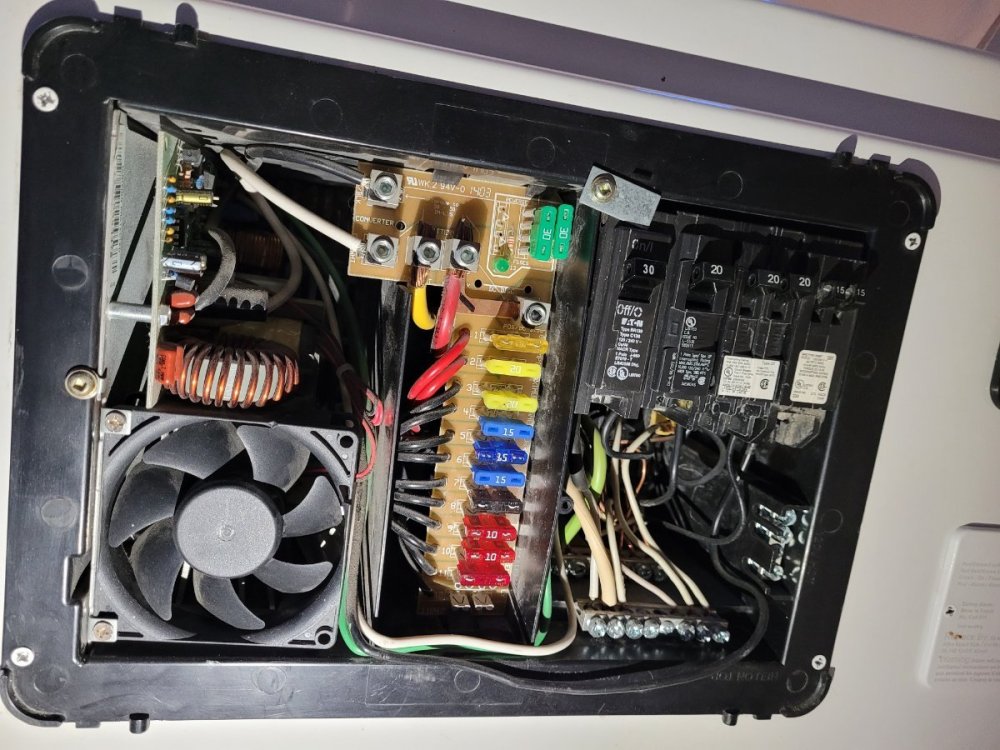

2015 LE2 Hull 67 This story is evolving as we continue to remember and put together things that happened during and after the Rally. I'll try to distill the story to the essentials. 1. During rally went to charge phones on the 120v a/c plugs and they didn't appear to be working. Tried resetting the GFCI under dinette, no results. Opened the control panel under dinette and the 15amp circuit breaker was flipped to off. Didn't think anything of it at the time. We were plugged into a 30amp post at the site. 2. After getting home, plugging the trailer in, and unloading the Ollie went back out later and the CO2/LP alarm was goiing off. The LP light was flashing red. Hit reset, double checked the propane tanks were off (they were), tried to light the stove top to bleed out any potential propane in the lines (none). Alarm came back on couple more times. Back of the alarm has red date stamped of Oct 11 2019. Not sure if this is a creation date or expiration date. Guessing creation. 3. Went out to trailer little bit later to do/check something and heard this buzzing sound (first time), like something was humming from being on. Tracked it down to the Power Dynamics Power Control Center PD4045KA under the dinette, and next to the CO2/LP alarm. It was hot in the trailer, those 90 degree days. 4. Took the panel cover off of PCC and nothing looked unusual or suspicious. The only odd behavior was when we flipped the 2nd from the end 15amp breaker to the off position, the fan started to spin a little and then stopped. That is a consistent movement when we flip that breaker to the off position. 5. We've read the thread on "Buzzing noise from under dinette" which was very helpful. Uncertain if we have a bad fan issue or a bad board issue or other. The buzzing stopped at some point and haven't heard it again. Concerned this is the beginning of an issue we really want to resolve before more travel. We welcome input from all as to what the issue might be, things to check, or questions to ask Progressive Dynamics. We have not yet called them. Thanks much!
