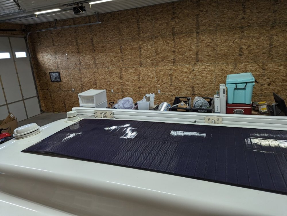

Well. They won't be easy to remove. Time will tell on these. Here's 300 watts. I taped all corners after these pictures with light eternabond.
