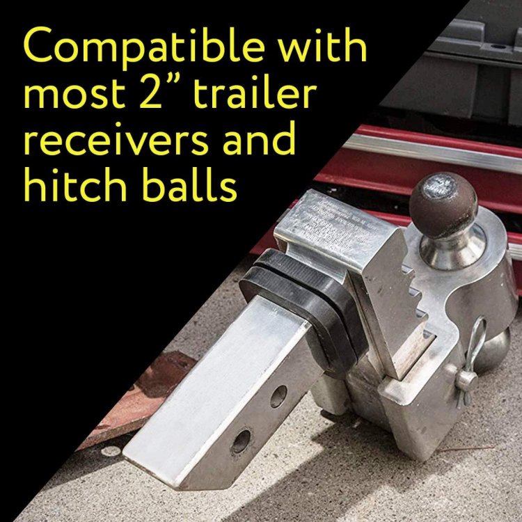

All of the hitch pins I measured were 5/8 nominal size. I found there was considerable + / - tolerance, not to mention the hole variances. My original hitch pin was an inexpensive locking one, probably made to loose tolerances, and was already showing wear (8000 miles). It remains to be seen how well the new hitch pin and rubber donuts hold up. I used 5 of the donut pieces stacked on the Anderson square piece. It is so stacked that I need to apply pressure to compress the rubber donuts in order to fit the hitch pin in the hole.
Impresa Products Impresa - 2 inch Hitch Receiver Silencer Pad for Adjustable Ball Mounts - 3 Pack
Towing my Elite I with the Anderson hitch, I've encountered a lot of forward / backward sliding of the square shank within the receiver mount on my truck. It has been a cause of annoyance at stops and starts as the entire hitch can be felt sliding. Upon investigation I found that the hitch pin I was using is slightly undersized, as were most of the other pins in my garage. To remedy this, I took my calipers to Tractor Supply and mesaured every hitch pin on the shelf. The BROK locking hitch pin was the winner, at about 0.8mm larger diameter than the one I previously used. I also installed some rubber 'donuts' around the exposed shank to take up the slack. together these two measures have almost totally eliminated to back and forth mothion of the Anderson ball mount

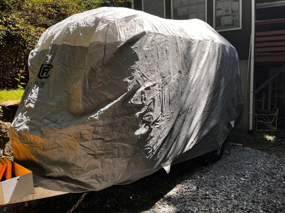

I just received a “PolyPRO 3” cover made by OVERDRIVE fromAmazon . This cover looks similar to the one earlier in this thread, except it is sized and sewn specific for “egg” campers from 13’ to 16’. Since my Legacy Elite is approximately 15 1/2 feet, I thought it would fit OK. Just completed a dry fit (didn’t cinch up the ties) and the fit is acceptable. I do not have solar, but I think it would cover the factory panels fine. I’ll be putting it on for the winter sometime around Thanksgiving and we’ll see if it makes it through the winter. I am mostly concernecd about leaves and sticks since we live in the deep woods and do not have a way to keep it under a roof. -

Legacy Elite owners be advised: this does not accommodate the safety chains or the trailer plug due to the location of the jack with respect to the coupler and tongue box. This was a disappointment to me, as I followed the user reports of this cover here in this thread. I promptly returned mine and ate the shipping cost... Otherwise, it looks like a fine piece of kit.
