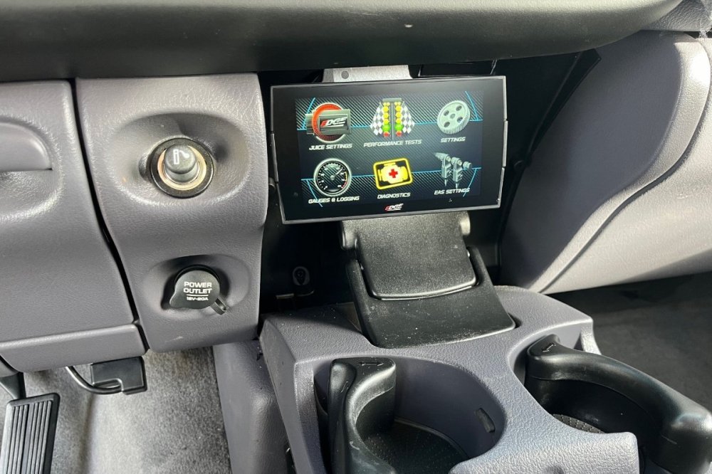

I recently install and Edge Juice with Attitude kit which adds a performance chip replacing the ECM for fuel metering providing extra towing power and better GPM: Juice With Attitude (edgeproducts.com)
We actually went from 12 GPM to 17 GPM, pulling the Oliver, on two recent trips in the mountains. Not at all a scientific test, since the first trip likely had more elevation ups and downs, but it is for sure much improved. Driving uphill in the mountains is now much stronger too. There are also gauges for fuel pressure, trans temp and EGT (exhaust gas temperature) for diesel engine safety when adding more power. This was a complex installation, with a dozen under the hood connections. I was very happy when the truck started up immediately after. The picture shows where I installed the Attitude display under the dash. They supply a hokey windshield mount, but I didn't want my view obstructed at all. It works nicely there. Notice above the fuel pedal, you can see where it connects to the OBD-II port for reading ECM and sensor data.

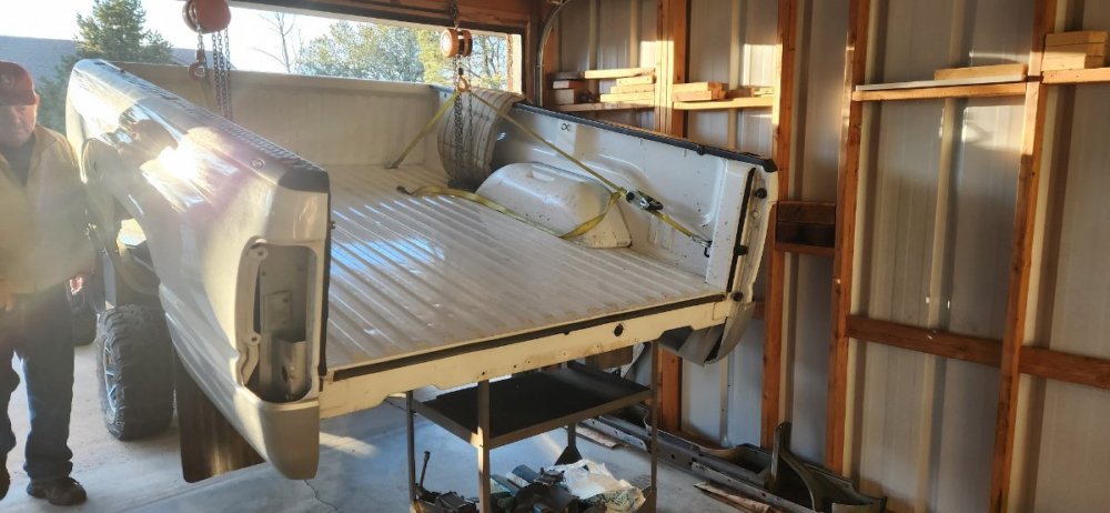

It's amazing how easy it is to remove a truck bed, this being my first experience doing this. Remove the taillights and make sure all frame-mounted wire ties are disconnected. You do not have to remove the rear bumper (only 6 bolts), but it is safer unless you can lift the bed straight up. The bed is attached to the frame, 8 bolts on my long bed and 6 bolts on a short bed.

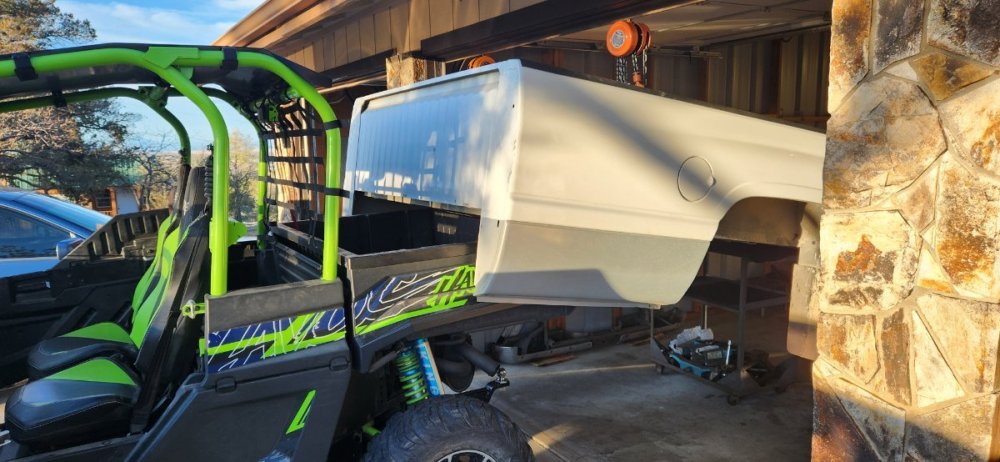

The real trick is how to hoist the bed. The senior member mentioned used a gantry and hoist. A basic gantry costs $800 and could not find one to rent locally. I figured I could buy two inexpensive chain hoists to do the job, but the only location strong enough to mount the hoists, was to the header of my garage door. Then the bed would be hanging half-in and out of the garage. It was truly scary driving my truck out from under the bed, but son Adam was guiding the rear end while Chris was keeping an eye on the underside!
I was determined to get the bed fully in the garage stall as we are in the SW windy season now. It's crazy how recently we use our side-by-side more for home projects than for enjoying the AZ dirt trails! The bed will sit just like this until the install is completed.

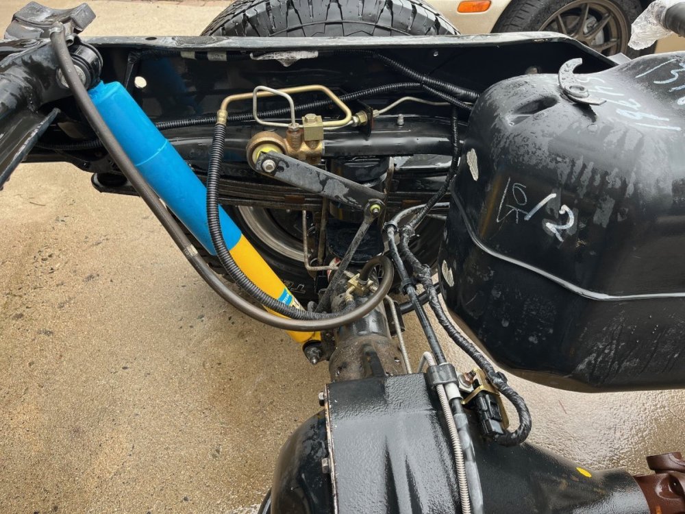

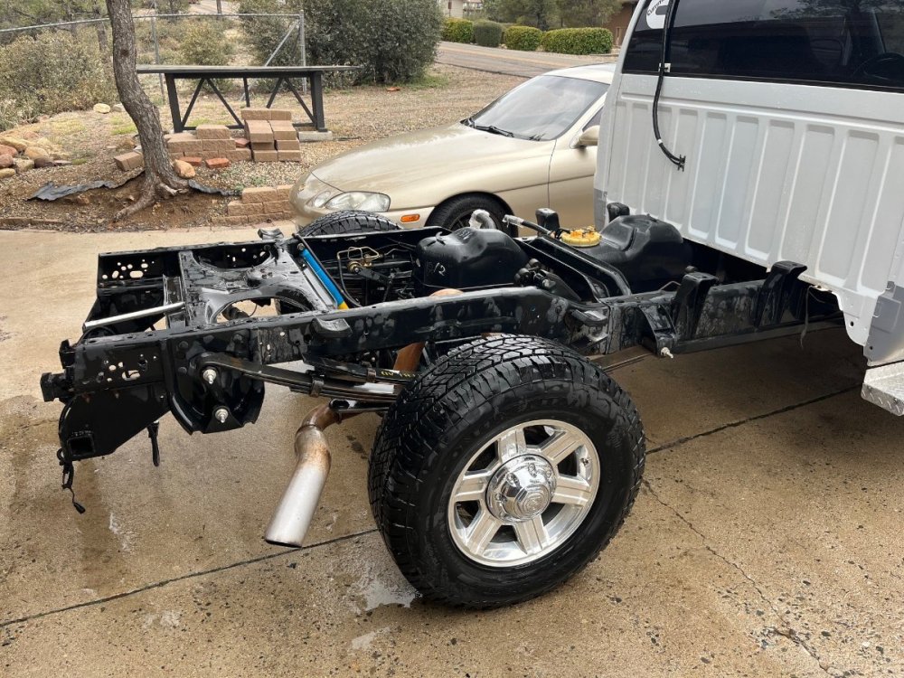

Well, I did everything under the truck when I first got it last summer! Notice the new Bilstein shocks, these would have been installed in 5 minutes each with the bed off! New brake fluid all around, and larger later gen brakes up front. The lines and everything are perfect in this AZ rust-free truck. I did the diff with new oil and PT additive, everything. The supply line will be replaced with a new 1/2" fuel line included with the kit.
Good to read of your project @Half Fast Hugo. I went directly with the full Fleece kit vs. a Fass or other frame-mounted lift pump since my truck was dealer retrofitted with an in-tank pump when it was new.

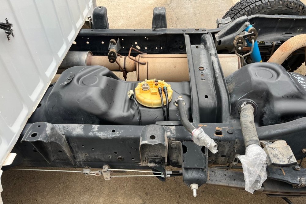

I purchased new rubber hose for the tank filler and vent. The metal end of the vent line was rusty inside, so brushed that out. Great time to replace the exhaust hangers but the rubber on them is still supple. Painting no, don't really believe in paint on paint unless you were doing a frame-off, everything clean and sanded.
Pressure washing yes, sure looks great after all the Arizona red dirt is gone! Before and after pics to follow --

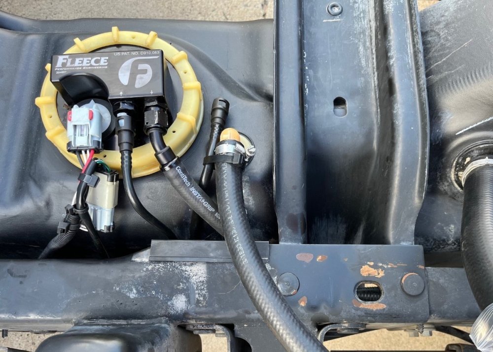

Today was the day to prime the pump and filter. I have the tank so low that first thing was to buy a couple gallons to add to the tank.

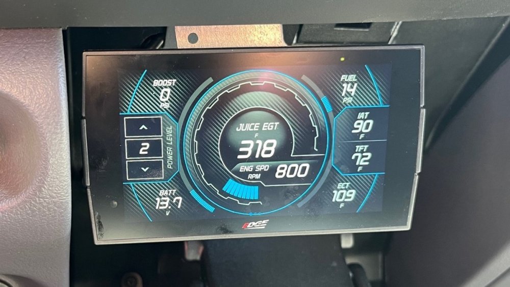

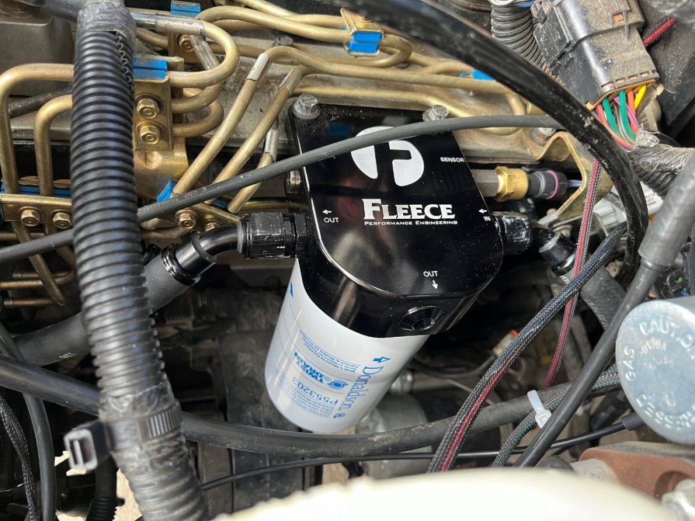

Bumped the starter a couple times which causes the fuel pump to run for about 20 seconds. The new Fleece pump groaned a bit to fill at first and then it's much quieter than the ringing sound of the OEM pump. I just loosened the nut on the return line of the VP44 (injection pump), a little fuel came out and that's all she needed. Started right up and sounded good. No leaks anywhere. Nice!
First pic tells the final story. I had lift pump PSI from 8 PSI idling to 2 PSI with a heavy foot. Now I have a solid 14 PSI (top right corner of the display). I've only idled so far, hit the pedal while standing and still 14 PSI. Friday I will replace the bed and take her out for a drive!

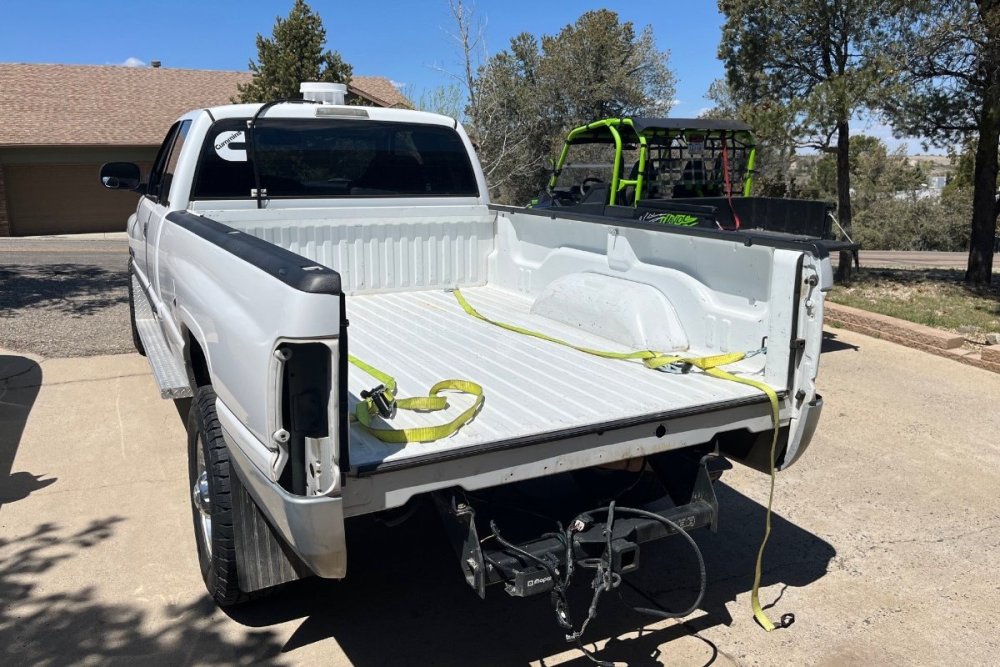

It only took an hour today, to hoist up the bed, pull the side-by-side out and back the truck in (Adam holding up the rear and Chris guiding the front). Got two corner bolts on the bed and drove her out!

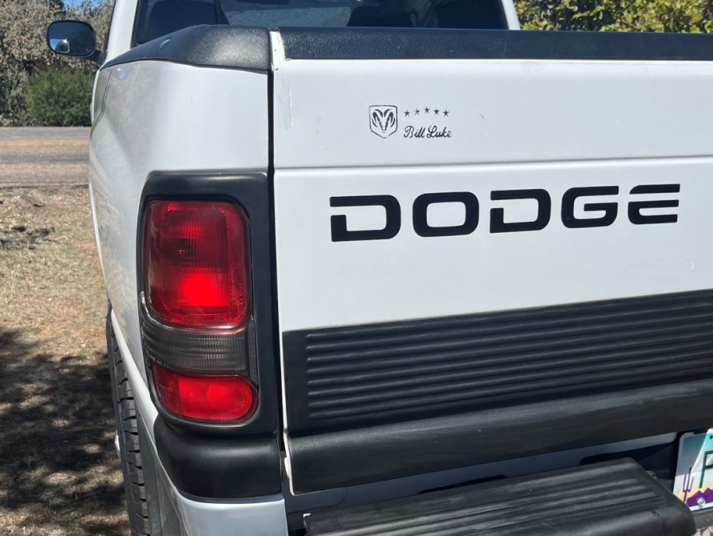

Nice job on those "blacked out" rear lights!😁

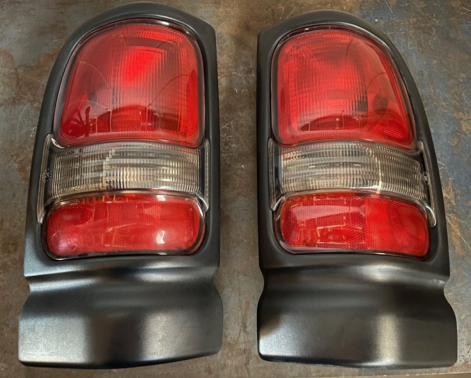

Blacked-out is for kids, but when I had all this disassembled, we detailed the taillights, license plate surround and bumper covers and then all black trim on the TV! I degreased all parts, getting off all the sloppy car wax and rubbed them down with rubbing alcohol several times until the final paper towel was clean. Used Mothers Back-to-Black in the past, but it never really did the job.
Recently, I purchased "Forever Black" and it works great, covering in deep black without brush marks: Amazon.com: Forever Black Bumper & Trim 6 Oz. (New Improved Formula & Larger Size) : Automotive
Looks amazing for 23-year-old trim! Right?

It's GREAT when a repair and upgrade come together nicely. Also had time to clean everything under the bed and worked some Forever Black into all the black trim I had removed. Got the truck 100% yesterday, filled the tank (with 2SO/ATF additive), ran some errands and this truck has considerably more power.
Levels 1-2 on the Juice are really strong! (Levels 3 and above are for built engines AND transmissions only.) Running previously at 6 PSI +/- was starving the injection pump to a point, and likely it was running hot. Now fuel pressure is 15 PSI at idle and a constant 14 PSI when driving.
