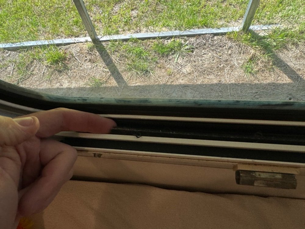

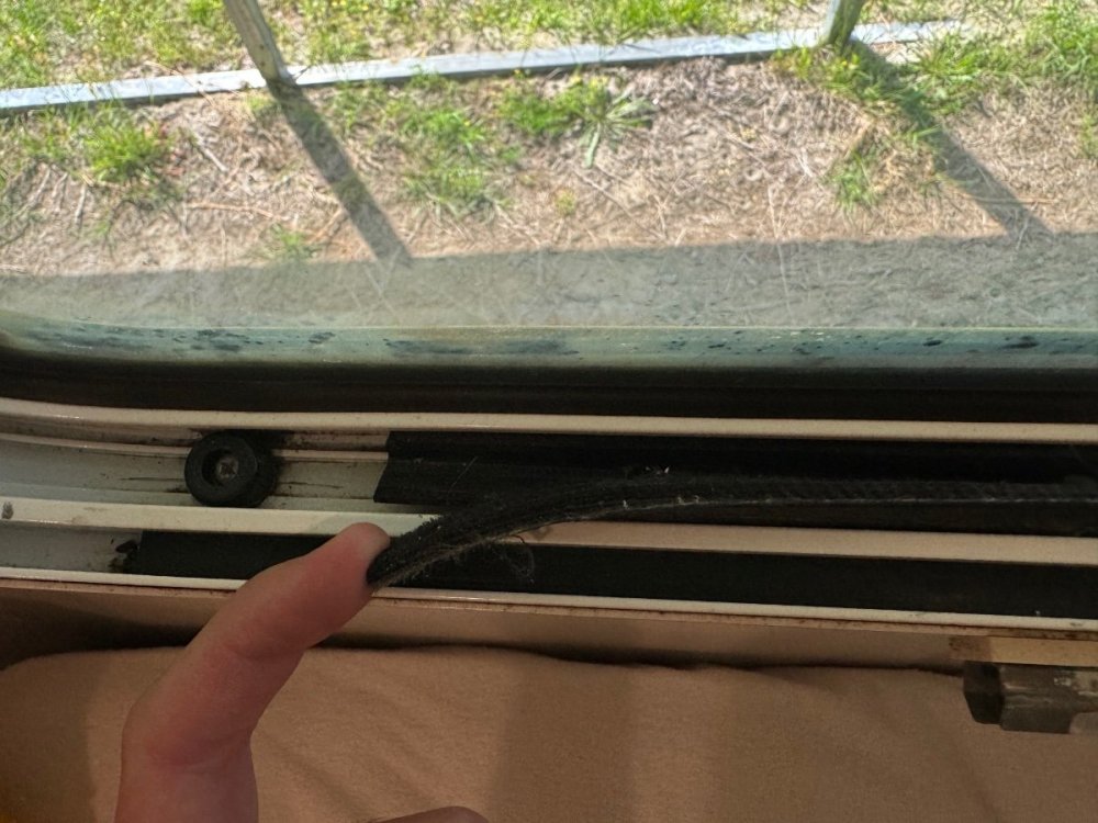

Nan Posted April 17 Share Posted April 17 Hello, the rubber tracks around my side windows (the ones that actually touch the outside of the windows) have folded over underneath the window. Because they folded over, they have become fragile and broken. I have attached photos below and was wondering if anyone could give me a part number or point me in the right direction of finding some replacement ones. Thank you! 2017 LE 2 Hull 267 Link to comment Share on other sites More sharing options...

dewdev Posted April 19 Share Posted April 19 I would suggest that you first go to the Oliver web site and open up a service ticket and ask the question. You can also add your photo to help with the question. Southland may be too new to help you on this issue. 1 2018 Oliver Elite II, Twin Bed, Hull #354 2024 RAM 1500, 4 x 4; Gas. 5.7L V8 Hemi MDS VVT Torque; 3.21 rear axle ratio Maine Link to comment Share on other sites More sharing options...

Patriot Posted April 19 Share Posted April 19 (edited) @Nan @geokeg This link with a tutorial video maybe helpful IF you are needing to replace your window vent sash. https://support.lci1.com/videos/window-vent-sash-track-replacement Another link to inquire about the replacement vent sash - https://www.lippert.com/contact-us Edited April 19 by Patriot 2 1 2020 OLEII - Hull #634 aka- “XPLOR” TV 2021 F350 6.7 liter Diesel Lariat Ultimate Tremor Retro upgrades - Truma Aventa 13.5 AC, Alcan 5 leaf pack, Alcan HD shackles & HD wet bolts, 5200lb axles. XPEL 10 mil PPF front both front corners, 30 lb LP tanks, Sea Biscuit Front Cargo Storage box. North Carolina 🇺🇸 Link to comment Share on other sites More sharing options...
