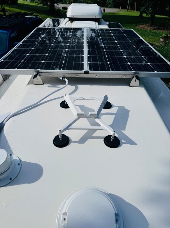

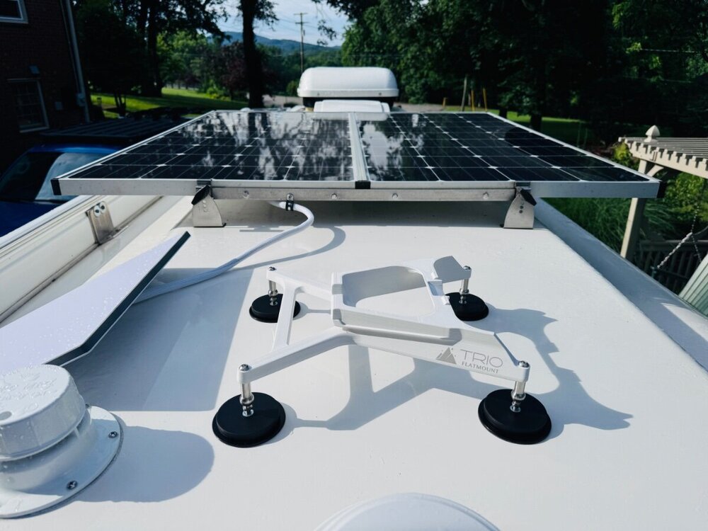

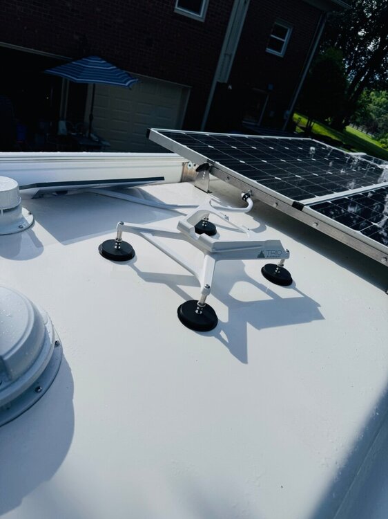

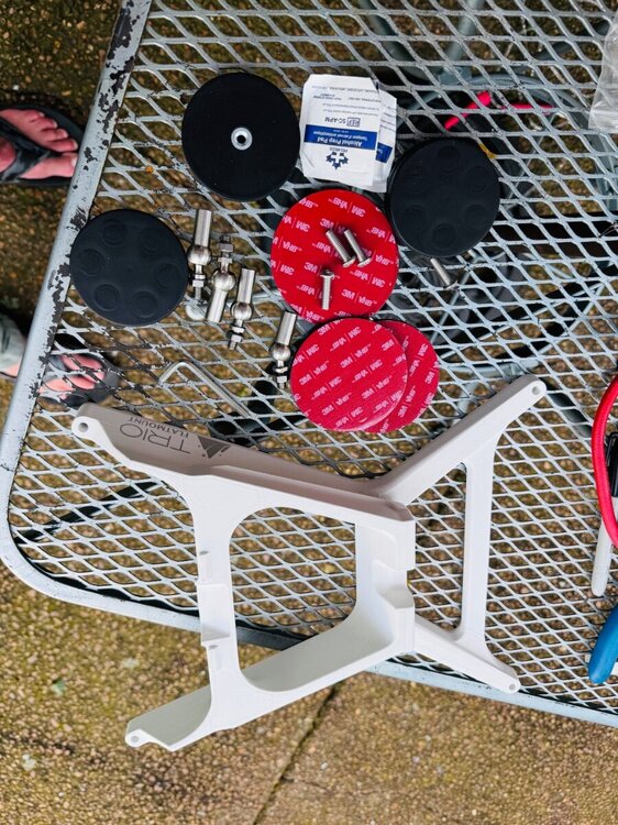

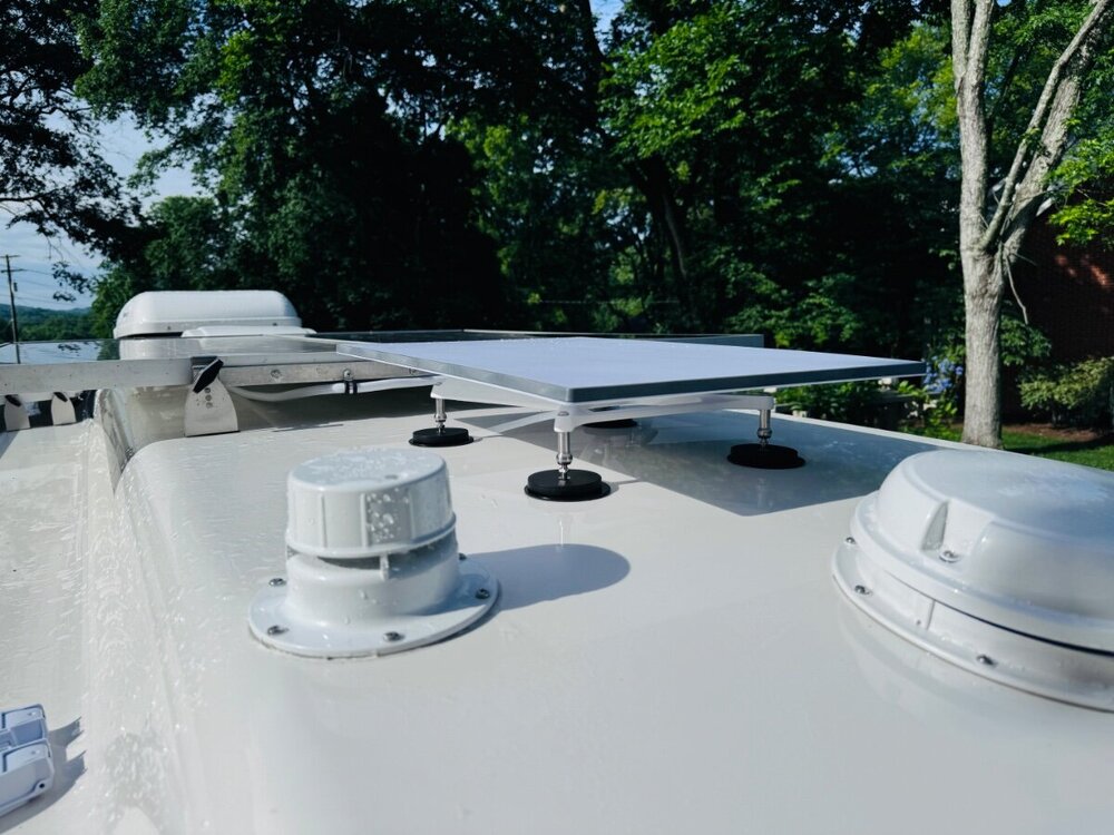

Really happy with the mount and semi-permament installation.

Very nice! Is the mount 3M VHB permanently mounted to the roof and the dish is removable?

VHB to the mount is pretty much permanent. @rideadeuce has used the term "semi-permanent" here and his earlier install thread. Why not permanent? To remove the dish, you have to climb up there, disconnect the cable and snap it off the stand. I'm not getting up on the roof of our Oliver except for installation, unless I really have to!

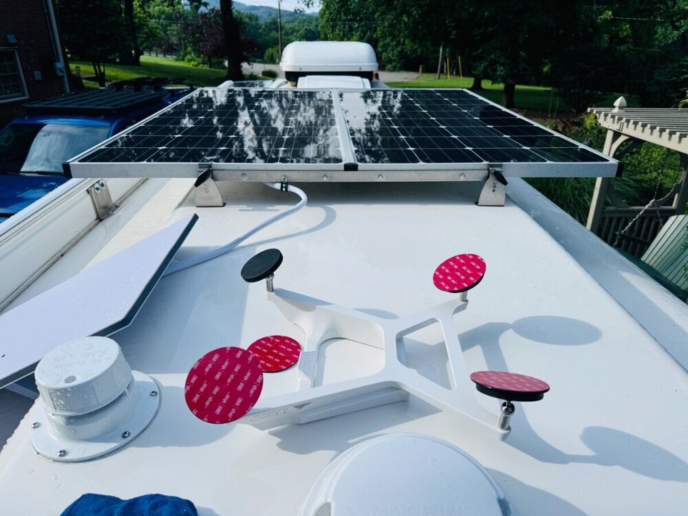

The VHB metal discs are permanently applied, but the magnetic rubberized feet on the mount make it removable for land mount or cleaning/waxing.

The VHB metal discs are permanently applied, but the magnetic rubberized feet on the mount make it removable.
Ah ok gotcha, thanks!

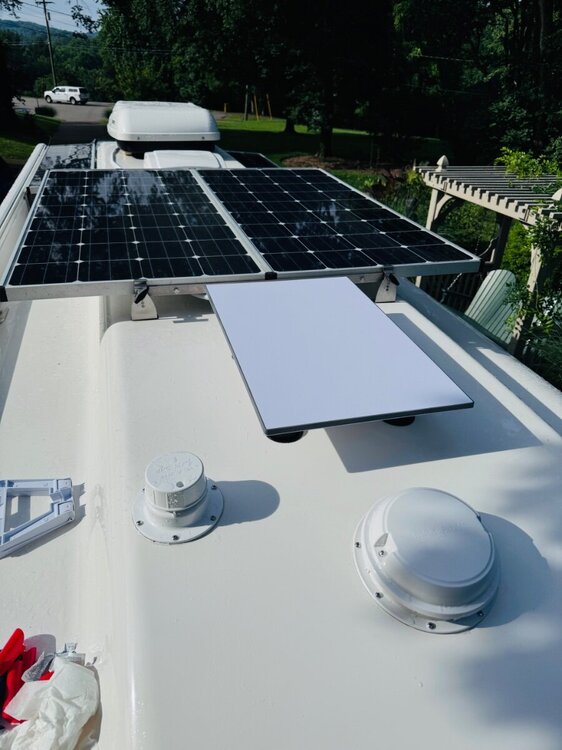

So, if you were to land mount, for example when trees are over the Oliver, do you have an additional long cable, external terminal and a stand for it? Would be a pain to remove the rooftop cable.
Another Q: what is the model of your thin solar panel? Link? Is it connected at the junction box for the stock panels? I could envision two of these left and right angled some to better catch the winter sun.

Mike, do you have a link or part number for those magnetic discs and magnetic rubberized swivel feet?

If you go their website and pick flat mount it is under the mount drop down menu.
https://www.trioflatmount.com/contact-us

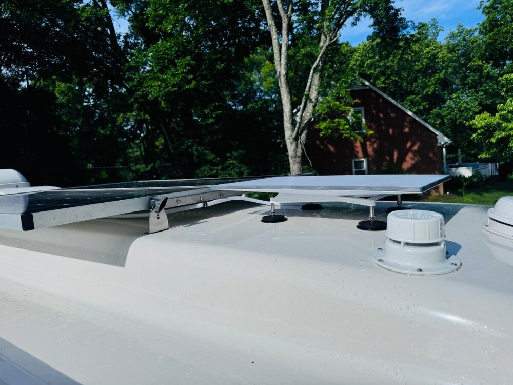

On 5/23/2024 at 9:38 AM, rideadeuce said:
Mike, I see you went with the Swivel Leg Mount Adapters. The roof in that area is not curved much so was that just because you wanted the mount/dish higher up?
@rich.dev Yes
