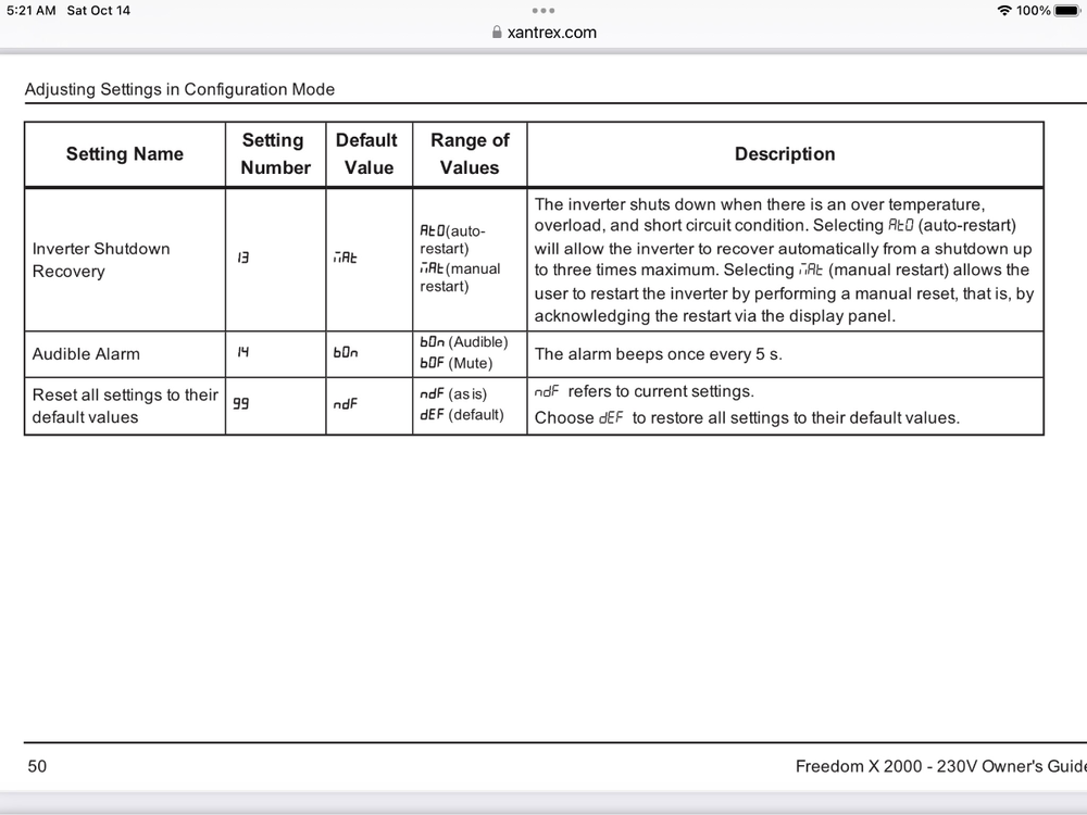

Also related to the Xantrex manual and codes: OTT Service department and I both tried to find the definition of "nAt" to no avail. I will make a separate post for that issue, but wanted to note it here.
See if this helps.
