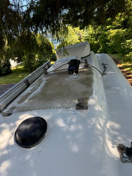

The solar panels on my new-to-me 2015 LE1 were knocked-off  when the transporter, who was towing it cross-country from the seller to me, hit a deer.  They are missing.
Originally, there were two 100W panels joined together somehow.  Later model LE1s had two 115w panels (possibly Zamp brand)  joined together.  Now, Oliver installs a single 250w panel.
The roof brackets are still in place but bent.  There is approximately 40" between the front set of brackets and the back set  There is approximately 25" (drivers side to passenger side) between the brackets in each set.  I do not wish to install new brackets.   So, I am limited to the front-to-back dimension of 40".  The driver's-to-passenger side demension of the panels can vary ,but I do not wish to go wider than the 115w that Oliver installed in later years.

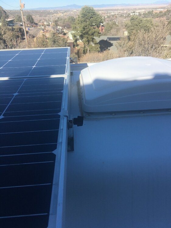

Ours is an Elite 2, but also older 2016 hull. Maybe solar on E1 vs. E2 was not different, not sure, but the width is the same, only length differs in the hulls. Your E1 appears to have the same 4 mounts to the roof.

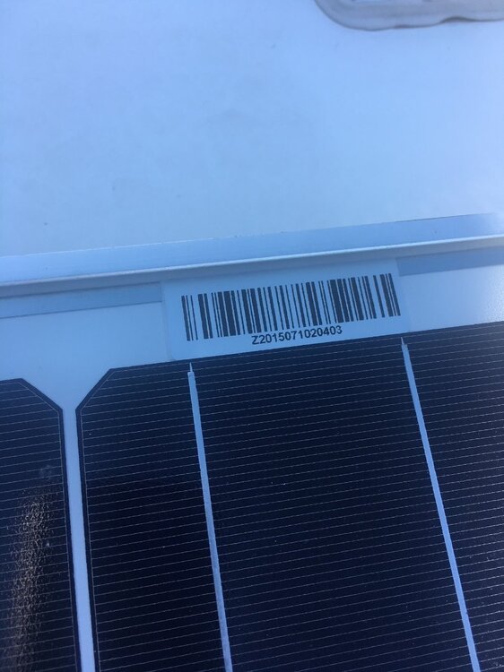

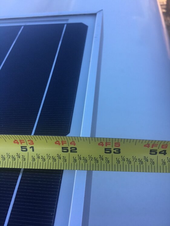

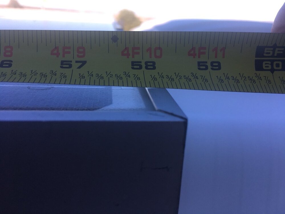

I took some pics recently. If you zoom in on picture Solar3 below you can see the support bar on ours is T-shaped but an L-angle would work fine. I also show measurements. Another pic shows a Zamp serial number. I believe ours are two Zamp 170W panels for 340W total. The 58.25" measurement is the length and the 52.43" is the width of two panels.
This item is likely the current replacement: Amazon.com: Zamp Solar Legacy Series 170-Watt Roof Mount Solar Panel Expansion Kit. Additional Solar Power for Off-Grid RV Battery Charging - KIT1009 : Patio, Lawn & Garden

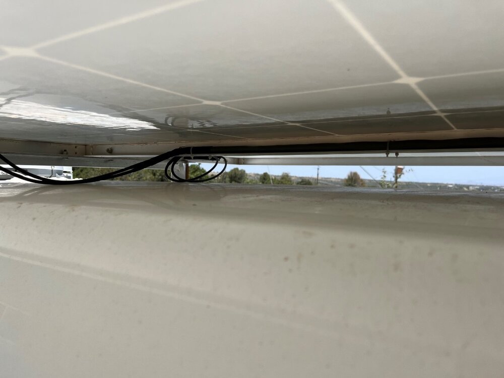

Is there a support bar down the middle between the panels also?
No center support, but the 2 panels are bolted to together along the length.

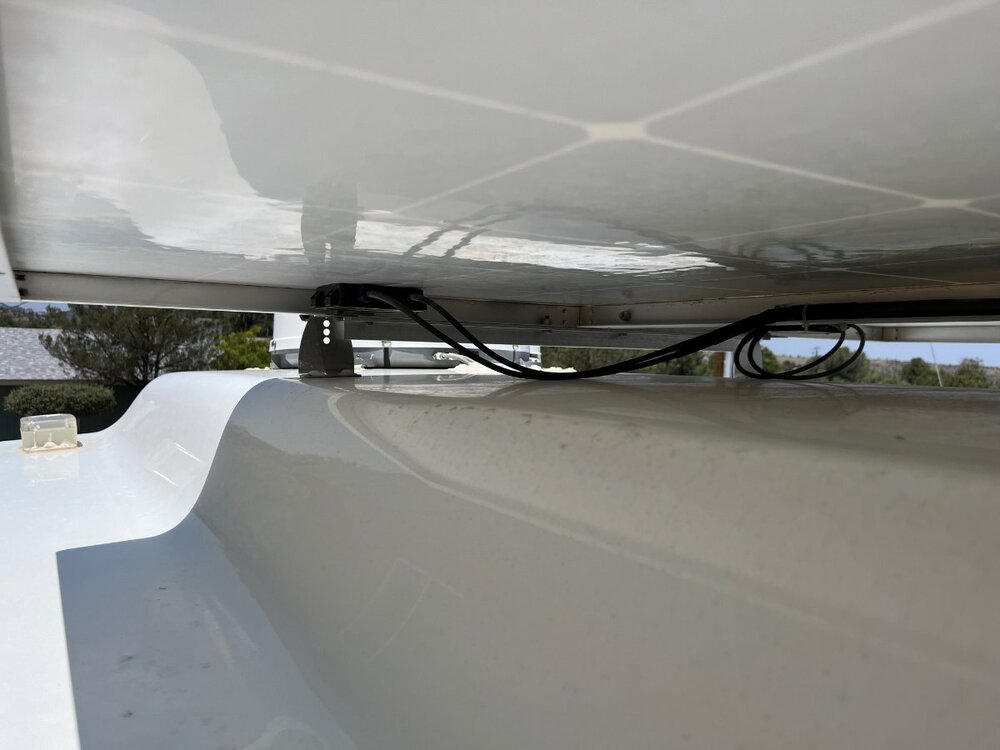

As usual Steve and @mossemi are correct. It is 1" Aluminum angle. mine measured 25", Mossey wrote 26". There is no reason at all (two) 24" pieces would not work. The T-shape I noticed in the above picture was an illusion seeing the mounting bracket.
I just climbed up and measured. The mounts are 27" center-to-center and if yours measure the same (and about 59.5" front to back) then your installation was likely the same as mine. Good time to CLEAN the roof! 🤣
 With these pics you could rebuild yours to match. The two panels do not have a center support. They are just bolted in 5 places, looks like 1/4" HW. Since you're build from scratch, not sure if angle mounts make real sense, but check out this post: HOW TO: Solar panel extension arms. - Ollie Modifications - Oliver Owner Forums (olivertraveltrailers.com)

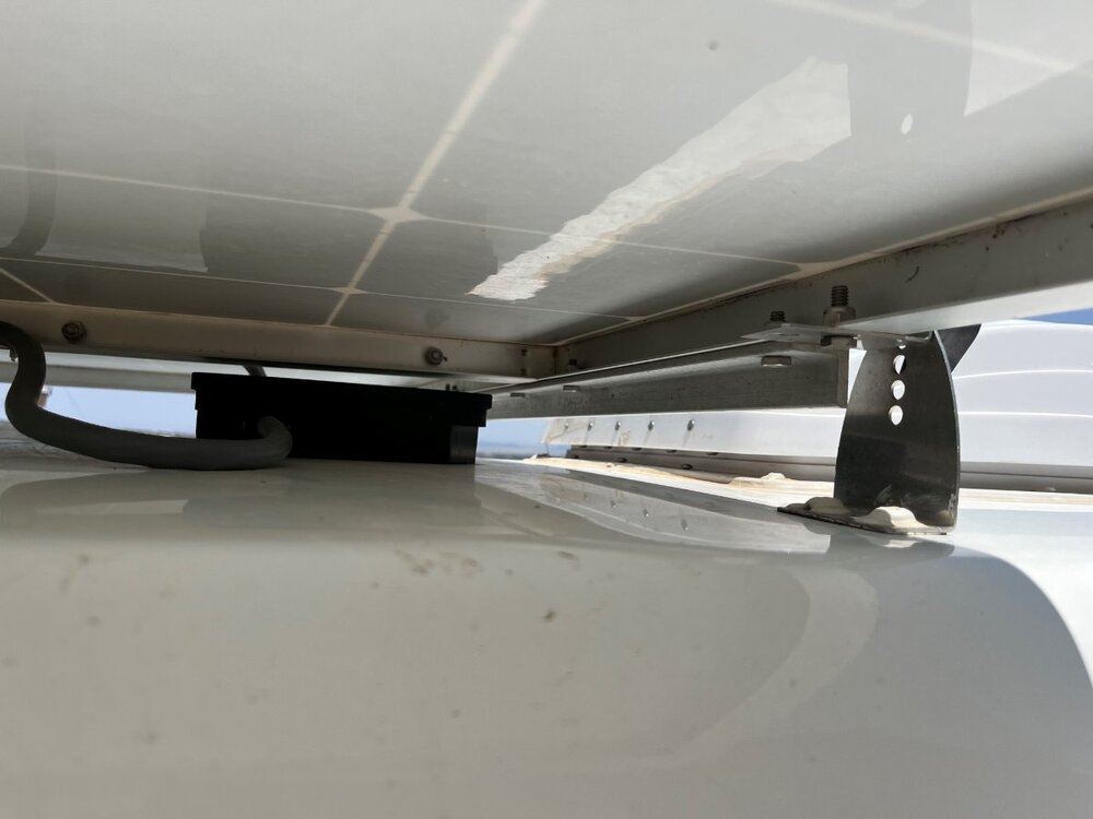

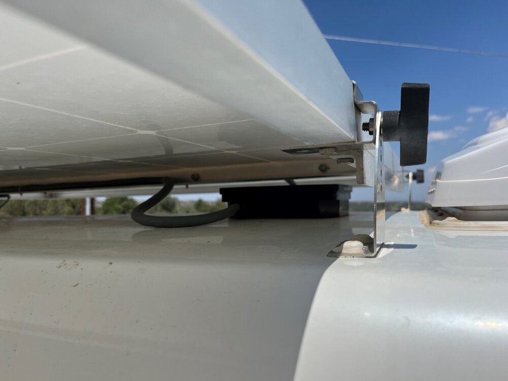

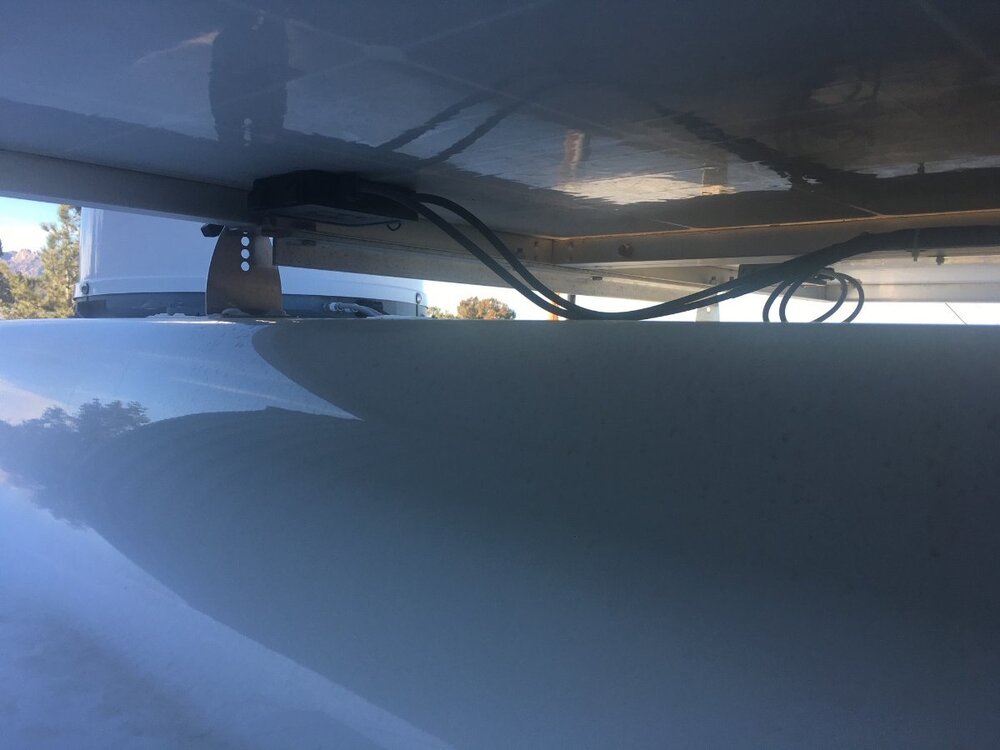

Are the L-shaped aluminum support also bolted to the brackets?  Or, are they just between the brackets? Great info.  Thank you everyone.
Zoom in on pics #1-2 in my post above. They are bolted separately. You can see one bolt into the bracket and behind that 1 of 4 bolts into the L-support. That’s why I wrote a 24” angle support, commonly available, could be used.
