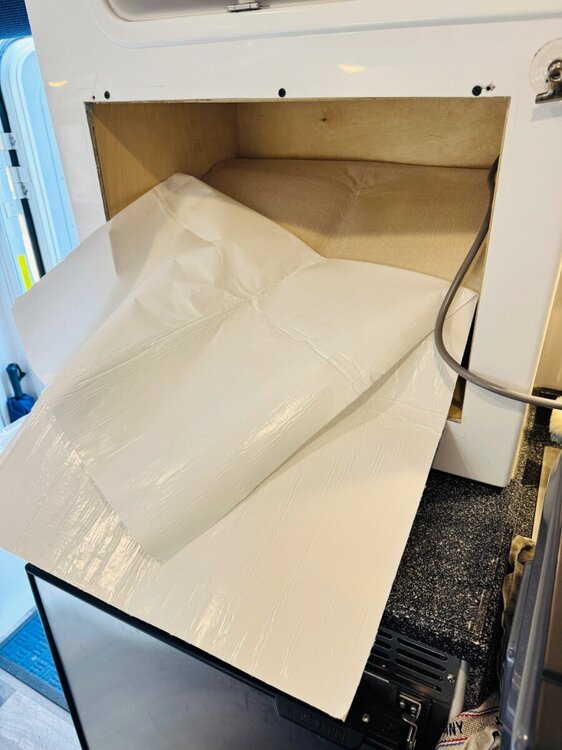

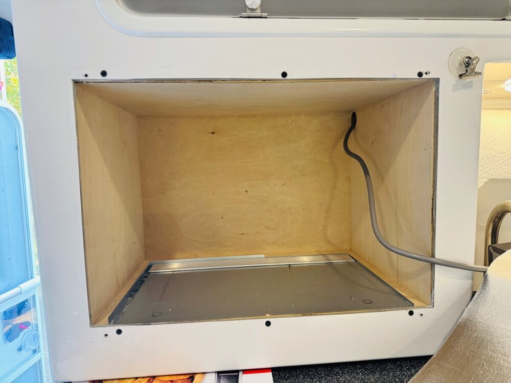

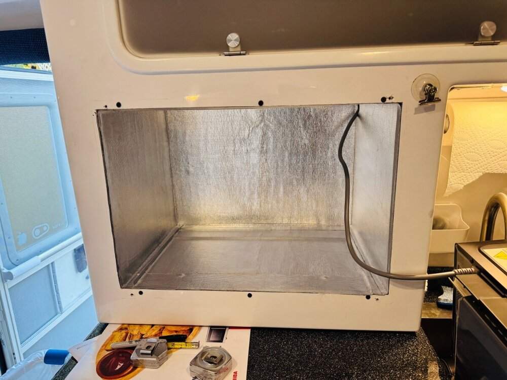

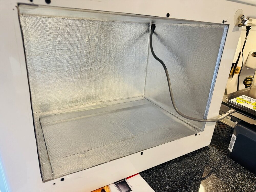

Finally, going to have an oven. I checked the hotspots of the Toshiba MW/oven and the only place it got warm was the back and on top. So I decided to take the plunge with an abundance of  caution while using it because I really miss: warm cookies, birthday cake, biscuits, pizza, etc.

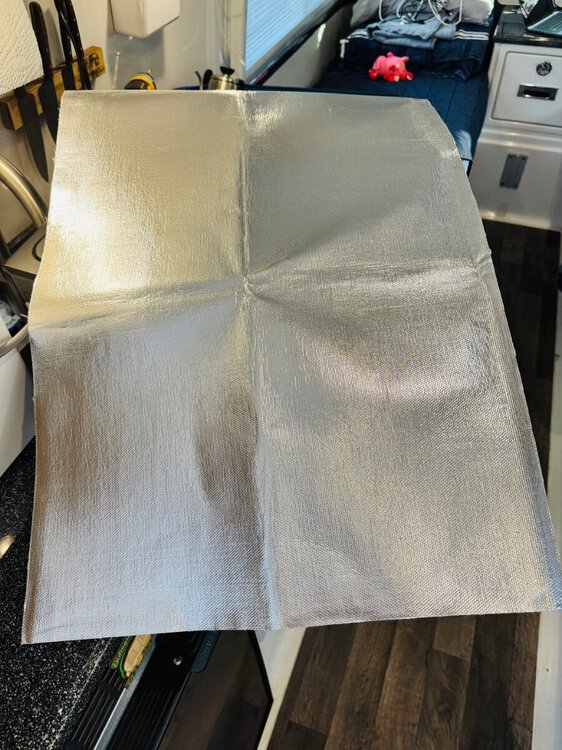

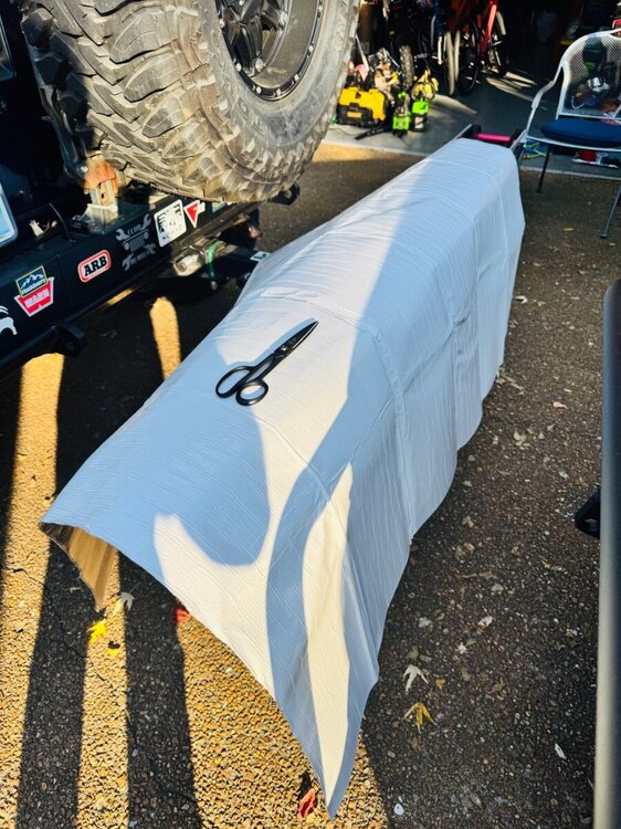

I did line the cabinet with 1 mm adhesive backed fiberglass high heat barrier. Luckily with a little modification I was able to use the old MW SS trim kit. So plug and play essentially. Again, I will be measuring the cabinet temperatures while using. I think the most likely problem may be that the unit gets too hot or prematurely stops working. Although every looks good so far, nothing abnormal or high temps

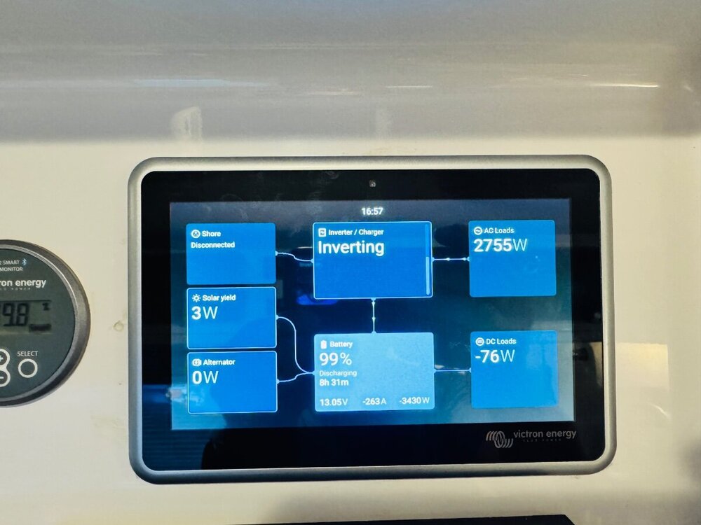

The highest wattage pulled that I saw while using the convection oven and AC on high was around 2800 watts. Will try to only use one at a time though.
Good to hear from you Mike. Another great upgrade in your list of many. Good work and I especially like your thin insulation fabric. Thanks
You may eventually want to add a vent or two. Our 2008 had a vent to the sink side.
Even though we no longer have a microwave,  I still like the vent. When parked, I prop the cabinet door open a bit.
Nice install. Wishing you the best.toshiba makes some great products.
Edited by SeaDawg
I added these both sides.
