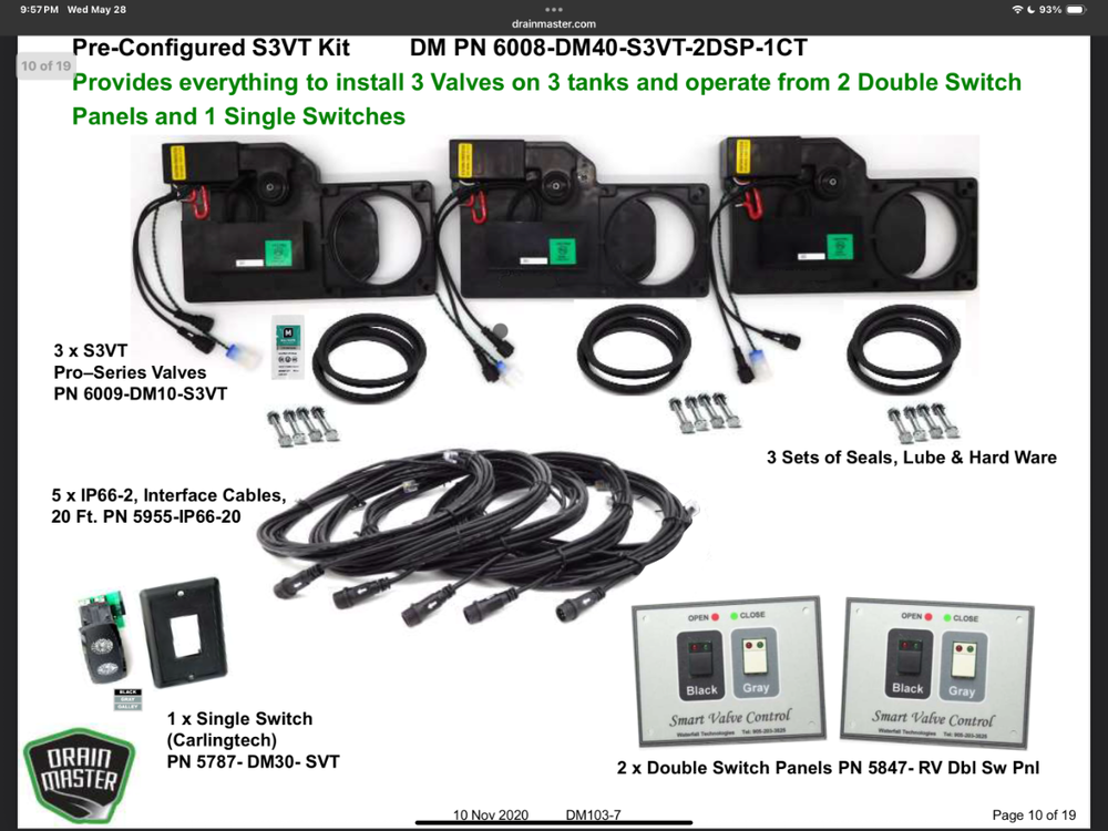

Just talked with both Sharyl’s at Drainmaster.com, very helpful and knowledgeable. Sent them some pics/links and they think all 3 valves will fit. So I just ordered the bundle plus a 1-1/2 in reducer for the grey cutoff and a main cutoff switch. I won’t be back in town for a few weeks but sure look forward to the installation.

Mike, I see there’s 4 options for the drain master 3 valve tank kits, 6029, 6014, 6023 and 6022, which one did you order?
**Sold😞**
I believe the bundle is 6008 but what they told me to do was if you want the ability to control inside and outside order the double S3VT kit with interior and exterior panels. Ext is waterproof. Then order a single kit with just an interior switch for the grey cutoff plus the added reducer they sell. Hope that helps. Give me a min and I will upload the parts list on my invoice.
Here it is:
I added a few extra things that I wanted to try.

Mike @rideadeuce, I'll be looking forward to seeing your installation. As I did, you will likely have to remove your Victron MP2 from the streetside bed area to get to the gray waste valve underneath. The front dinette is much easier to work in, but they had my 1 1/2" gray valve installed right on top of the black waste valve and I had to rework the plumbing to give the new powered valve enough room. Hopefully they installed yours better. Every hull was a one-off back in the day!
