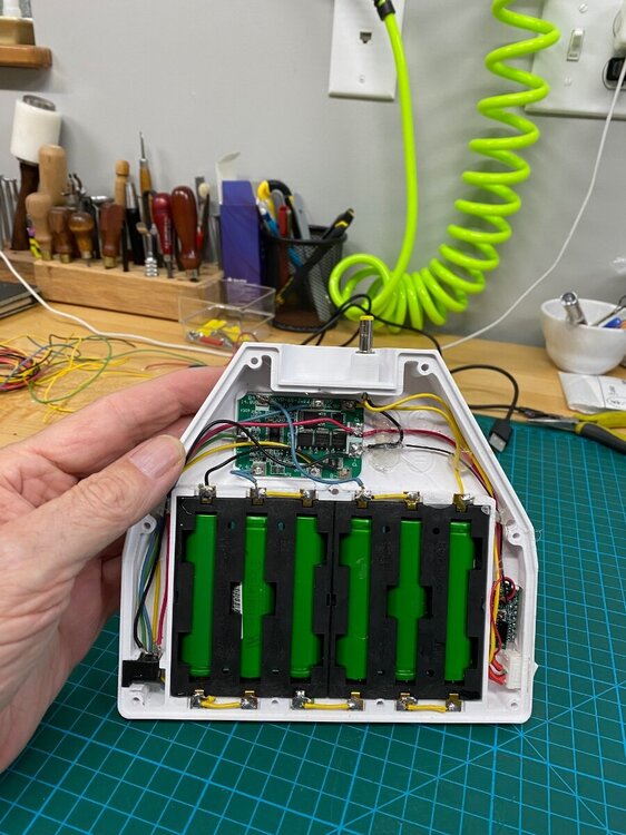

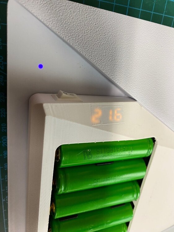

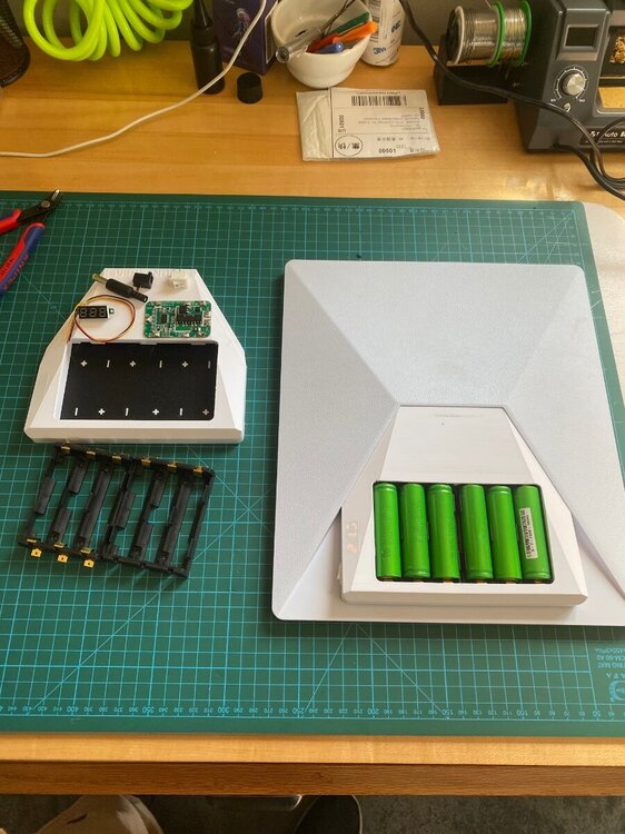

You folks with the Starlink Mini may also be interested in this compact, self-contained Starlink power supply.  It gives the Mini extra portability so you can take it to the campsite of an internet-needy friend, or hiking, or a remote picnic.  It uses six common 18650 rechargeable batteries that will power the Mini for several hours.
This DIY “StarSled Go” was cleverly designed by @Everlanders using a 3D-printed case and electronic components from AliExpress.  It has a power switch, voltage meter, and built-in BMS/equalizing charger.   The case can be printed for a couple of dollars’ worth of filament, and parts are so ridiculously cheap that I built extras for fun and gifts.  Message me if you’re interested in one.

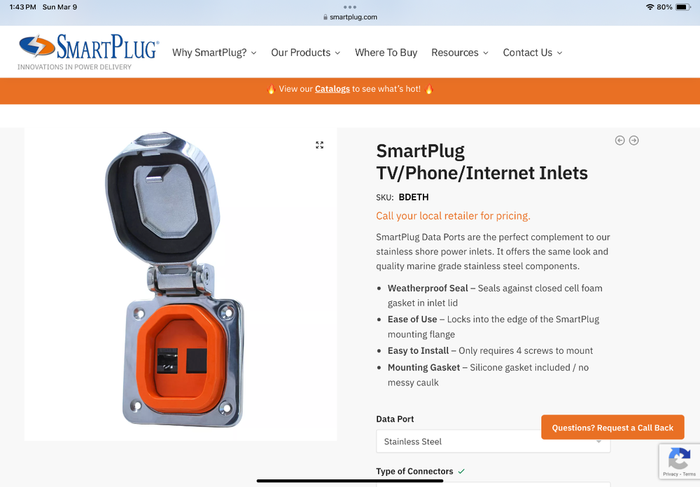

I looked at the SmartPort way back when, and was appalled at the price.  Also it would stick out like a sore thumb on the Oliver.  You can buy another matching Furrion outlet for $9 and a RJ45 panel mount (two) for $16.   Just have to drill the Furrion hole bigger and the RJ45 panel mount will fit right in.  It’s a double female, so any Cat 6 RJ45 patch cord will work on the inside, just fish it up the wall into the attic.  There is a clear path next to the AC drain tube.  Gosh, that photo looks like it's mounted crooked🫢

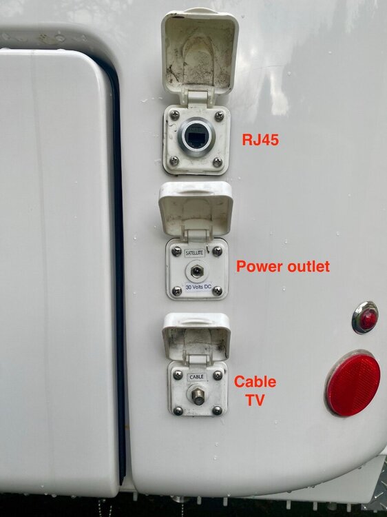

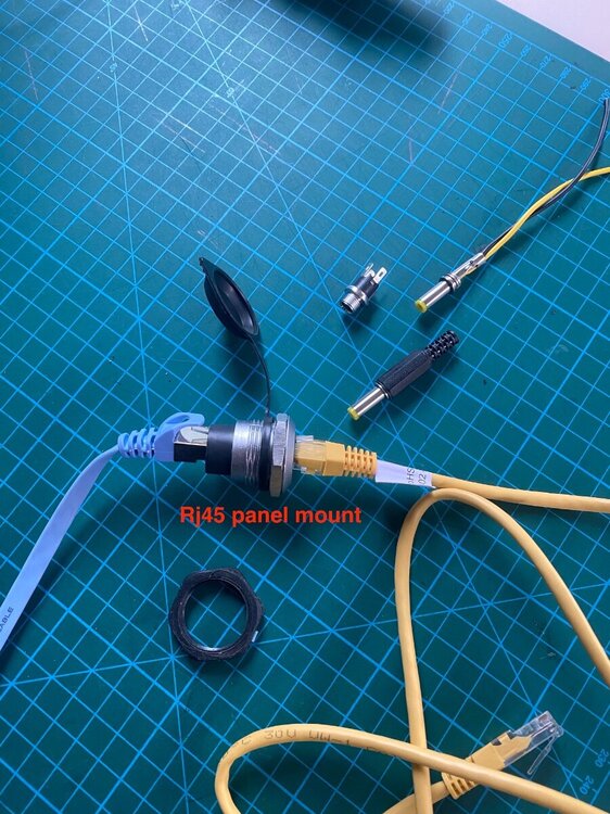

A female 5.5 mm barrel connector will screw into the Furrion without any drilling if you want to go that route.  You can even make your own Starlink Mini power cord from cable, at least #16, and run the Mini without boosting the voltage.

2 hours ago, JT Long said:
I do wonder if I could repurpose the two Furrion TV and Satellite ports instead, one for power and the other for ethernet.

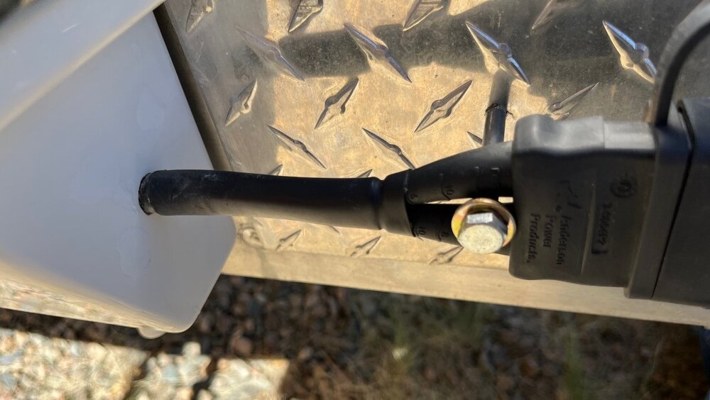

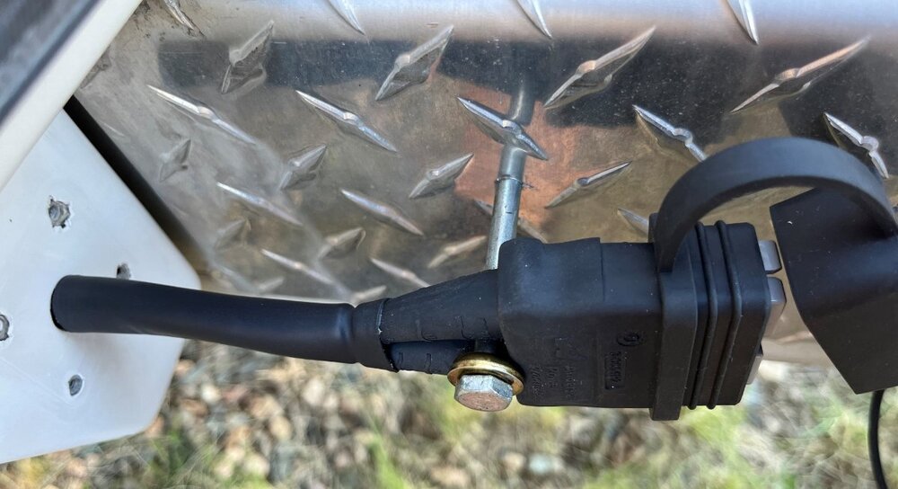

I would repurpose whenever possible vs. drilling new holes in your hull. When adding suitcase solar, instead of adding a new Zamp or SAE port, I repurposed the cable TV port since it was something we would never use. If you do add another outlet, I suggest not drilling the four 1/8" holes. Just use VHB tape or a sealant. It took more work to finish the fiberglass than to build and run the wire harness! 🤣
Edited by jd1923
Nice work JD!  Perfect loss of 4 holes and creative cable stabilization assembly (AKA Bolt).  A+
