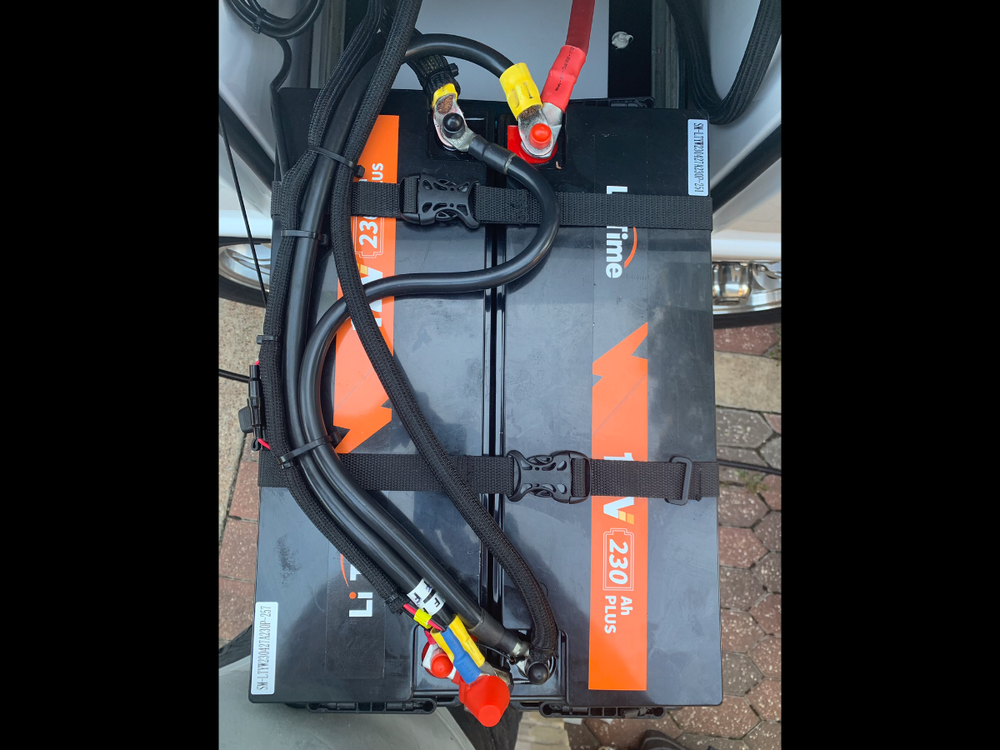

Hi all and thank you all for the good advice in getting a professional to put them in for me. I could easily have dropped a battery. Yiks and then got burned with battery acid ! I just picked my Ollie up from my local trailer place (it is actually a horse trailer repair place I use but same principles)  and got the new 2X 230Ah batteries installed. They fit perfectly in the battery tray. Very pleased!
Looks like you decided on LiTime LFPs, if so good decision! This was my final configuration, also to include a Victron SmartShunt and ANL 250-Amp fuse.
