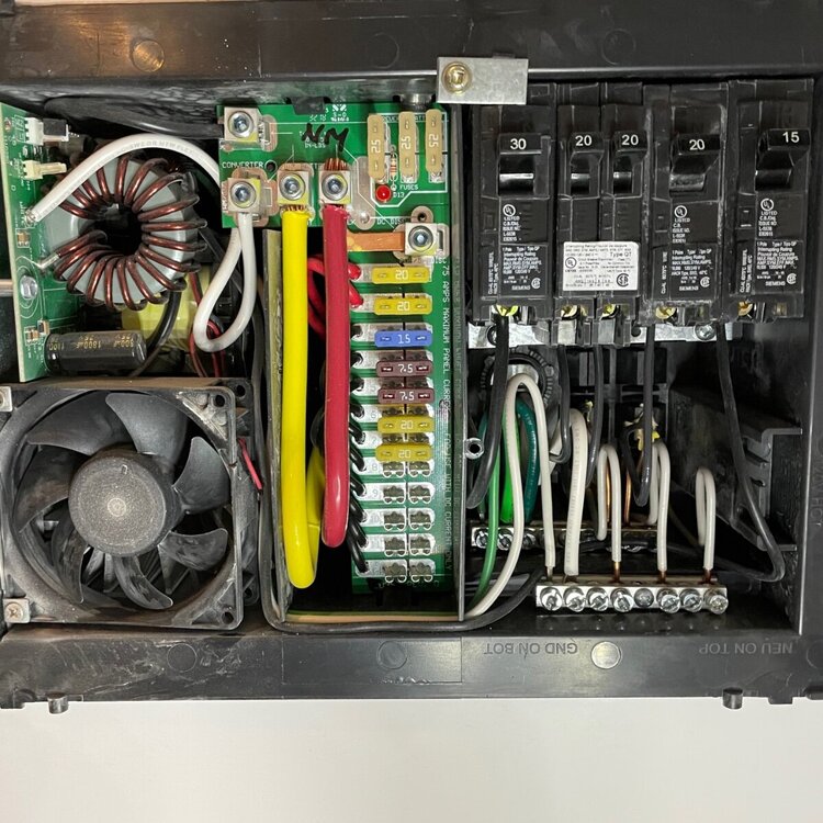

Imelda:
For unit 642 (maybe a 2020 or 2021 model year) first step is determined if your Xantrex is an INVERTER only function or if it's a combo inverter charger.
If your system has a 2000w xantrex inverter/charger then the battery swap is simple.
If not, then you'll currently be using an progressive dynamics charger which is located in the black breaker box (under the dinette seat).
The pix below is the breaker box with the cover removed.
The 12v Charger is in the upper left with the white wire connected to the charging board.

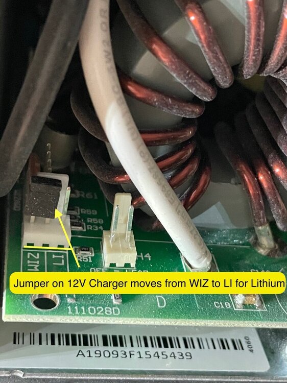

Some folks with the Progressive Dynamics charger see a jumper switch on the charger unit (upper left in overview) for charging lithium.
In the pix below I've zoomed in on the charging board jumpers.
The issue with that LI setting is it's not the "best" way to charge lithiums as it's simply a constant 14.6V voltage...not a ramped profile.
The WIZ setting of the jumper is a PROFILE for AGM or LEAD Acid.
The LI Setting is just 14.6V (no ramp/no profile).
Some battery manufacturers (including Lithionics)  won't warrant their battery in presence of the constant 14.6V no profile setting.
Whichever lithium battery manufacturer you select, LI Time, Epoch, etc....be sure to check what they need as a charging profile.
If a constant 14.6V works for them, then you might be able to a drop in maintaining your existing Inverter and existing charging system.
I know that battle born did warranty their batteries with the Progressive Dynamics chargers.
Also, there are new "Lithium compatible" plug in boards for the progressive dynamics load center that offer a lithium profile wizard.
So just upgrading the charging board in your Progressive Dynamics energy center is a possibility.
Upgrading requires unscrewing that charging board, disconnecting the white wire and sliding in and securing the new charger for LI.
