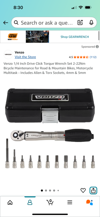

Bike torque wrench I use for electrical.
https://a.co/d/6xEek4l
IMG_4256.thumb.png.d59824a85d496c32b11558aaa6ef04a8.pngIMG_4260.thumb.jpeg.3400bae8295b7312dbdffc46bc10bf9a.jpeg
you probably have any sockets you  need already.
if not here’s one in in-lb with sockets:
https://amzn.to/3G4ja5W
