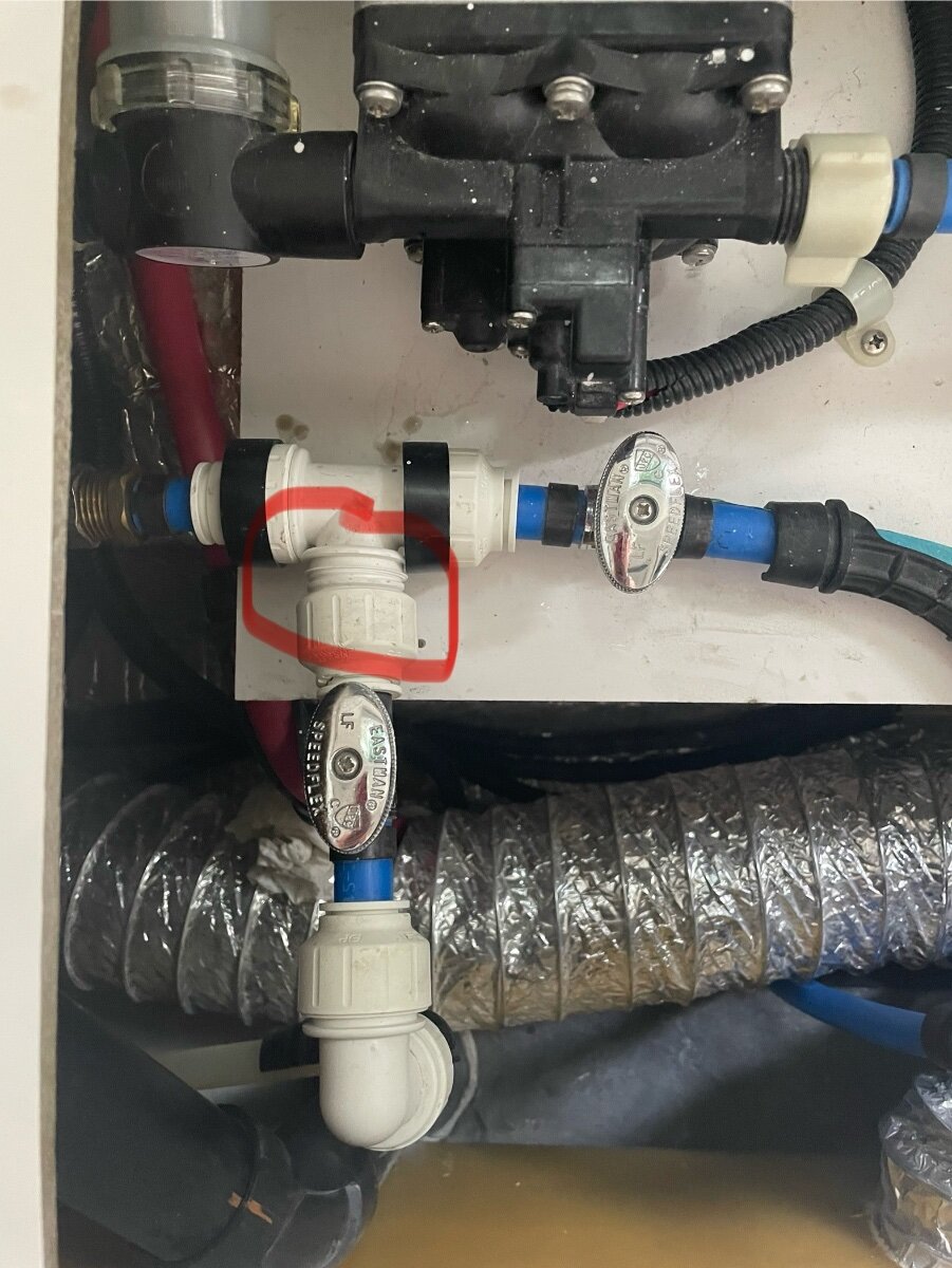

Hull number 747 LE2. 2021. Our water hose has disconnected. I can’t seem to get it to connect to the thread to screw back on. Help?!

We fixed it! The pex tube became unlocked and lengthened resulting in the tube getting in the way of the connector screwing back on.

It also looks like the elbow in your picture is loose as well. Just as a suggestion go through every fitting that you can possibly get to and check them for tightness. They are just hand tightened. I go through mine periodically and I always find one or more a little loose.

It’s always a good idea to ocasdionally check ALL your pex compression fittings for tightness especially during or after a long trip.
Just a little hand snug, no need to over tighten or you risk replacing a cracked fitting.

I just got done with a trip 7,000+ miles. Wife is doing a deep cleaning after 48 days of travel.  When I went by Hohenwald, and met another Owner and learn about the plastic in the lines, and adding flexible line in-between the PEX and the water heater Tee.   So after reading this I decided to check all of the hand tightened fittings.  Every one of the white fittings were loose, so they all got tightened.  I didn't have any leaks luckily. I will have to put this on the maintenance list also.

When we bought our 2021 OEII #802 last month I went through all of the plumbing for orientation and checking for leaks.
Almost all of those threaded connectors were loose. I’ll check them regularly when we’re traveling.

I put 11K miles on this year, some of miles were very rough roads. Arizona and Arkansas were the worst.  I had to tighten all of the white water connectors  two times.  I do not how often this needs to be done or if there is a good fix for them loosening.  It is kind of a pain to remove the latex mattresses.
