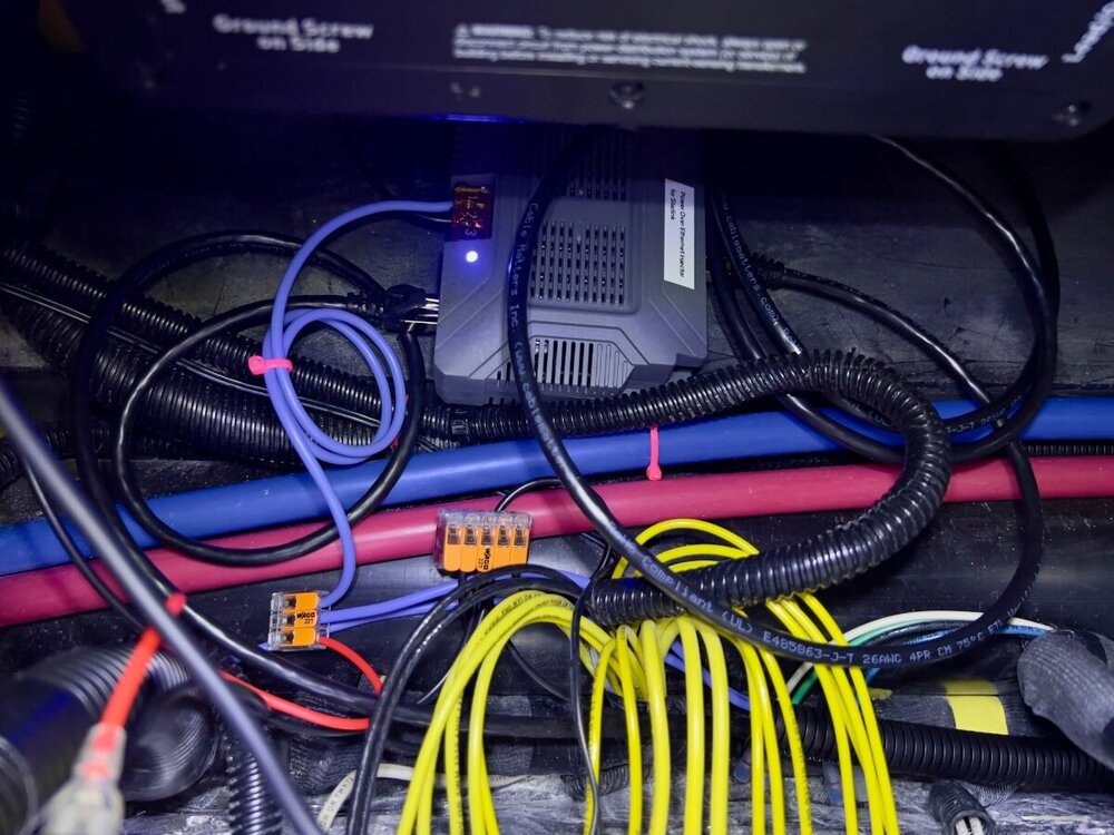

dhaig Posted August 7, 2025 Posted August 7, 2025 (edited) On a recent trip from Dallas to South Carolina we stayed in multiple locations with no (or very limited) communications capabilities (cell phone or WiFi). Over the three years we have owned our LEII, there have been many other occasions with no ability to communicate. As a result, we decided to order a Starlink Mini and a Starlink Router Mini to use on our trailer trips. I have been following Starlink related postings on the OTT Owners Forum, especially since the release of the Starlink Mini. I have found the postings by @Snackchaser particularly helpful in planning the installation of our Starlink system. I especially liked the use of a Power over Ethernet (PoE) injector to power the Starlink Mini and to provide an Ethernet connection from the built-in router back to the trailer, using a single cable. Installing the PoE injector and a DC powered router in the attic of the LEII seemed a reasonable location, being nearly directly above the exterior Furrion ports for connecting satellite and cable TV. So I planned to install in a similar location in the attic of our LEII, assembling a list of the components required. I ordered a PoE injector from MobileMustHave.com and the rest from Amazon. Once all the key components had been delivered, I began the installation, with the first step being to replace the Furrion Satellite coax port with an RJ45 pass-through connector and to fish an Ethernet cable from the basement to the attic. Replacing the Furrion coax connector with the RJ45 pass-through connector was no problem, even though enlarging the hole through fiberglass exterior shell was required. However, fishing an Ethernet cable from the basement to the attic proved to be a major obstacle. Although I have prior experience fishing wires through difficult spaces, I was unsuccessful getting a fish tape (or rods) from the attic to the basement. I could get the end of the fish tape rods down near the ceiling of the basement, where the interior shell ends and multiple cables run up to the attic area at the rear of the trailer, but not into the basement. As suggested, I tried following the A/C drain line and multiple other locations but could not get past the bottom of the inner shell into the basement. I tried running the fish tape/rods in both directions. No luck. Consequently, I began to ponder other installation locations inside the trailer for the PoE injector and Starlink Router Mini. After a couple of days, I had an Aha! moment- install the PoE Injector and Router Mini under the rear dinette seat. I inspected the space between the basement and the rear dinette seat, nearly all of which is readily accessible from the two rear street side hatches and the rear dinette seat hatch. Only the space under the battery compartment is not accessible from directly above, but is easily accessed from either side. I looked for any obstacles to using this location and found none. I could easily route the Ethernet cable from the Furrion/RJ45 pass-through connector forward to beneath the rear dinette seat. I located the PoE Injector atop the trailer frame member, just below the Progressive surge protector box, which is mounted on the aisle wall of the rear dinette seat. The PoE jack and the power terminals of the PoE Injector are positioned toward the front of the trailer. I connected a 20 foot shielded Cat 6 cable from the inner side of the Furrion/ RJ45 port, then routed it under the floor of the basement, around the street side rear stabilizer, then following the waste water line, forward to the area under the rear dinette hatch. About 3 feet of excess cable are coiled in the basement, concealed by the rear wall of the basement. I installed a lighted rocker switch through the forward basement wall, mounted high, almost directly above the side-to-side bubble level on the left side of the basement entry. This switch is to control 12VDC power to the PoE Injector and the Starlink Router Mini. Using 14 AWG silicone coated wire, I ran two purple colored wires from the space beneath the rear dinette hatch back to the rocker switch on the forward basement wall. A third, 14 AWG black wire was also run along the same route to the rocker switch. The switch has two terminals with red lead wires,: one to the DC power source and one to the load. The third terminal has a black wire, which connects to ground (the bus bar). The ground wire enables the light on the switch to operate when DC power is ON. On the DC power panel, position 15, I installed a 15 amp fuse. One of the purple wires connects to the 12VDC positive terminal on the PoE Injector. The other purple wire connects to position 15 on the rear of the DC power panel, using a crimp on connector. The single black wire from the switch connects to the ground bus located under the rear dinette seat. Another 14 AWG wire connects the PoE Injector negative terminal with the other end connecting to the bus bar. All wire-to-wire connections were made using Wago lever lock connectors. I also added a 12VDC auxiliary power outlet (cigarette lighter type) which is connected to the same circuit as that which powers the PoE Injector. An Anker 323 USB-C Car Charger Adapter (USB Power Delivery (PD) capable) plugs into the auxiliary power outlet. A USB-C to Male to DC 3.5 x 1.35mm Male Power Jack is used to power the Starlink Router Mini from the Anker charger. I found the Starlink Router Mini conveniently fits on top of the Progressive Surge Protector box. I later secured it with a releasable zip tie around the surge protector. The 20 foot Cat 6 Ethernet cable from the rear connects to the PoE jack of the PoE Injector. A 5 foot Cat 6 Ethernet cable connects to the LAN jack of the PoE Injector and to the WAN/Satellite port of the Starlink Router Mini. All Cat 6 Ethernet cables used are shielded. I believe this installation location approach has several advantages over an attic installation: Access is MUCH easier. Fishing wires is no challenge. A dedicated circuit from the DC power panel provides power to all Starlink related components. A lighted switch for the PoE Injector and Starlink Router Mini is located in the basement, near the exterior pass-through Ethernet jack. The PoE Injector is located where it cannot be covered by clothing or other cargo stored in the attic which might cause overheating. The VERY bright blue light on the PoE Injector is not visible in the cabin (always ON if power to the PoE Injector is ON). The Starlink Router Mini is located centrally in the trailer and should provide uniform WiFi coverage within the trailer. We have not yet taken the Starlink on a shakedown trip, but plan to do so at the end of August. Regards, Don Edited August 7, 2025 by dhaig add photos 5 5 1 North Texas | 2022 LEII, Hull #990, delivered 2/17/22 | 2014 BMW X5 35d

Steve Morris Posted August 8, 2025 Posted August 8, 2025 Don, Excellent timing on this post! After two years, I'm finally mounting the cellular/wifi antenna on my roof rather than rely on the stubby antennas on my Pepwave cellular router. At the same time, I'm adding the Mobile Must Have POE injector for the Starlink Mini, and converting the exterior port to RJ45. I'll be mounting the POE injector similar to your setup, and adding the power switch in the basement is a great idea, as you're already there plugin in the Ethernet cable. Nicely done. I'd really like to move the router to the same area, but there's no way I could route the seven antenna cables down there! Plus, they are not long enough. So I'll run a short Ethernet cable from the port to the POE injector, and then a longer Ethernet cable to the back of the basement, up along the nightstand somewhere, and then up behind the rear window shade and into the television port. Only a couple inches of the cable would be visible, which I can live with. It will then go into the WAN port on the Peplink to feed the Apple TV and security camera hub connected to the LAN ports. Any more, and I'm going to need a network switch! When I ordered the POE injector, I also added the optional Pepwave 12V connector, eliminating needing to power both devices separately. With the POE injector in the bilges, I won't be needing that connector, but gain the feature of the exterior switch to power the POE injector separately. That's even better! Thanks for the details. Switch and RJ45 port are on order now. 2 ----- Steve - Northern Ohio, USA Wandering around on occasion, always lost. 2021 Toyota Land Cruiser - 2023 Oliver Elite II Twin Hull #1360 “Curiosity” Facebook - Instagram Camped in Curiosity = Green —— Visited with Curiosity = Gray

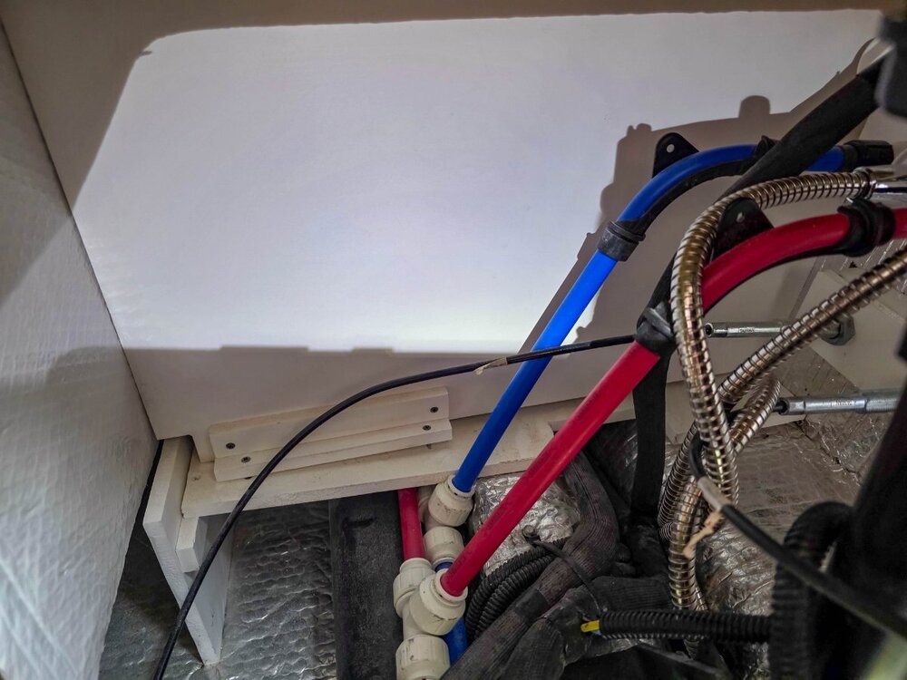

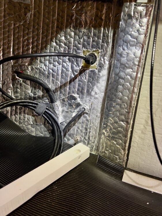

dhaig Posted August 11, 2025 Author Posted August 11, 2025 @johnwen, my apologies, I thought I had included the details on the Ethernet cable running from the RJ45 through jack utilizing the Furrion external shell. All of the Ethernet cables I purchased are Cable Matters products. All are shielded Cat 6A. In addition to the 20 ft. cable used inside the trailer, I purchased a 50 ft, and 2x 25 ft. cables and a single 1ft cable. I also purchased VCE CAT6A Waterproof RJ45 Coupler IP68, 10Gbps CAT6A/CAT6/CAT5E/CAT5 Female-to-Female Outdoor Ethernet Connector Shielded, Network Cable Extender for Outdoor Use 2-Pack, 5.3 in. To connect the Ethernet cable to the PoE splitter, I had to slightly trim the black plastic anti-snag protector on the 1 foot long Cat 6A able. This was necessary because of the tight fit through the watertight connector on the PoE splitter. You may have run across mentions of this issue by others online who are using this PoE Injector and Splitter. Once I trimmed the soft plastic cover over the cable release tab I was able to fit the RJ45 connector through the watertight connector on the Splitter. I chose to use the 1 foot long cable so that I could leave the splitter and the 1 foot cable connected to Starlink Mini. I find the connectors going to the Mini from the Splitter to be difficult to remove due to the watertight seals. I don't like the idea of pulling on the cables to release the Splitter from the Mini. I anticipate repeated removal of the Splitter from the Mini will result in damage to the cables on the Splitter. Replacement Splitters appear to cost about $65. At the other end of the 1 foot cable I attached one half of the VCE RJ45 couplers listed above. This way it is much easier to disconnect the Ethernet cable from the Mini without messing with the watertight connector on the Splitter again. I also installed the VCE couplers on the ends of the 50 foot and 2x 25 foot cables. This way they are like extension cords which are easily connected/dis-connected. I am impressed with the VCE couplers. They are excellent and easy to use. I bought the three longer length cables to be able to easily connect 25, 50, 75 and 100 foot long cables, as needed. I specifically want to avoid having to deal with a single 100 foot cable, which I find to be a PITA. I have not yet had a chance to use the Starlink Mini on a trip, but have only tested it with our LEII parked in our driveway. Due to tree coverage, I needed to connect at least 75 feet of Ethernet cable to position the Mini for a reasonably unobstructed view of the sky. The Mini still had some obstructions, but I was able to measure Ethernet speeds inside the trailer >100 Mbps. I sometimes saw speeds drop to the 50-75 Mbps and rise as high as 200+ Mbps. I suspect the variable is at least partially attributable to the position of Starlink satellites at the time of the speed tests. The satellites are each only in view 8-9 minutes, without obstructions. In any case, I connected my laptop to Starlink WiFi inside the trailer and was able to browse comfortably. I did not notice the occasional losses of service which I noticed in the performance data on the Starlink app. I don't recall any RV park or state park where the provided WiFi was anywhere close to the minimum speeds I have observed in our driveway. BTW, in our residence we have AT&T wired gigabit Ethernet throughout, so I have a low tolerance for poor WiFi service. I have high expectations for using the Starlink service, based on reports by others and my experience so far. At this point, I have not used any adhesive to attach the PoE Injector to the top of the frame member on which it sits. I have a small zip tie connecting it to a PEX cold water line. With the Ethernet cables attached it cannot really go anywhere. I did not want to use a more permanent method to secure the PoE Injector, until field testing on a road trip. We have our next trip scheduled in late August, so I will observe it over a 400+ mile trip. I will likely use a small strip of 3M VHB tape to fasten to the hard rubber frame covering. Good luck with your installation. If you have any questions, feel free to send me a Personal Message and I will be happy to answer. 2 North Texas | 2022 LEII, Hull #990, delivered 2/17/22 | 2014 BMW X5 35d
johnwen Posted August 11, 2025 Posted August 11, 2025 33 minutes ago, dhaig said: At this point, I have not used any adhesive to attach the PoE Injector to the top of the frame member on which it sits Don, The reason I asked was we are only 6 numbers apart on our hull #'s so the same person probably worked on our Progressive surge protector box but mine is either upside down or the cover had been taken off for maintenance and reinstalled upside down...makes it a little easier to read from the top :) Makes no difference either way but since there is that difference I'm wondering if there is anything else different down there. You mentioned "hard rubber frame covering" but that area, in mine, appears to be the top of the gray water tank and before I investigated I was planning to possibly drill in that area to attach. I'll probably find another location since there seems to plenty of possibilities. Our mini is working very well and definitely recommend as others do. Out POE injector/converter is on the way...yay! I'll tackle this project soon. Ditto on the couplers. Thanks much, John 2022 Oliver II #996 "Bessie", 2019 Silverado LTZ 5.3, Veterans https://wenandjohnsadventure.com/

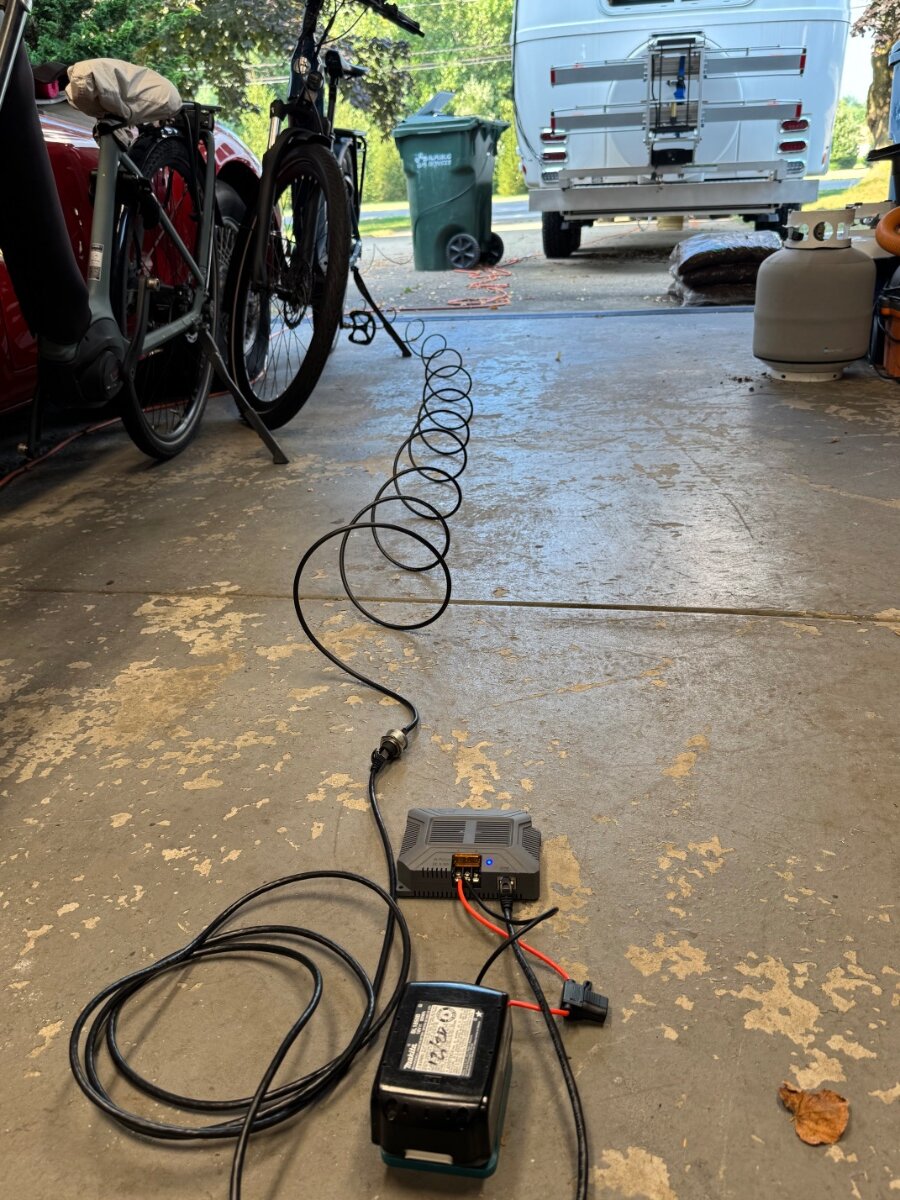

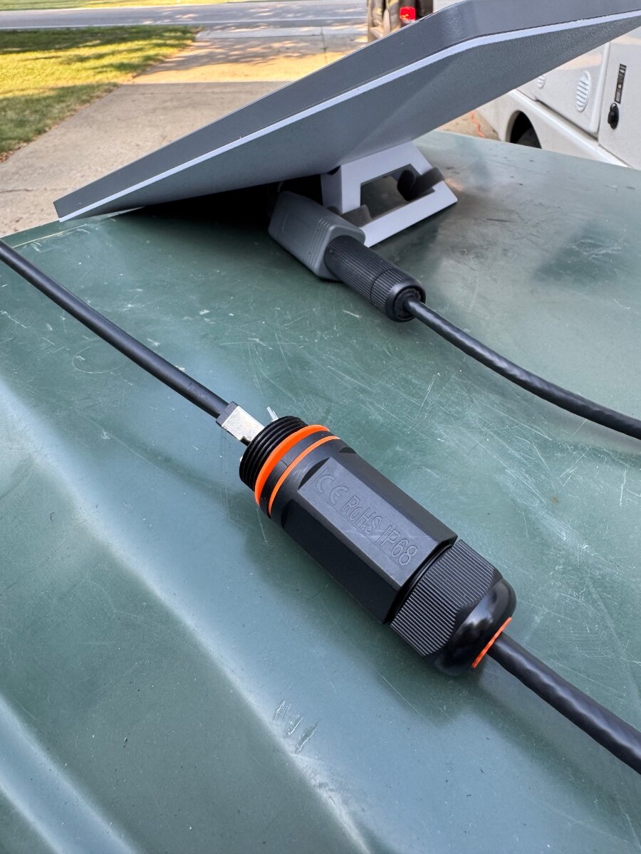

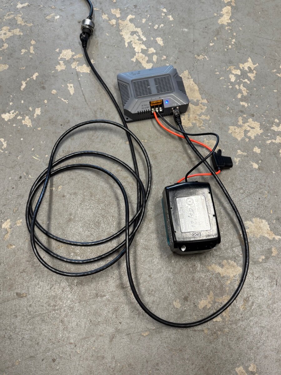

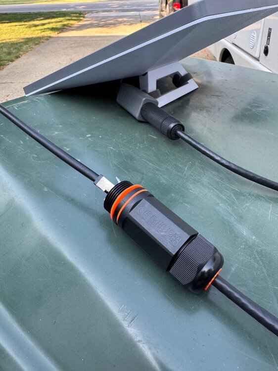

Steve Morris Posted August 12, 2025 Posted August 12, 2025 @dhaig Thanks again for the tips. I received all of the POE bits, so mocked it up in the garage. Makita battery powering POE box -> thru-hull port -> 50’ Cat 6 shielded cable-> waterproof junction-> Splitter -> Starlink Mini. I really appreciate the idea of adding the short cable from the splitter that will make assembly easier. Once installed there will be a Cat6 cable from the POE box to my cellular router, and will be connected like you did utilizing the new switch in the basement. Works like a charm! Thank you, and everyone who contributed before! ----- Steve - Northern Ohio, USA Wandering around on occasion, always lost. 2021 Toyota Land Cruiser - 2023 Oliver Elite II Twin Hull #1360 “Curiosity” Facebook - Instagram Camped in Curiosity = Green —— Visited with Curiosity = Gray
dhaig Posted August 13, 2025 Author Posted August 13, 2025 @johnwen, my apologies, I thought I had included the details on the Ethernet cable running from the RJ45 through jack utilizing the Furrion external shell. All of the Ethernet cables I purchased are Cable Matters products. All are shielded Cat 6A. In addition to the 20 ft. cable used inside the trailer, I purchased a 50 ft, and 2x 25 ft. cables and a single 1ft cable. I also purchased VCE CAT6A Waterproof RJ45 Coupler IP68, 10Gbps CAT6A/CAT6/CAT5E/CAT5 Female-to-Female Outdoor Ethernet Connector Shielded, Network Cable Extender for Outdoor Use 2-Pack, 5.3 in. To connect the Ethernet cable to the PoE splitter, I had to slightly trim the black plastic anti-snag protector on the 1 foot long Cat 6A able. This was necessary because of the tight fit through the watertight connector on the PoE splitter. You may have run across mentions of this issue by others online who are using this PoE Injector and Splitter. Once I trimmed the soft plastic cover over the cable release tab I was able to fit the RJ45 connector through the watertight connector on the Splitter. I chose to use the 1 foot long cable so that I could leave the splitter and the 1 foot cable connected to Starlink Mini. I find the connectors going to the Mini from the Splitter to be difficult to remove due to the watertight seals. I don't like the idea of pulling on the cables to release the Splitter from the Mini. I anticipate repeated removal of the Splitter from the Mini will result in damage to the cables on the Splitter. Replacement Splitters appear to cost about $65. At the other end of the 1 foot cable I attached one half of the VCE RJ45 couplers listed above. This way it is much easier to disconnect the Ethernet cable from the Mini without messing with the watertight connector on the Splitter again. I also installed the VCE couplers on the ends of the 50 foot and 2x 25 foot cables. This way they are like extension cords which are easily connected/dis-connected. I am impressed with the VCE couplers. They are excellent and easy to use. I bought the three longer length cables to be able to easily connect 25, 50, 75 and 100 foot long cables, as needed. I specifically want to avoid having to deal with a single 100 foot cable, which I find to be a PITA. I have not yet had a chance to use the Starlink Mini on a trip, but have only tested it with our LEII parked in our driveway. Due to tree coverage, I needed to connect at least 75 feet of Ethernet cable to position the Mini for a reasonably unobstructed view of the sky. The Mini still had some obstructions, but I was able to measure Ethernet speeds inside the trailer >100 Mbps. I sometimes saw speeds drop to the 50-75 Mbps and rise as high as 200+ Mbps. I suspect the variable is at least partially attributable to the position of Starlink satellites at the time of the speed tests. The satellites are each only in view 8-9 minutes, without obstructions. In any case, I connected my laptop to Starlink WiFi inside the trailer and was able to browse comfortably. I did not notice the occasional losses of service which I noticed in the performance data on the Starlink app. I don't recall any RV park or state park where the provided WiFi was anywhere close to the minimum speeds I have observed in our driveway. BTW, in our residence we have AT&T wired gigabit Ethernet throughout, so I have a low tolerance for poor WiFi service. I have high expectations for using the Starlink service, based on reports by others and my experience so far. At this point, I have not used any adhesive to attach the PoE Injector to the top of the frame member on which it sits. I have a small zip tie connecting it to a PEX cold water line. With the Ethernet cables attached it cannot really go anywhere. I did not want to use a more permanent method to secure the PoE Injector, until field testing on a road trip. We have our next trip scheduled in late August, so I will observe it over a 400+ mile trip. I will likely use a small strip of 3M VHB tape to fasten to the hard rubber frame covering. Good luck with your installation. If you have any questions, feel free to send me a Personal Message and I will be happy to answer. 2 North Texas | 2022 LEII, Hull #990, delivered 2/17/22 | 2014 BMW X5 35d

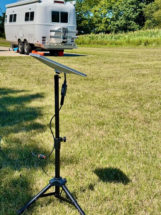

Steve Morris Posted August 13, 2025 Posted August 13, 2025 12 hours ago, dhaig said: I like your base for the Starlink Mini. It certainly keeps it off the ground. 😀 It is a nice addition to my system, and has an inbuilt angled surface for easy alignment. But the subscription fee is $23.86/month! 🤣 I have a tripod adaptor for any of my several tripods, and I'm waiting to see what Flagpole Buddy's Labor Day sale is going to be. 1 ----- Steve - Northern Ohio, USA Wandering around on occasion, always lost. 2021 Toyota Land Cruiser - 2023 Oliver Elite II Twin Hull #1360 “Curiosity” Facebook - Instagram Camped in Curiosity = Green —— Visited with Curiosity = Gray
dhaig Posted August 13, 2025 Author Posted August 13, 2025 @Steve Morris I purchased the same tripod adapter. It works quite well. We have an old aluminum tripod which I plan to use as the primary support for our Mini. 2 North Texas | 2022 LEII, Hull #990, delivered 2/17/22 | 2014 BMW X5 35d

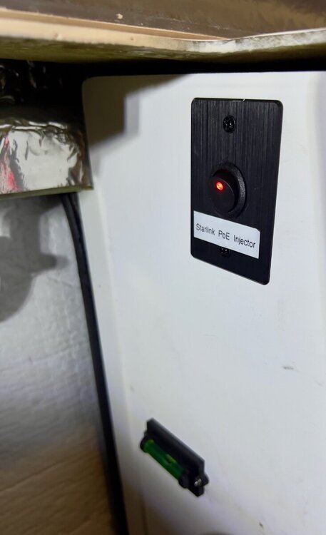

johnwen Posted August 17, 2025 Posted August 17, 2025 Don, Do you see any problems with mounting the POE injector on the basement wall where you put the lighted rocker switch? My wall is between 5/8 and 3/4 inches thick. Thanks, John 2022 Oliver II #996 "Bessie", 2019 Silverado LTZ 5.3, Veterans https://wenandjohnsadventure.com/
Steve Morris Posted August 18, 2025 Posted August 18, 2025 (edited) 13 hours ago, johnwen said: Don, Do you see any problems with mounting the POE injector on the basement wall where you put the lighted rocker switch? My wall is between 5/8 and 3/4 inches thick. Thanks, John That’s what I ended up doing. I made up a wiring harness with the switch and cable to run to the fuse box, and fed it through the switch hole. Then connected to the POE injector mounted just beside where the wires came through. It worked well for me. Edited August 18, 2025 by Steve Morris 1 1 ----- Steve - Northern Ohio, USA Wandering around on occasion, always lost. 2021 Toyota Land Cruiser - 2023 Oliver Elite II Twin Hull #1360 “Curiosity” Facebook - Instagram Camped in Curiosity = Green —— Visited with Curiosity = Gray
johnwen Posted August 18, 2025 Posted August 18, 2025 (edited) 4 hours ago, Steve Morris said: That’s what I ended up doing. I made up a wiring harness with the switch and cable to run to the fuse box, and fed it through the switch hole. Then connected to the POE injector mounted just beside where the wires came through. It worked well for me. Thanks Steve, Seems logical...where did you tap into power on the fuse box? I'm about to start this project now that my solar panel issues are resolved. John Edited August 18, 2025 by johnwen 2022 Oliver II #996 "Bessie", 2019 Silverado LTZ 5.3, Veterans https://wenandjohnsadventure.com/
Steve Morris Posted August 18, 2025 Posted August 18, 2025 2 hours ago, johnwen said: Thanks Steve, Seems logical...where did you tap into power on the fuse box? I'm about to start this project now that my solar panel issues are resolved. John Negative wire on the bus bar, and positive on an empty spot in the fuse box with a 10A fuse. 1 ----- Steve - Northern Ohio, USA Wandering around on occasion, always lost. 2021 Toyota Land Cruiser - 2023 Oliver Elite II Twin Hull #1360 “Curiosity” Facebook - Instagram Camped in Curiosity = Green —— Visited with Curiosity = Gray

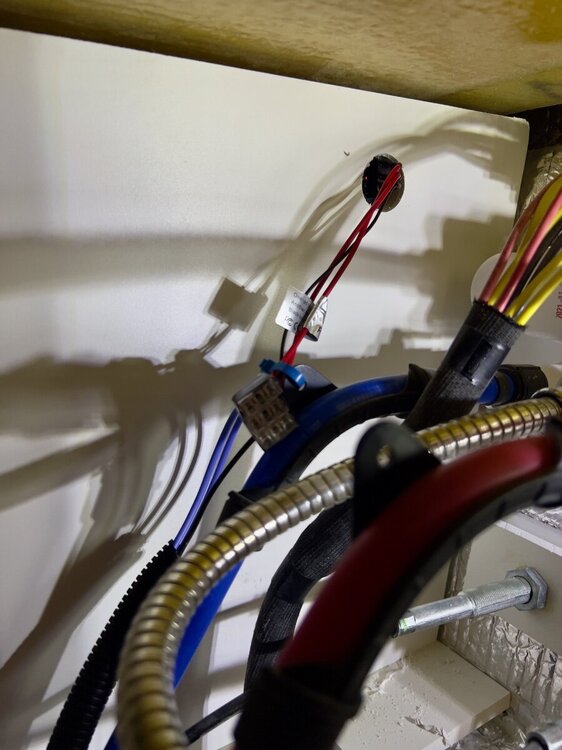

dhaig Posted August 21, 2025 Author Posted August 21, 2025 @johnwen, my apologies for the delayed response to your question about mounting the PoE Injector on the forward wall of the basement, where I located the On/Off Switch. I had not seen your question. I don't see any problem locating the PoE Injector on the wall, as you suggested. I would not mount it on the basement side of the wall, but on the back side of that wall. Drilling holes for the mounting may be challenging from inside the space under the rear street side access hatch. I chose to locate my PoE Injector and Router Mini under the aft dinette seat, since that space is more easily accessible having to move only the seat cushions and not the street side mattress. 1 1 North Texas | 2022 LEII, Hull #990, delivered 2/17/22 | 2014 BMW X5 35d
johnwen Posted August 21, 2025 Posted August 21, 2025 Thanks, Don, I have the Rj46 pass though, lighted wall switch and POE injector mounted and have the backside of the passthrough connected to the POE injector. I'm going to attempt wiring everything together today. I am easily intimidated with wiring things up and wish I had a simple diagram to follow showing connections, but I think I understand enough to keep myself out of trouble...big ha ha! I don't have a second router yet (probably will be a router mini) but I'll wire it in later. Wish me lots of luck :) John 1 2022 Oliver II #996 "Bessie", 2019 Silverado LTZ 5.3, Veterans https://wenandjohnsadventure.com/
johnwen Posted August 21, 2025 Posted August 21, 2025 On 8/18/2025 at 3:30 AM, Steve Morris said: That’s what I ended up doing. I made up a wiring harness with the switch and cable to run to the fuse box, and fed it through the switch hole. Then connected to the POE injector mounted just beside where the wires came through. It worked well for me. Steve, I understand you connected 1 long 14 ga wire between 1 red wire on the lighted switch to an empty slot on the trailer's fuse block and one short wire (since we mounted it close to the switch) to the POE pwr input? Is there more than 1 wire connected at the fuse block for this project? I will probably get the router mini at some point in the future. It looks like Don put the cigarette lighter connection into the circuit for the purpose of powering the router, and I'm guessing that taps into the circuit between the lighted switch and the POE injector in order to turn off everything. John 2022 Oliver II #996 "Bessie", 2019 Silverado LTZ 5.3, Veterans https://wenandjohnsadventure.com/
dhaig Posted August 21, 2025 Author Posted August 21, 2025 @johnwen, your guess was correct. The switch mounted on the forward basement wall connects to what had been a spare circuit on the fuse block via a junction. Three wires are connected by a Wago lever connector: wire from switch wire to the Mini Router wire to the fuse block If you used the same lighted rocker switch as I did, it has three wires, one smaller than the other two. This small wire needs power for the LED light in the switch. Don 2 North Texas | 2022 LEII, Hull #990, delivered 2/17/22 | 2014 BMW X5 35d
johnwen Posted August 21, 2025 Posted August 21, 2025 27 minutes ago, dhaig said: @johnwen, your guess was correct. The switch mounted on the forward basement wall connects to what had been a spare circuit on the fuse block via a junction. Three wires are connected by a Wago lever connector: wire from switch wire to the Mini Router wire to the fuse block If you used the same lighted rocker switch as I did, it has three wires, one smaller than the other two. This small wire needs power for the LED light in the switch. Don Thanks, Don, That gets me goin' :) 2022 Oliver II #996 "Bessie", 2019 Silverado LTZ 5.3, Veterans https://wenandjohnsadventure.com/

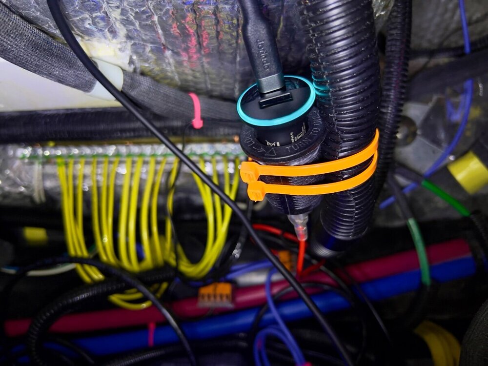

johnwen Posted August 21, 2025 Posted August 21, 2025 (edited) 7 minutes ago, johnwen said: Thanks, Don, That gets me goin' :) Don, One of those wires on the switch side of the junction then goes to the 12VDC auxiliary power outlet (cigarette lighter type) to connect to the future router? On 8/6/2025 at 9:53 PM, dhaig said: Edited August 21, 2025 by johnwen 2022 Oliver II #996 "Bessie", 2019 Silverado LTZ 5.3, Veterans https://wenandjohnsadventure.com/

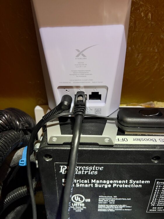

dhaig Posted August 21, 2025 Author Posted August 21, 2025 @johnwen, yes, I neglected to mention the wire I had listed as going to the Mini Router goes to the 12VDC auxiliary power outlet for the Router Mini. A USB-C adapter plugs into the auxiliary power outlet, then USB-C cable to the Mini Router. Sorry for the confusion. The power switch mount on the basement wall controls power to both the PoE Injector and the Router Mini's power supply (USB-C). 1 North Texas | 2022 LEII, Hull #990, delivered 2/17/22 | 2014 BMW X5 35d
Steve Morris Posted August 21, 2025 Posted August 21, 2025 6 hours ago, johnwen said: Steve, I understand you connected 1 long 14 ga wire between 1 red wire on the lighted switch to an empty slot on the trailer's fuse block and one short wire (since we mounted it close to the switch) to the POE pwr input? Is there more than 1 wire connected at the fuse block for this project? I will probably get the router mini at some point in the future. It looks like Don put the cigarette lighter connection into the circuit for the purpose of powering the router, and I'm guessing that taps into the circuit between the lighted switch and the POE injector in order to turn off everything. John Don already answered, but yep, I did what he did but without the cigarette lighter portion. I used 12G wire, because I have a 100' spool. 1 ----- Steve - Northern Ohio, USA Wandering around on occasion, always lost. 2021 Toyota Land Cruiser - 2023 Oliver Elite II Twin Hull #1360 “Curiosity” Facebook - Instagram Camped in Curiosity = Green —— Visited with Curiosity = Gray
