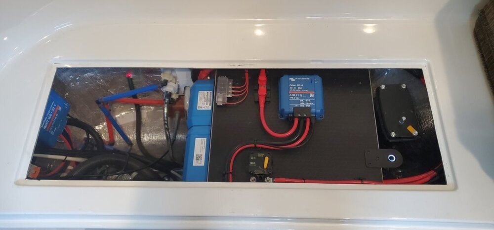

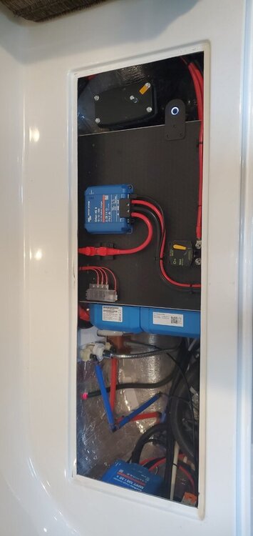

I just completed a Victron update to all the solar components in our trailer, including the Victron 50amp DC-DC charger. It has been great.
I was originally thinking of doing the work myself but soon realized I was too far out of my comfort zone regarding the complexities of the install.
This job I delegated! Expensive, yes. But The job as it was done went way beyond my expectations. I was very lucky to find an outfit locally that really knew what they were doing and take great pride in their work.
The cost of the DC-DC charger was part of a much larger project so hard to break it out. There will be two sides to your install, the TV and your trailer.
I found a way to fish 4awg cables from the streetside rear dining seat (where the battery box is) forward, under the bathroom sink, and then out the front of the trailer next to the 7-pin plug cable. The charger is mounted on top of the battery box. My truck luckily has a battery distribution fuse block with multiple fuses up for grabs including a 60 amp fuse to which the truck-side wiring was attached. The truck wiring terminated with an Anderson plug that was bolted to the underside of my bumper with a custom bracket directly under the 7 pin plug (which is next to my license plate). This location I highly recommend as it makes attaching your fairly large 7 pin and DC-DC charging cables nicely aligned and easier to manage.
I'm getting similar charging profiles as JD iirc. For me, I don't like traveling with propane on, so I switch to DC mode on my fridge when under way. Always have full batteries on arrival! These new lithium batteries charge up fast if they can get the power and this little charger really delivers! Of course, it only works when your running your TV. So, as JD mentioned, this will be of no benefit if boondocking and stationary. That's where your remote solar panels come in to play if you have them. I suppose worst case, you could use your TV as a giant generator to charge your batteries but many campgrounds, especially in the National Park system, or in CG's that don't allow portable generators, this would not be allowed.
Super glad I got the charger, no regrets! 👍👍

Excellent Dave, good to hear! CLEAN installation! From just a couple of pics I can see you found a quality service company, as you mentioned.
For a guy who at first did not want an inverter!!!!! You've come a long way. Your rig, your little E1 has come a long way in off-grid excellence! 🤣
We have found that we can run the fridge AND electric to the hot water heater (HWH) on DC while towing and the Orion XS 50A still adds good charge to the batteries while doing so. Or run the A/C in the last hour or two driving to a campsite with hookups and the DC2DC charger carries a good portion of the load and you arrive cool and calm...
Dave
Thanks, Dave. This is really helpful, especially the thoughts about mounting location for the charger. We have a local (Nashville) outfit that I will have do the job and he has done a couple of Olivers, but probably not an LE I yet so it may be a little different from he other installs. Glad to hear "no regrets". I think this will be a game changer for us considering how we travel.
