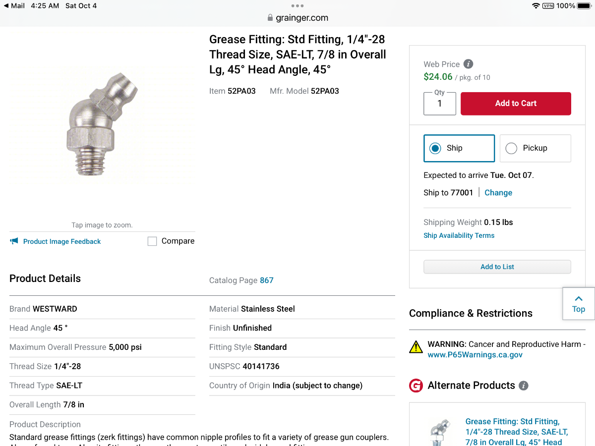

7 hours ago, jd1923 said:
If you replaced your wet-bolts, purchased the HD shackles and wet-bolt setup from Alcan, the Zerk thread size is 1/4"-28. I purchased this 50-pack, zinc-plated steel like OEM (could not easily find brass or SS in this size).
For future reference:
Edited by Ronbrink
2020 OLEll, Twin, 579:
$24 for qty 10, too bad it's not for the dozen (qty 12) required, so total with Grainger would be $48 plus shipping. I'll stick with $10 and Prime shipping for qty 50 zinc-plated steel!
First 2 Oliver friends we run into this winter in the Arizona desert... Just ask me and I'll have a dozen free 45-degree Zerks for you! 😎 (for those with Alcan wet-bolts)

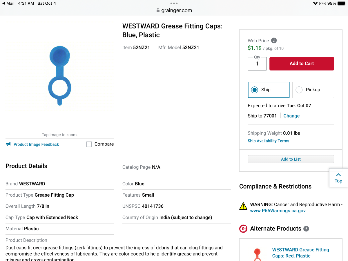

I'm going without the rubber caps this time. The ones I took off seemed to be dirt magnets! I'll do what I've always done, use a brass brush and paper towel, clean them before lubing! I've never seen Zerks capped on a car or truck suspension.
I may follow suit John :)
