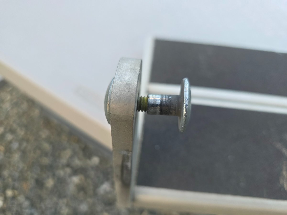

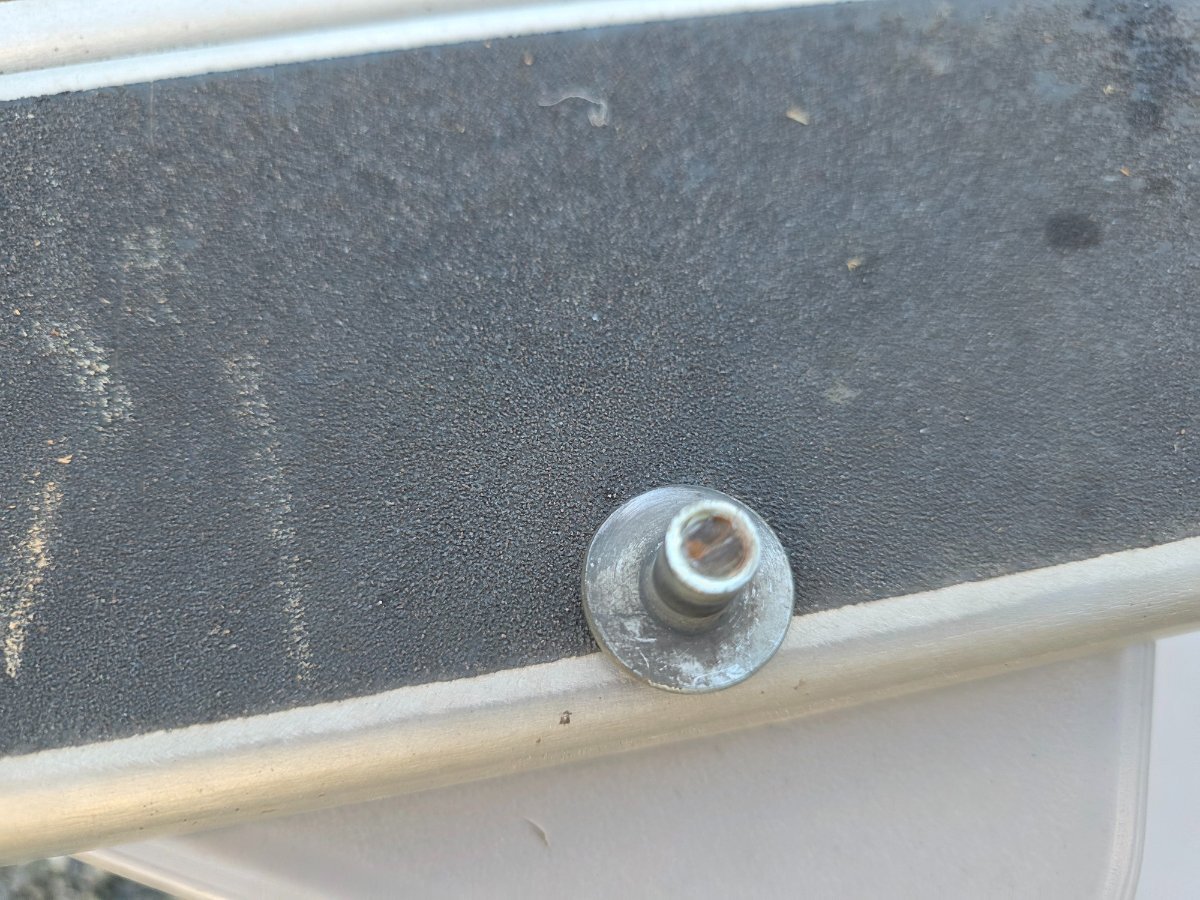

Has anyone had to replace the mount bolts for the entry steps?  Found this problem after arrival to campground.  One sheared and half was missing, the other was loose but still useable.  I'll check with Oliver on Monday.   We have a few weeks of downtime starting tomorrow so I'll get to start on my "fix-it" list :)

Thanks, Mike,  I suspect the sheared one came loose some time ago and all those miles we've been racking up caused the shear.  Hopefully no damage to an oncoming vehicle.  I've never checked them...I thought they were riveted on.

I removed ours when I worked a major overhaul on the steps, sanded down the aluminum and scraped the old tread out to replace with 3M new.
Surprising one came lose since ours where in VERY tight. On one side the nut end mushroomed and would not fit into the hole again, so it couldn’t be reused. I just used a standard short bolt same diameter with locknut (not wanting to wait and pay for parts and shipping for such a small item).
