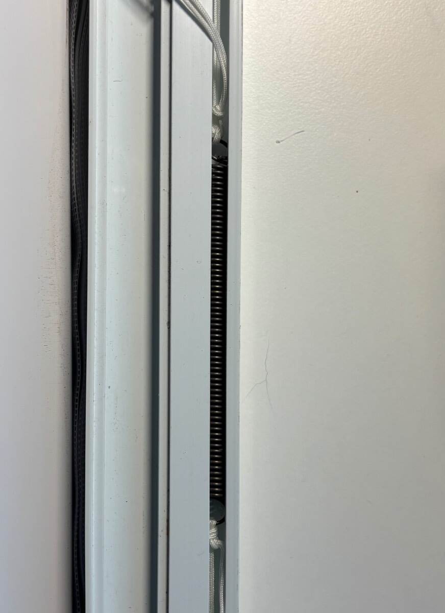

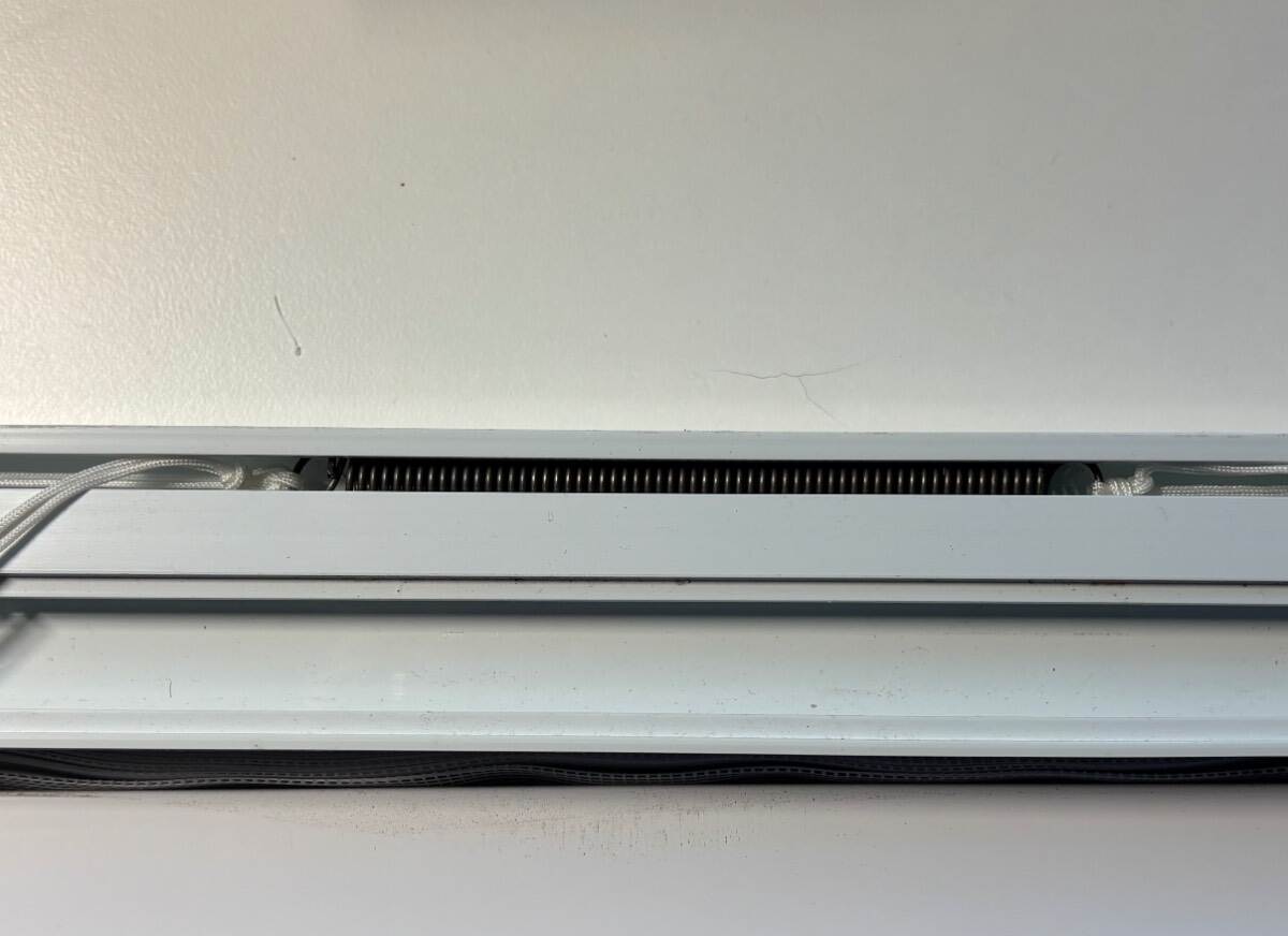

Can I ask those of you that have done this — how did you access and tie the new cord to the spring inside the channel?  Seems very difficult to thread the cord and tie a good knot when it’s tucked in there and under tension from both sides via separate cords.  Am I missing something?  Just trying to plan before I have it apart in 9 pieces.  Thanks!IMG_3764.thumb.jpeg.396b004989ff98c425994e25719d091c.jpeg
Doing the final string tie is the only tricky part.  I looped the string through the end of the spring and pulled it out enough I to tied my know (a couple of half hitches).  Before you start, note the tension in the spring and try to match it with the new string.  If it’s too loose the shade won’t hold its position, if it’s too tight it will be hard to adjust.  I had to adjust both of the ones I did.  One was too tight and one too loose.
