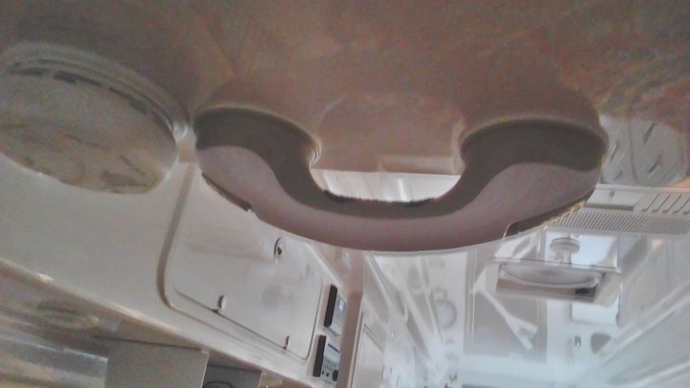

KarenLukens Posted April 4, 2017 Posted April 4, 2017 With the shower rod that you had installed in the bathroom, he will be able to pull himself up and also sit down on his own. Then with the handle outside the bathroom door like we did in this picture, it really gives access to both the trailer door and its bathroom a lot of stability. If he is going to be wanting to do it alone, then another handle on the right side of the closet along with the screen door bar will really make his entry a lot easier. As far as making it to the bed and so on, the suction cup style added in a few places down roof should give him all of the extra hand holds needed once inside. If he does everything that he can on his own, like the ampute I know, then just ask him what else he needs :) This extra handle outside the bathroom door should be standard on all Ollie's, it gets used for everything. Also the bungee ball that you see hanging from it, hooks over the bathroom door handle on the inside to hold the door closed if you need a little more room when turning around in the shower. It keeps the pressure off of the door. Then a few of these below, placed where he wants them on the ceiling, will give him the freedom he wants inside. 2 Happy Camping, Reed & Karen Lukens with Riffles our Miniature Poodle 2017 Oliver Legacy Elite II Standard, Hull #200 / 2017 Silverado High Country 1500 Short Bed 4x4 Past TV - 2012 Mercedes-Benz ML350 4Matic BlueTEC Diesel Click on our avatar pic above to find the videos on our Oliver Legacy Elite II
