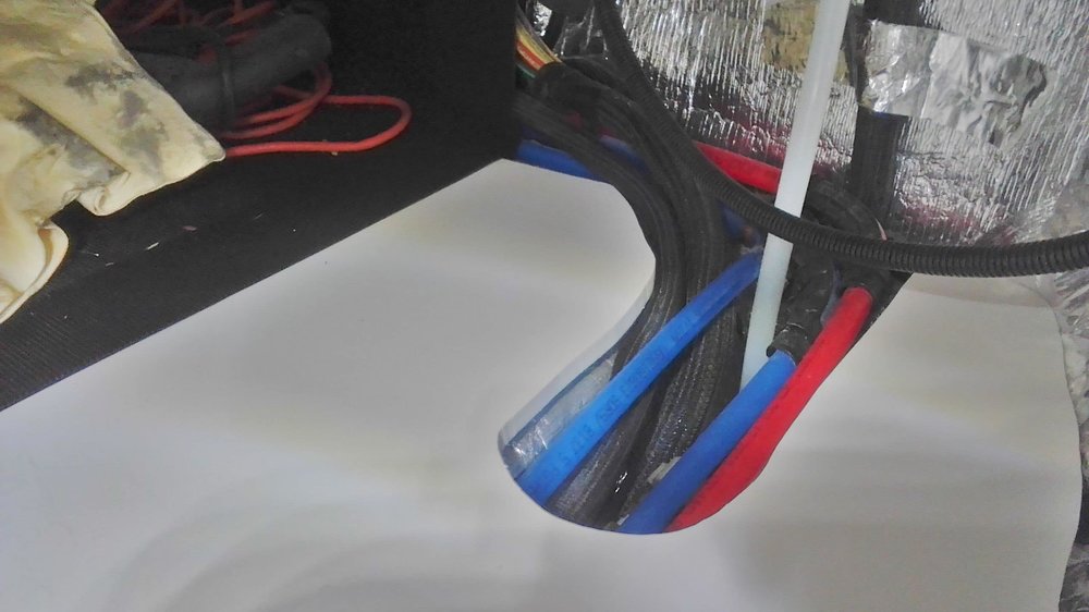

I tried to start an actual siphon to fill the water tank through the fresh water valve tonight and found that the fresh water inlet line does have pressure on it from the check valve not allowing it to work. So I cleaned out the trunk, pulled up the V- mat, and looked at the pipes. There is a hole cut in the floor under the mat but it didn't open up the whole area. The hole worked, but I figured that I would be pulling a door open.
Here it is looking in from the door

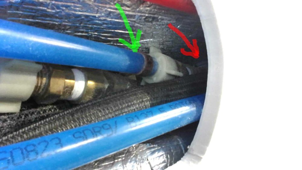

Then here's a view of the check valves and wall connection. Because the hole is so far from the door, the access is limited.
The green and red arrows show the back side of this -

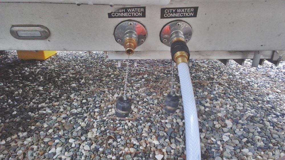

So the red arrow points to the fresh water connection. I still have my siphon hose from the Casita and was hoping to gravity fill the tank with it. But it will still work fine on the back when I am pumping the water in by changing the valves and turning on the fresh water pump.

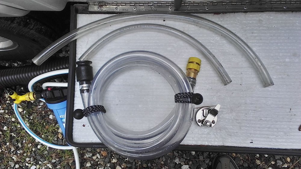

Here's a picture of my 3 hoses that I use for filling from National Forest water spigots or any faucet including my siphon valve and hose. This experiment may have failed but it was a needed step that we all were able to learn from :)
The siphon is a 1" clear poly flow hose with a Simple Siphon Big Gulp.
1" works great for all RV gravity feed systems but the 3/4" or less is all that's needed for the Oliver's waterpump system.
Also, you can see that I have used the quick disconnects throughout my system :)

 Here’s a picture of my 3 hoses that I use for filling from National Forest water spigots or any faucet including my siphon valve and hose. This experiment may have failed but it was a needed step that we all were able to learn from ???? IMG_20170418_174200 The siphon is a 1″ clear poly flow hose with a Simple Siphon Big Gulp. 1″ works great for all RV gravity feed systems but the 3/4″ or less is all that’s needed for the Oliver’s waterpump system. Also, you can see that I have used the quick disconnects throughout my system ???? Reed
Thanks for all the pics. I understand the syphon setup. Please explain to me why you have two slightly different lengths of hose. I just brought home six feet of clear 3/4 reinforced hose to make a suction hose for filling from a bucket. If I attach the other end to my water bandit, shouldn't I be able to use the one hose for non threaded faucets too? I am new at this since I have been tenting for so long.....
I see you like those nifty ball bungees. I have so many lying around.... they really are versatile and you don't get grabbed by a sharp hook.

John, the 2 shorter hoses take the place of the bandit and are much easier to use without. At Yosemite, which is where everyone should try to hit this Spring, the faucets are about 30" off of the ground. The smaller pieces are 3/4" also and were left the over from another project. Together they were too long so the shorter piece slips up over the faucet and the end hangs down into my 8gallon wheeled tank at Yosemite and other parks with low faucets. Then some state parks here like Indian Grinding Rocks, which we go to after leaving Yosemite, have the faucets about 4ft off the ground so the longer works on those. I want just enough hose to hang into the tank, so both of my scraps have a use. You could just use your 6ft piece for the same thing. The bandit is weak walled and really needs to be hose clamped to any faucet or it will just blow off under very little pressure, where your 3/4" hose will fit tight over any faucet as is and you can max out the faucet without the fear of getting totally soaked like you will with the bandit.
I also have a bandit but I've only used it once and that was on a faucet with stripped threads on an adapter. All that you can use the bandit for is filling your tank slowly, you can't just hook it up to the city side thinking that it will hold while parked. Karen bought it this year just to have and I tried it once, but the hose works a lot better and will hold more pressure. You can use 1/2" PVC nipples to adapt your 3/4" hose to standard water hose like I did with the 3/4" x 2" nipple used on my 1" hose with the male hose adapter. But you will need a 1/2" by 2" threaded nipple or or a slip fitting adapter if they have one. I just walked into True Value and got everything there.

Then, you're going to want to cut your 6ft piece off at the ground below the Oliver so that your siphon hose will be as short as possible. So you will have some scrap also :)
Yep, I love the bungee balls, I have 2 on each hose when in storage and 2 on the electrical cords also, then 2 more on the slinky.
One of the best inventions ever :)
