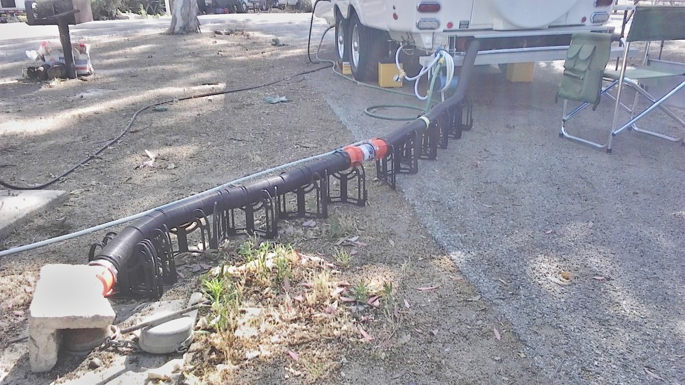

Reed, I didn't buy the front generator port, for a variety of reasons. I plug into the standard side port, where it is more likely to get damaged, by a person or maybe a curious bear. For a front connection, the stubby is undoubtedly the best solution.
It's still hard to water proof that type but in the dryer states that is a non-issue, unless you wash your rig with it plugged in or something.... I get nervous about AC connections and water. The factory marine connector is pretty darned watertight, when the ring is screwed down.

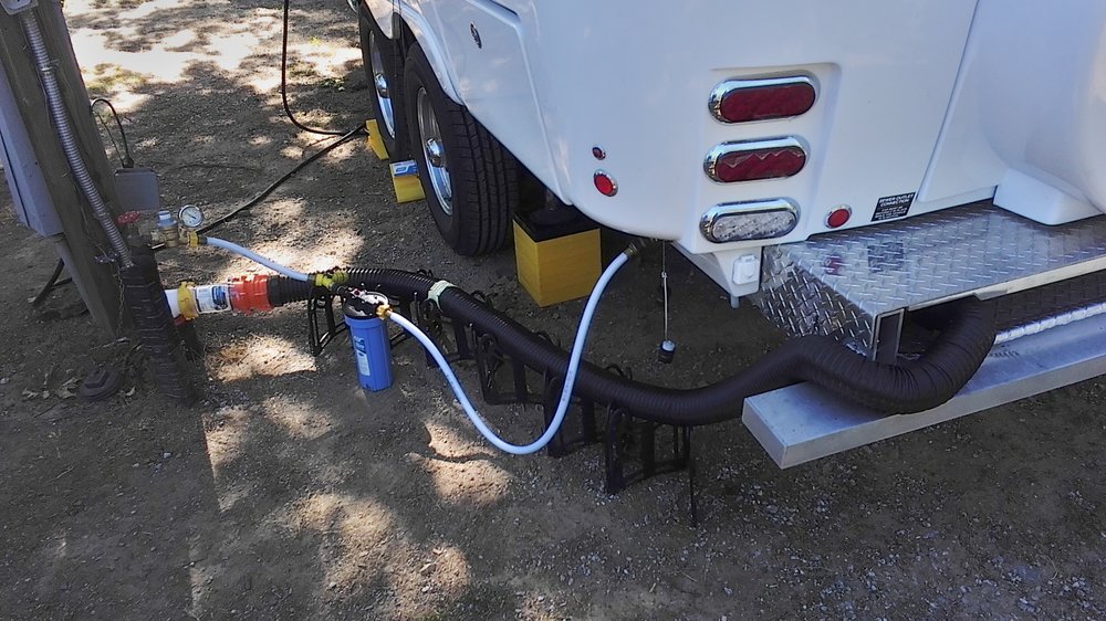

I like your neat and tidy setups. They photograph well and show pride of ownership. But other than the genny cable, they are tripping hazards... I prefer my stuff coiled and laid on the ground under the trailer, as much as possible. Or up and out of the way:
But I don't have a Stinky Slinky to worry about. That makes a huge difference.
BTW, the lay-flat grey hose we discussed in another thread is a mixed success. It will work fine for boondocking but is way, way too slow to drain for any kind of public dump. But it does lay close to the ground and out of the way, a minor positive....
BTW, the lay-flat grey hose we discussed in another thread is a mixed success. It will work fine for boondocking but is way, way too slow to drain for any kind of public dump. But it does lay close to the ground and out of the way, a minor positive…. John Davies Spokane WA
I never thought about using the lay flat at a public dump. It's only 1" isn't it? If you still have the standard 3" connect, for those times 15' of either 3" lay flat or Rhinoflex would be fast. I'm using the 1" right now in the woods and love it :)

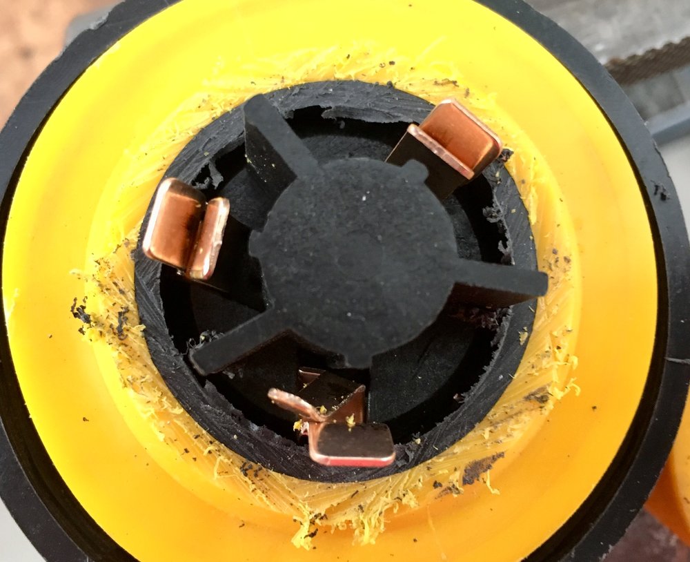

Resurrecting an old thread. My adapter failed - it did not get hot or discolored, it just failed to carry power - and I cut it open to see why.
Here are the sockets:
The metal is dead soft and thin, I can easily bend it around with just my fingers. That is bad. I am through with the no-name ones. It was not cheap at $25: .... https://www.amazon.com/gp/product/B00FYDAP6M/ref=oh_aui_search_detailpage?ie=UTF8&psc=1

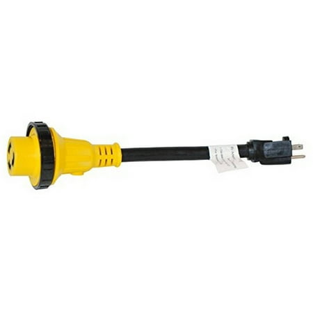

I found these two:
https://www.amazon.com/dp/B001VSY6H8/?coliid=I38W9QOK4KU0LC&colid=1X5H11EH41351&psc=0&ref_=lv_ov_lig_dp_it
https://www.amazon.com/dp/B000NHZV54/?coliid=I26L1KFDICXXVR&colid=1X5H11EH41351&psc=0&ref_=lv_ov_lig_dp_it
They appear to be similar in quality, the first one has a one year warranty, but I have never heard of Conntek. Is this a reputable company?
Marinco is the Real Deal and has a five year warranty. I have used their stuff in the past on a boat and was not disappointed. I know it would be great, it is just $10 more.
Comments?
Thank you.
Marinco has always been my go to choice. I have a cord I made up over 10 years ago with Marinco adaptors and it’s been going strong since the first.
