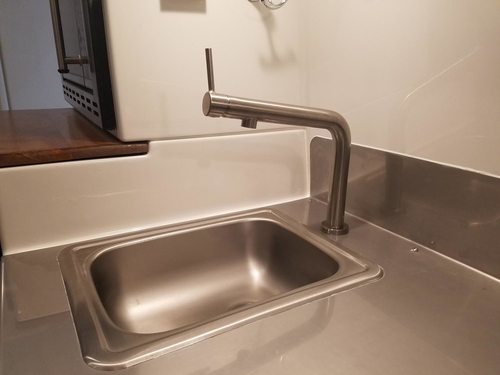

Raspy Posted May 10, 2017 Posted May 10, 2017 Just installed this nice faucet we found at IKEA. Easy to reach handle (right in front and on top) and it splashes less on the counter. 3 John "I only exaggerate enough to compensate for being taken with a grain of salt." LE2 #92 (sold), Black Series HQ19

Raspy Posted May 10, 2017 Author Posted May 10, 2017 Is that the stainless steel counter top I read about somewhere? Very nice, indeed. And the faucet, yeah, that too. Yes, that's the stainless steel counter top I made a few weeks ago. There are pix of it in an earlier thread. John "I only exaggerate enough to compensate for being taken with a grain of salt." LE2 #92 (sold), Black Series HQ19
Hikegsm Posted May 11, 2017 Posted May 11, 2017 Nice faucet! I am considering changing our faucet too. The one the factory is installing now is too big for the sink. The one you chose looks like a bettter fit. Was it an easy change out? Yvonne & Doug 2017 Legacy Elite II, twin bed Hull #223 2017 Ford F-250 Lariat, crew cab
Overland Posted May 11, 2017 Posted May 11, 2017 Is that the Bosjön? If so, we have that same faucet saved on our Ikea list, though we're leaning toward the Ringskär instead. I like that it has a pull out, but a much smaller and maneuverable one than what comes standard with the Ollie. My only concern is that it might be too tall. I love the design of both faucets, though I haven't a clue what the reliability might be - they seem well built enough. We asked Oliver about fitting this sink also, but it won't fit. I haven't heard which dimension is too big but I think it's the plumbing for the double basin that interferes with the drawers - just a guess, but from the dimensions I took it should have worked. Not a big loss - we might get the smaller one instead, even though it's not all that different from the standard bowl - only because we like all of the accessories that Ikea has to fit.
Raspy Posted May 11, 2017 Author Posted May 11, 2017 Nice faucet! I am considering changing our faucet too. The one the factory is installing now is too big for the sink. The one you chose looks like a bettter fit. Was it an easy change out? The faucet needs a small modification to the PEX lines under the sink to really fit the best. The BOSJON listed for North America says it has the 1/2" connections but our had 3/8" compression. At the big box store you can easily get a 3/8" compression by 1/2" male adapter and put that in. The stock Ollie connectors are just hand tighten wing nuts. I went a step further just because I wanted to make it as good as I could. I found two valves that are 1/2" crimp PEX by 3/8" compression. I cut Ollie's lines a bit shorter and installed those valves on the hot and cold. Now it fits perfectly and I can isolate it if needed. The faucet also has stops inside that limit how far it swings. That prevents it from banging into the cabinet or the back wall, even though you get a full swing. It is way more convenient than the stock one I took out and Liye really likes it! John "I only exaggerate enough to compensate for being taken with a grain of salt." LE2 #92 (sold), Black Series HQ19
Raspy Posted May 11, 2017 Author Posted May 11, 2017 Is that the Bosjön? If so, we have that same faucet saved on our Ikea list, though we’re leaning toward the Ringskär instead. I like that it has a pull out, but a much smaller and maneuverable one than what comes standard with the Ollie. My only concern is that it might be too tall. I love the design of both faucets, though I haven’t a clue what the reliability might be – they seem well built enough. We asked Oliver about fitting this sink also, but it won’t fit. I haven’t heard which dimension is too big but I think it’s the plumbing for the double basin that interferes with the drawers – just a guess, but from the dimensions I took it should have worked. Not a big loss – we might get the smaller one instead, even though it’s not all that different from the standard bowl – only because we like all of the accessories that Ikea has to fit. Yes, it's the BOSJON. We have other IKEA faucets in the house and they seem to be very well built. You might look under the sink before you install a pull out model. The pull-out models always have a weight attached to the extra long hose to retract it. There isn't much room under there and that weight will be flailing around as you drive hammering on other things or getting tangled. See what you think when you take a look. John "I only exaggerate enough to compensate for being taken with a grain of salt." LE2 #92 (sold), Black Series HQ19
