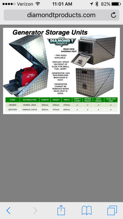

Hikegsm Posted May 14, 2017 Share Posted May 14, 2017 Anybody found a good box to store a honda 2000 in that will fit in the basket and allow the genertor to run in it? Yvonne & Doug 2017 Legacy Elite II, twin bed Hull #223 2017 Ford F-250 Lariat, crew cab Link to comment Share on other sites More sharing options...
Hikegsm Posted May 14, 2017 Author Share Posted May 14, 2017 This one looks interesting Yvonne & Doug 2017 Legacy Elite II, twin bed Hull #223 2017 Ford F-250 Lariat, crew cab Link to comment Share on other sites More sharing options...
geokeg Posted May 14, 2017 Share Posted May 14, 2017 That looks interesting and good for storage/transport. I have a honda 2000 and the companion 2000 to parallel when needed. I don't have the manual handy but I seem to remember a fair amount of clearance is needed around the generator for cooling. I would suggest looking at the cooling requirement of your generator before putting it into an enclosure for operation. George 1 George and Gretchen Gig Harbor, Wa. Hull Number 178 Link to comment Share on other sites More sharing options...
Overland Posted May 15, 2017 Share Posted May 15, 2017 Does the generator not transfer vibration and noise to the trailer if you run it while sitting in the basket? I think that I'd want to keep the ability to move it to the ground while running. Link to comment Share on other sites More sharing options...
Hikegsm Posted May 15, 2017 Author Share Posted May 15, 2017 Does the generator not transfer vibration and noise to the trailer if you run it while sitting in the basket? I think that I’d want to keep the ability to move it to the ground while running. We have not tired one yet on the Oliver. Our bigfoot had a 2800 Onan generator that was permanately mounted to the bottom of the trailer frame. It did not cause much vibration. Ideally ,I would like a light weight aluminum or fiberglass shroud that would mate with the Oluver basket and lock in place for storage/transport. I could remove the top completely for running the generator. We got the basket because we dont want to lift the generator. We arent as young as we use to be???? Yvonne & Doug 2017 Legacy Elite II, twin bed Hull #223 2017 Ford F-250 Lariat, crew cab Link to comment Share on other sites More sharing options...
