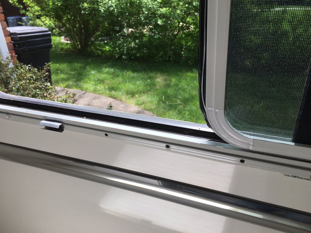

I found a small cut off screw on one of the bunks.  Then found another.... and another....and... you get the picture.   Took off the window shade and found that several screws have come loose from the window frame.  They look like they were sheared off.  I tried replacing them but they won't screw back in.
I will ask Jason about this when we speak and share anything I learn.  It might be worth pulling your window shades to make sure you don't have a screw loose.
If anyone has solved this little dilemma, please let us know.

I had a couple of these.  It looks like the manufacturer over tightened them.  Let us know what Jason says.  Mike
Hi Mike,
You called it.  Jason said that this was probably due to over tightening.    He is sending me some replacement screws to replace them with.
Will let you all know when I get that done.
Scotty

Hi Mike, You called it. Jason said that this was probably due to over tightening. He is sending me some replacement screws to replace them with. Will let you all know when I get that done. Scotty
The issue may be getting the piece of the screw that didn't come out.  Mine broke right at the head of the screw.  I'll ask if he can send me a few.  I don't like being a loose screw.  Mike
Interesting that the hull numbers are so close, as this would be an Oliver install item, I wonder if they maybe had a new hard charging enthusiastic employee installing them, hopefully they slowed him down a little since then.
Seems anyone around those hull numbers might benefit a closer inspection, if concerned.
