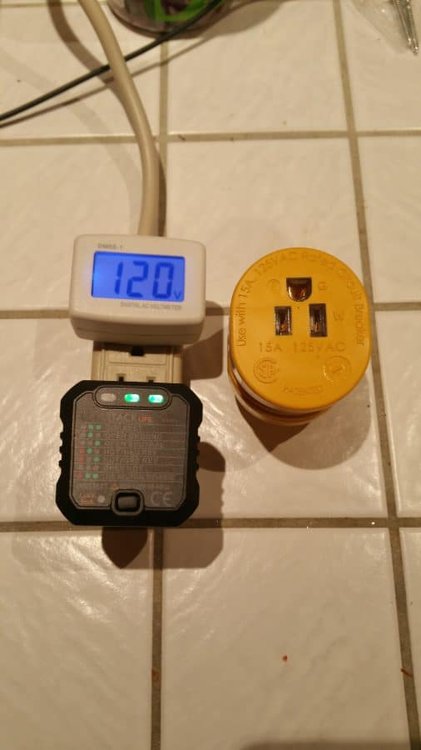

Mainiac Posted September 4, 2017 Author Share Posted September 4, 2017 Hi, Basic thing I would have is a 30/15 adapter. If you have RVing for 20 years you probably have a couple. It is usually a little black rubber plug that looks like the end of you RV plug on one end and you can plug an extension cord in the other end. Into to that I plug in a a tester. This little tester is usually yellow (sometimes black) and usually has three little lights. Two green and a yellow. I also get the one with a little push button on top. That button lets you test GFIs. I like them because if I am camping and loose power, I can plug into the pedestal to see if I have power. If I do, then I can go inside and test the GFI. That tester is usually under $5 and available at Lowe's or Home Depot type stores. At Harbor Freight you can usually pick up a small meter for about $6, and sometimes free with a coupon. Nice thing is you can test flashlight batteries with it. It also comes with a small instruction manual. But you can also get hurt with one, so be careful. Bet auto supply places like O'Reilly, Napa, and such have basic auto (12V) electrical books. You might want to stay away from 120 V for now. I have a Progressive stand alone system that I plug in first. It tells me if it is ok to plug in the trailer. Some can be pricey, but they watch your power supply so you don't have to. And they have a lifetime warranty if you should ever need it. But the best electrical advice is to ask another camper. The odds are they know the answer. Be safe out there, and see you around the campfire... 1 Link to comment Share on other sites More sharing options...
