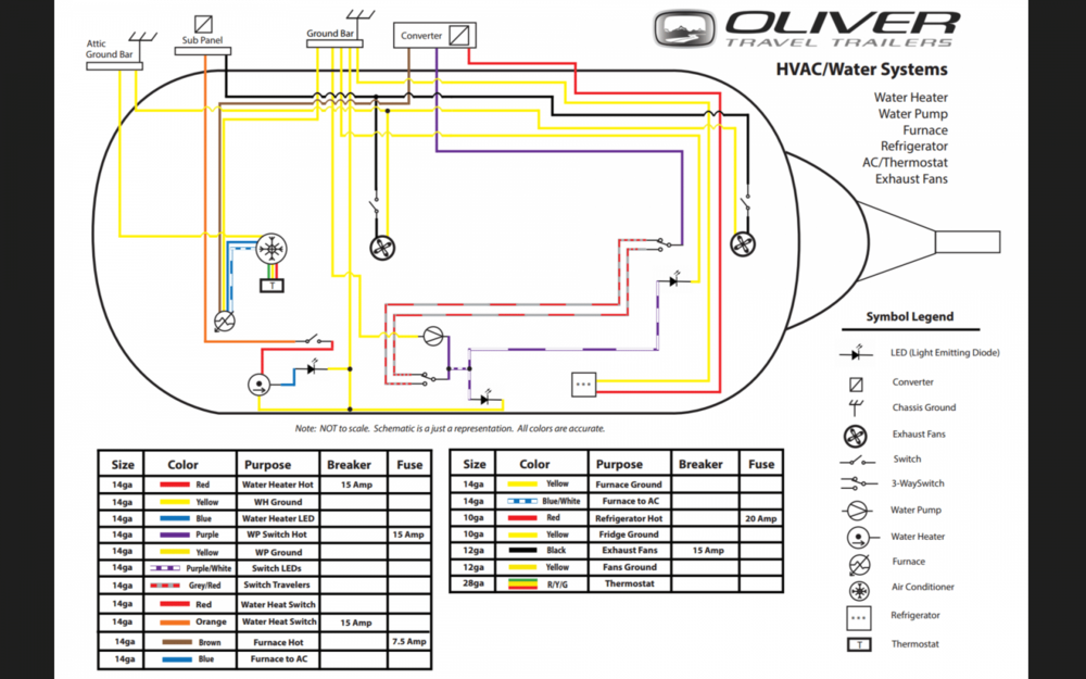

KarenLukens Posted October 7, 2017 Posted October 7, 2017 If you feel like testing it, send me a PM and I will call you. You should have a test light or multimeter but if you feel like working on it, I just got home :) Skip up to around 16 or to 17 minutes in this video and look at the valve positions. Then check both wires on the sides of the pump. Then here's a couple pics out of the owners manual. Reed 2 Happy Camping, Reed & Karen Lukens with Riffles our Miniature Poodle 2017 Oliver Legacy Elite II Standard, Hull #200 / 2017 Silverado High Country 1500 Short Bed 4x4 Past TV - 2012 Mercedes-Benz ML350 4Matic BlueTEC Diesel Click on our avatar pic above to find the videos on our Oliver Legacy Elite II
Raspy Posted October 8, 2017 Posted October 8, 2017 Just in case you have the valves in the wrong position, or for some reason the pump is pressured up and working against a closed valve, try simply loosening the outlet connection on the pump to see if it pumps. This union/hand nut can be seen in the photo Reed posted and is where the hose connects to the output side of the pump. With the pump switch turned "on" and the water outlet loose, the pump will run unless it's defective or has no power. If it runs, find the valve closed problem. If it doesn't run, look for a power problem after the wall switch, like a bad connection. 1 John "I only exaggerate enough to compensate for being taken with a grain of salt." LE2 #92 (sold), Black Series HQ19
