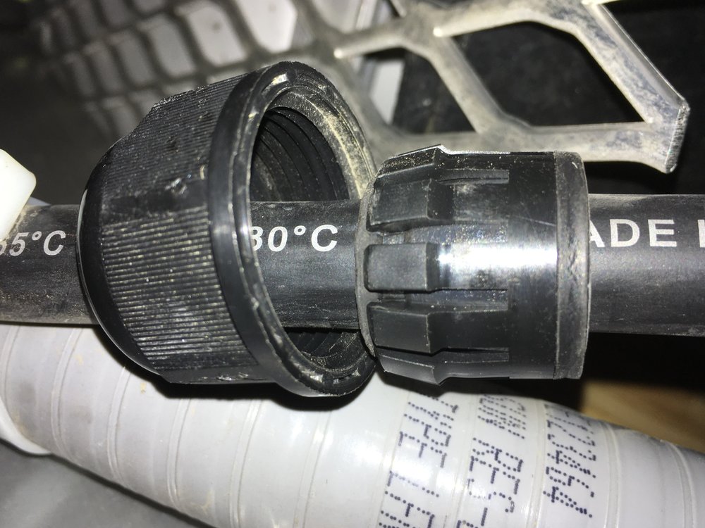

Is it possible to just pull out some extra cable from inside the trailer after loosening the compression fitting on the hull? Is there extra slack under the vanity?
I only need three or four inches. (I am extending my Anderson hitch with a"rack" with a longer shank.)

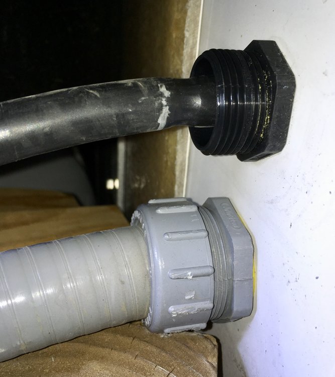

On mine, hull #92 from mid 2015, the cord, or wires, to be more precise, pass through a marine style through hull fitting with no actual seal from the elements.  It's even already stripped of it's jacket before going through!  There is a loop that could be straightened out and provide about six more inches if needed.  Maybe that's because of the extendable tongue.

Well, I am bummed. I loosened the bulkhead fitting and tried to pull a little extra cable through it. There must be a second compression nut on the inside of the hull that is holding the cable, because the cable only moves less than 1/8 inch....

Wow, they really improved that since mine, my exterior cables are in regular split automotive wire wrap and the hole they pass through the shell is just filled with that orange foam stuff. Compression fittings would be nice.

Yeah, that is a nice looking compression fitting.  What is that liquitite conduit for?  Maybe jack wiring and breakaway switch?
John
Yep. All the wiring other than the 7 pin trailer main harness.
