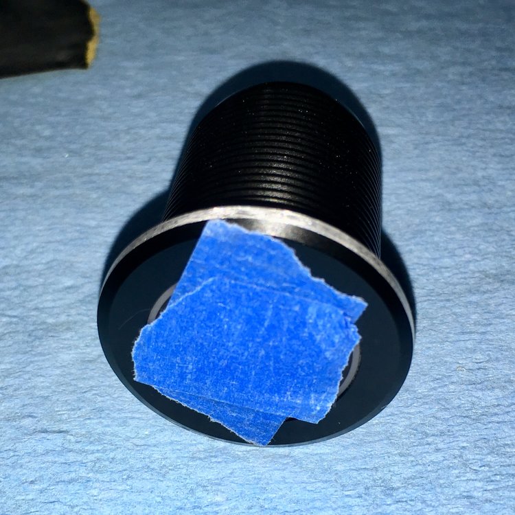

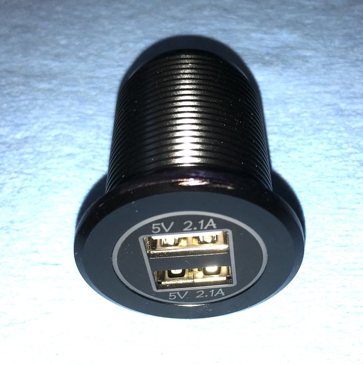

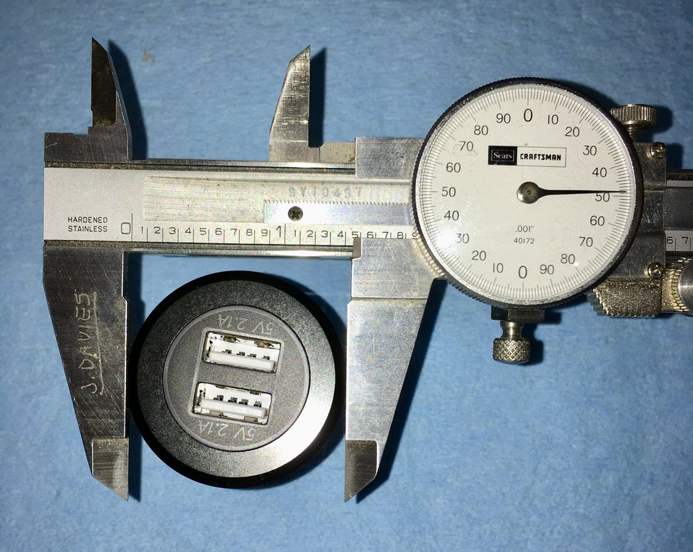

The bezel is smaller than the diameter of the charger. Mask off the openings to keep out debris! Carefully reduce the diameter of the lip to closely match the bezel, so it will slide inside snugly. I used a belt sander with a fine grit belt, followed up by 220 grit hand sanding. MAKE SURE the unit functions properly before grinding, you might not be able to return one that you have altered! Also double check function just before installing.
I “painted” the raw aluminum with a black Sharpie.

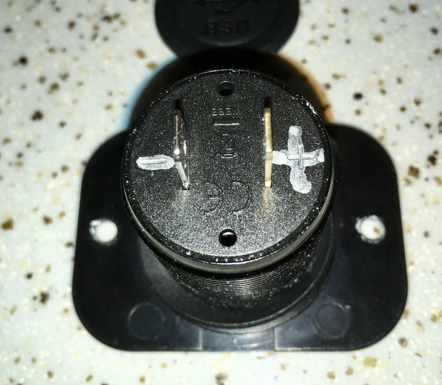

Inserted into the bezel, and marked the + and - terminals with a silver pen so I could actually see them.

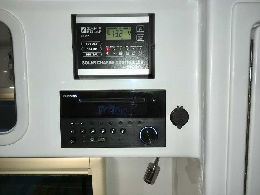

and installed it into the hole where the factory unit used to be:
Note how very thick that cabinet bottom is, I wanted to mount one more on the street side, but there was no way it would easily work through that much thickness. I pulled the stereo and drilled a hole next to the faceplate, picking up power and ground from the radio wires. I used an inline fuse holder plus a 10 amp fuse.
My wife can lay her devices on top of the galley counter, or underneath to get them out of the way for food prep.
These new chargers will charge my iPhone way faster than the old one. And no more glowing light in the eyes at night.... Neat mod, highly recommended!

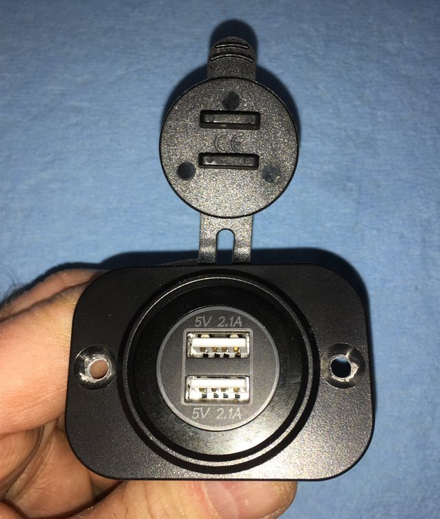

You will find lots of round plug-in chargers that have one 2.1a and one 1a port Each port will be labeled differently, which can be frustrating if you charge your phone from the “slow” port by accident. The letters are often hard to read.
The dual 2.1a models are much less common. I think it has to do with their ability to shed waste heat during operation. These aluminum ones are designed to handle the heat better than the plastic ones. Plus they cost more to manufacture. With a dual port model you just stick the cord in either port, you don’t have to fuss around with seeing which one is faster.... or wondering why your iPad battery keeps going down while you are using it.
