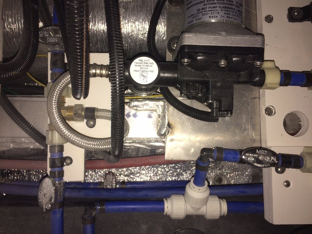

@raspy, how do you "take it apart", the pump, to see what is in there?. Intermittently the pump runs so I do think the problem is in the check valve. If it is, it isn't just a mechanical issue requiring maintenance. It could have been prevented in construction and thus validates my earlier comment voicing my frustration with a new $60,000 RV. But nothing is perfect. I just need to learn. If I cannot fix it myself, or it flushes out by itself, then Oliver will need to send me a new pump. I was in the construction business all my working life. In all those years I never had a "punch list" because I personally made sure everything was done right before exiting the job. The person responsible for this job at Oliver is obviously not doing it well. Unfortunately, based on the problems presented in this forum, that is a fact. There should be absolutely NO pieces of plastic or fiberglass in our water lines. Ludicrous to think otherwise.

If the problem turns out to be a check valve that doesn’t seal properly l can guess why. I constantly find plastic pieces (such as you would see from drilling) in the suction filter screen at the pump and in my anti bug screen covering the fresh tank drain under the trailer. This could be your debris source. You’ll just need to flush everything out well.
Thanks, but how do you flush everything out well?

You'll have to look at the pump and figure out how to take it apart yourself.  If you are not comfortable with that, call Oliver and ask them what to do.  As I remember, it's a simple matter to remove the pump head and take it apart.  Do it carefully and look for a piece of debris or a damaged part.  It's good to know how to do it anyway in case you have a problem while out camping.

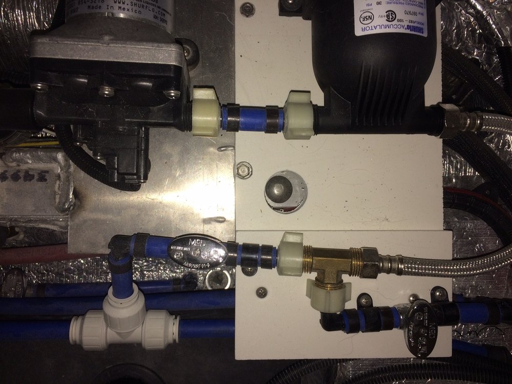

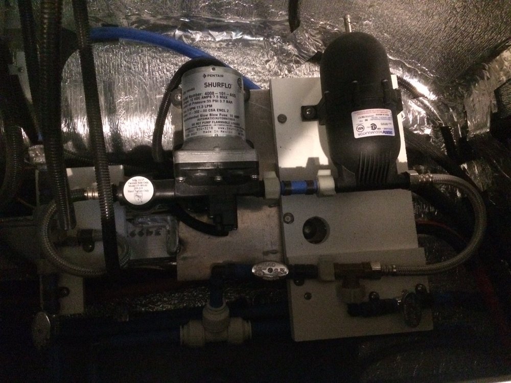

Jason sent me a replacement pump. I decided to perform the job yesterday.  How hard could it be? Videos and tutorials claim it is a thirty minute job. I always take more time when involved in my first mechanical foray. The unknown always provides a bit more anxiety than I am comfortable with, even when knowing I am capable of performing most repairs when it comes to owning a home.  But this home is on wheels and less than a hundred square feet. Being confined to working within a tight space never thrills me. This job was no exception. But the new pump works, and so far there is no filling of the fresh water tank while hooked to city water connection. However, there were three points I discovered while replacing this pump:
The four nuts and bolts used to fasten the pump to the makeshift metal plate need to be replaced with something like wing nuts so you can actually get to them with your fingers. Tools just don’t work too well with this poor design. Impossible to get the existing washer and nut back on and in one case one nut was lost. It took me another half hour to find a proper nut in the can that holds my spares. A most disagreeable introduction to a poor design.
I was not aware that I would need instead of the typical wire nut tie a crimping style with tool to match. For the time being I installed the pump with the wire nuts I had and ordered from amazon what I need to complete the job properly. The flexible protective sheath of course would not fit over the wires due to what I did and that too will have to be done over.
Replacement pumps cost about $70.  The model Oliver sent me was a SHURFLO 4008-101-A65, 3.0 GPM RV Water Pump Revolution, 12V.  According to Shurflo the exact same pump is also a 4008-101-E65 which is a brand new pump, whereas the A65 actually could be a used and rebuilt aftermarket.
I bled enough for one day due to the sharp metal and less than admirable design. It seems the fabricators were more concerned with the initial installation instead of ease of operation if and when the pump might fail. And while speaking the other day to a man who has been living on a schooner for the last few years he informed me that this will not be the last water pump I replace. He also advised that everyday I will be working on something or other having to do with our new RV. It is the nature of the beast.
