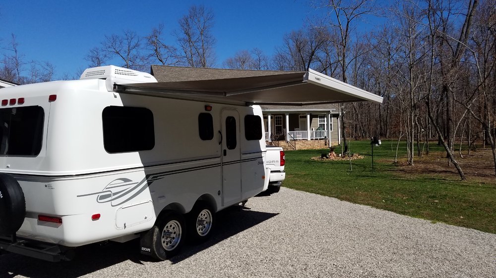

We had a power Dometic awning on our Escape. Im not sure what model Oliver is going to use. It was self supporting and had no support legs. It was easy to operate by just pushing a button on the remote control to open and close. It did not use much power to open and close. It seemed kind of delicate and there were some people that had problems with them, we did not. They were not able to be tilted to shead off rain and had to be retracted most of the way in the rain. Some overloaded with water and damaged the arms during heavy rain. They were suppose to have a dump feature but it did not seem to work very good. They don't handle wind as good as one with supports but none of them really do as we saw at the rally this year. Escape has announced they are discontinuing the power awning on the 2019 models and I am not sure why. Overall I was not a fan of it and only had it out if I was sitting under it.  I like our Carefree better but also do not leave it out if we are not in the campground.

Agree with kounteykamper. We've had power awnings on all the motorhomes we deliver. Not as easy to adjust. Mandatory to pull it in with any breezy or gusty conditions.  Given the choice, I'd stay with a manual awning. Easy to deploy. Still problematic in even moderate wind, but less so than the power awnings we've used.

Excellent feedback, and great help with pictures of the Escape power awning. You guys have real-life experience with awnings, so your opinion is quite valuable. I have heard wind is the enemy of awnings, manual or power. One YouTube video actually used the wind threat as a reason to go power (can retract power awning quicker than the manual version when a storm sneaks up). Being from Florida, quick and easy shade is a big deal! Tired of being hot and humid - each summer seems to get harder (or, possibly I am getting older and less able to handle the heat). Will be so nice to hookup to the Oliver (pickup April2019) and go to regions of cooler temps and less humidity (which is everywhere else compared to the Florida panhandle). The Dometic page has a cool looking high-tech power awning - will be interesting to see which model Oliver choses.
