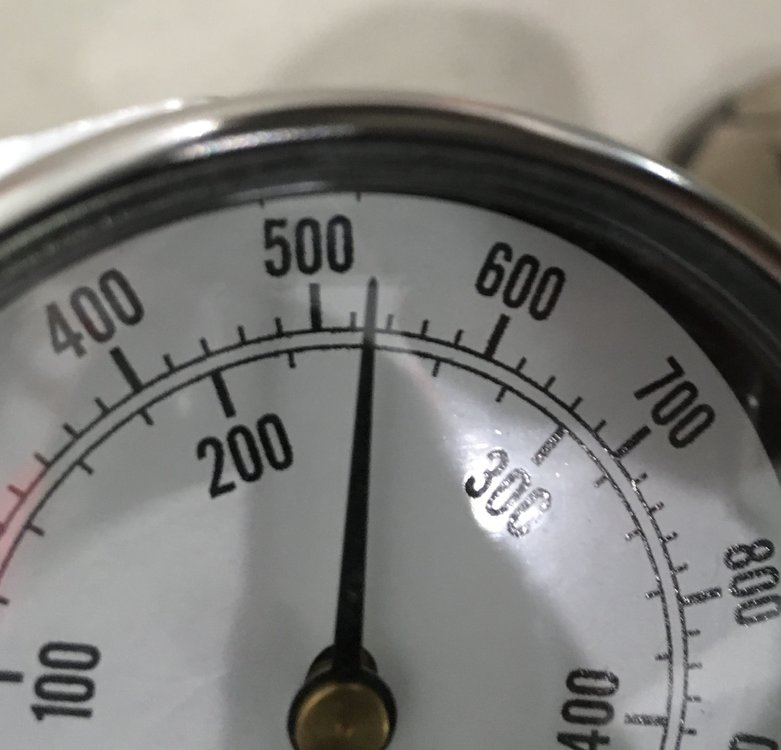

Looking for input. I have the front cargo tray and twin 30 bottles. With full propane the tongue weight is 720 lbs with a full load of gas and water in jerry cans. This is using a Shurline 1000 pound tongue scale. I use an Andersen and 10 or 12 psi in the rear airbags. No worries.
If I build a rear frame mounted cargo rack like the factory units, bolt my Ollie cargo tray to it and carry the full cans back there, the tongue weight should drop significantly. Say the rack weighs 20 pounds, the tray weighs 16 - I would remove 116 from the front and add 136 to the rear.
Can someone tell me how much the ball weight would drop to, maybe 550? Have those of you who carry heavy ebikes or other stuff in back actually weighed your trailers tongues with a scale?
I am trying to figure out what a safe minimum weight would be. If I can drop it significantly I might be able to eliminate the Andersen and pump my bags up to compensate. And use an offroad coupler. My truck is rated at 850 max tongue, dead weight. But it moves around too much the way it is now with the chains disconnected.
Note I haven’t weighed the axles. I think the trailer weight is normally 6000 pounds with no extra fluids up front, so my current tongue weight is about 10%.
I guess I could remove the tray this winter, shift it and the cans to the top of the rear bumper and weigh the tongue to see what happens, but I was hoping for an easy answer.... there is probably a formula involved.

I weighed everything I normally carry (I had no clue my four rubber chocks, ratchet straps and heavy cable lock are 23 pounds!), I measured and poked around online at the metal suppliers. I can make a very sturdy rack similar to the new factory bike rack option, but with my front cargo tray bolted on top in the center. Weight of the structure should be about 50 pounds and the normal load would bring the total to about 155. That is two full gas cans and an empty water can, plus the loose items I mentioned.
For kicks I threw four sandbags that I use to hold down a portable canopy onto the rear bumper top. They weigh about 175. The tongue weight dropped from a measured 580 to 530. If I unbolted the empty front tray in my experiment, it would have been about 510.
While moving the EMPTY tray back there has minimal effect on the tongue load, when you figure in the cargo weight it drops the tongue weight by around 200 pounds. That is pretty major and even if I can’t entirely eliminate my Andersen, it will make the hitch and truck happier, plus I will get more angle when backing. I do worry about smacking the tray into the truck.
Not counting my labor, but paying for some welding, I hope I can get this done by next spring for $300. I am a ittle confused by the quote Oliver gave me for the new Gen3 bike rack delivered..... $950. Something doesn’t seem right for a design with no welding whatsoever.
The Sherline 1000 pound hydraulic scale is really nifty .... combined with a digital one stolen from the bathroom for the small items it tells you a lot. It is not super precise and you have to average several readings, but it is way better than just guessing.
