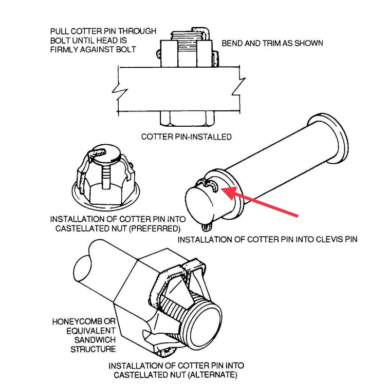

One extra step to do - bend both cotter pin “ears” sharply inwards toward the shaft and then squeeze them tight, so that there are no gaps to hook a wash rag or your skin. Exposed cotter pins are dangerous and can really hurt you if they are wobbly and the sharp bits stick out, as in your picture. They should be installed as tightly as possible.
I think a stout outside retaining (snap) ring would be a better choice here, and it would look much classier. But it is easier and cheaper to drill a hole than to machine a groove. That is a future mod for somebody who has access to a lathe....
