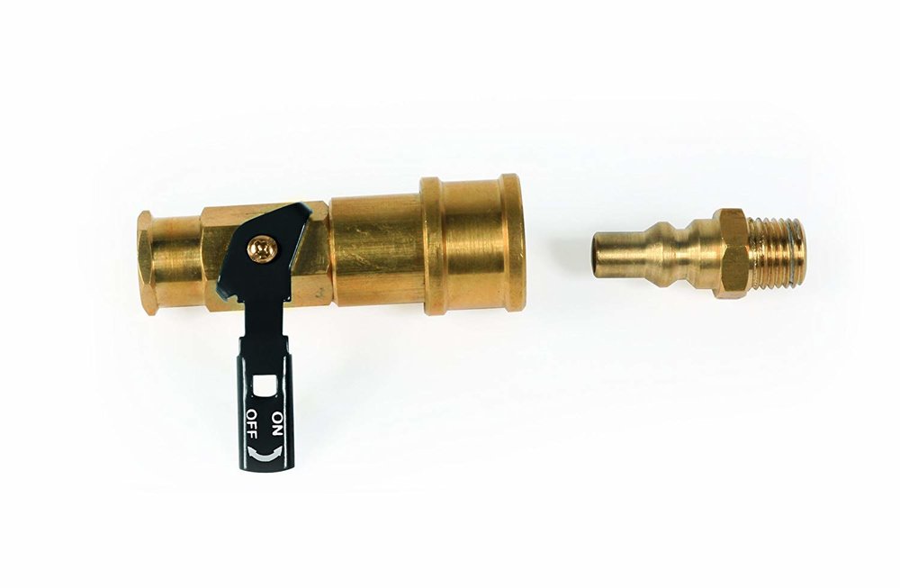

Overland Posted August 4, 2019 Posted August 4, 2019 This is the type of hose that will fit your Ollie, and I guess you’d need this as well. I’d recommend getting more than one hose, to give you some flexibility in setting up your campsite. 1
