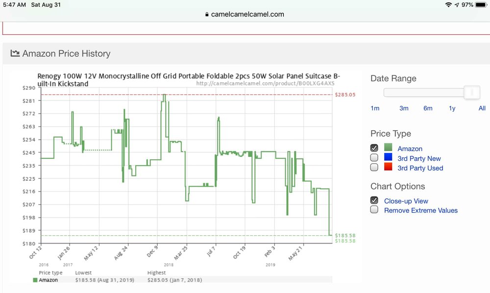

Renogy 100w suitcase panel lowest price ever on Prime
