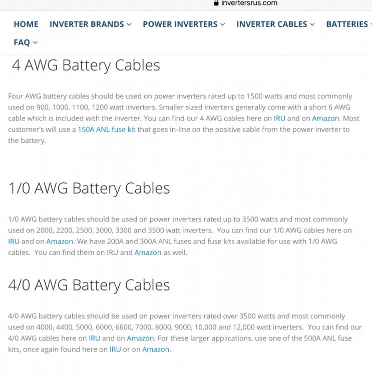

Does anyone know why they use such HUGE cables? My hull #217 has the 2000 watt inverter and 4/0 welding cable as big around as your thumb. Recommended cable size is 1/0, which is good for a 3500 watt unit. My positive cable has a 250 amp fuse. 4/0 cable is rated to carry 1200 amps up to 50 feet 😳

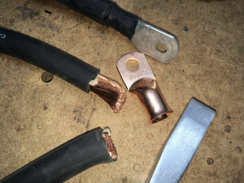

The bigger cable is twice as expensive ($8 per foot wholesale), way heavier and bulkier, awkward to cut, less avaialable and in general a really big PITA to work with. If they intended to upgrade the size in case of installing a larger inverter In the future, 2/0 gauge would be plenty big. Their cost savings would have been about $50 just for the wire, not including the more expensive terminals and the extra labor involved.....Here is what I have been working with- for scale that is a 1/2” cold chisel:
I am pretty perplexed. As an aircraft tech I can’t see a single positive benefit from this choice. But OTH a whole lot of the electrical installation in an Ollie confounds me.....Comments?
